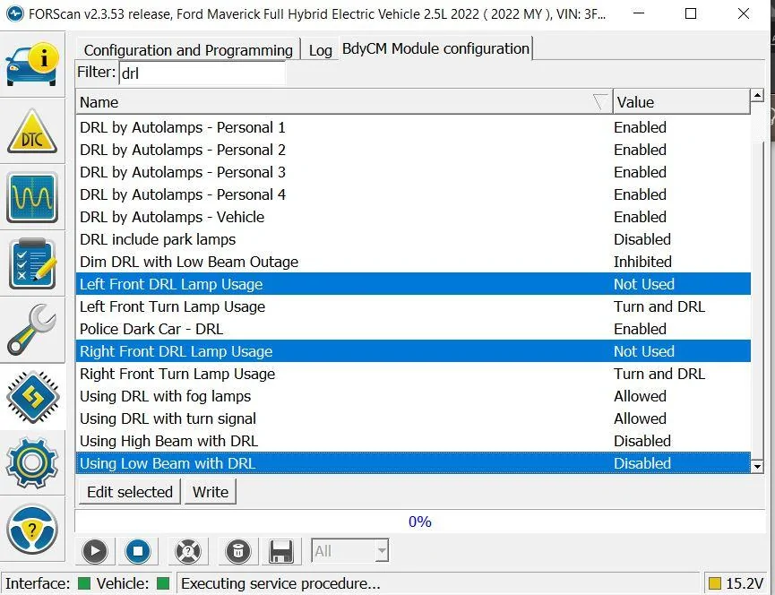

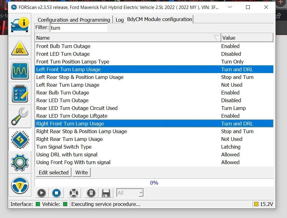

I finally got it to work with some slight modifications. Settings are posted below, can someone validate that they achieve the same results?
Modifications:
  1. Low beam with DRL = Disabled
  2. Left & Right Front Turn Lamp Usage = Turn and DRL
  3. Left & Right Front DRL Usage = Disabled
Results:
  1. Light off mode = No light
  2. Parking lamp mode = parking lamp (dim yellow)
  3. Autolamp mode:
    1. Daytime = Turn signal (bright yellow)
    2. Nighttime = Lowbeam LEDs
  4. Headlight on mode = Lowbeam LEDs and turn signal (bright yellow)
Other Factors:
  1. XL Hybrid
  2. Recent BdyCM module update from service center for grabby-brake issue
    1. I noticed some settings changed changed in effect or options after the update

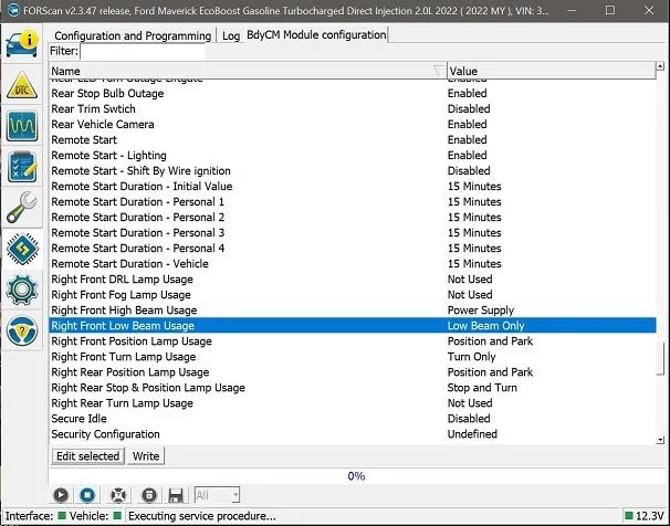

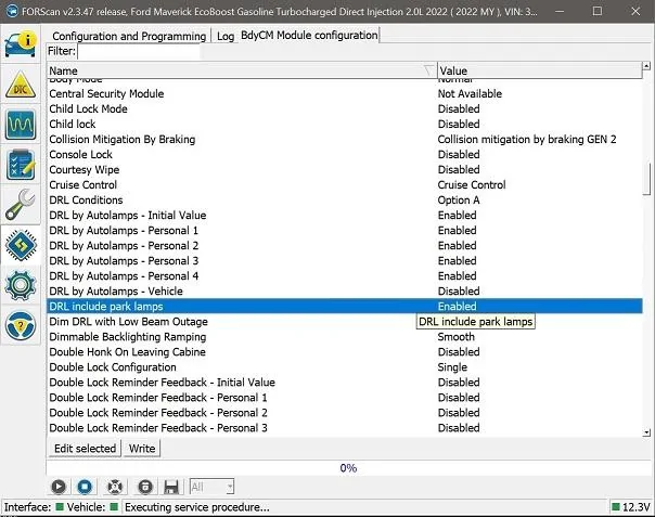

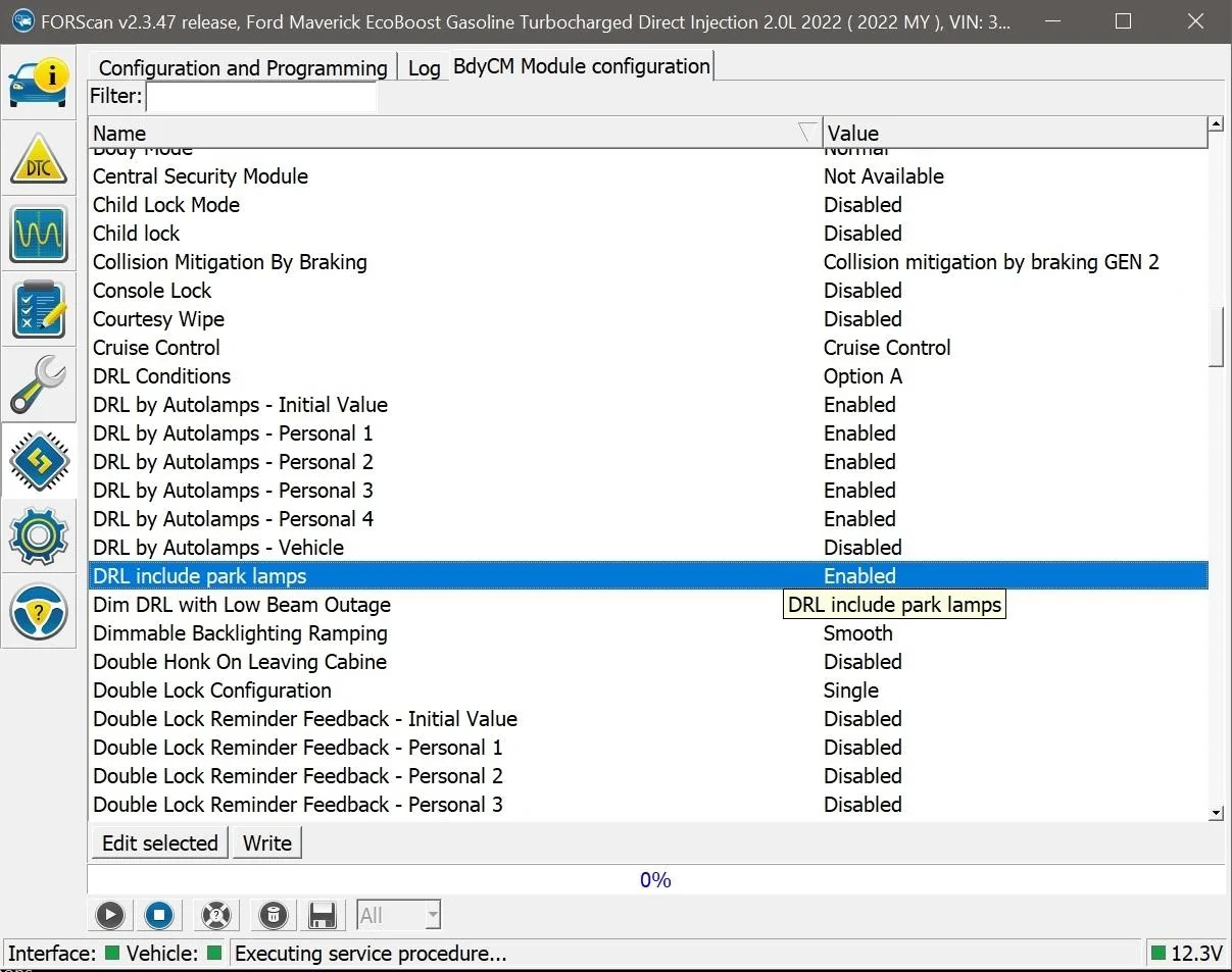

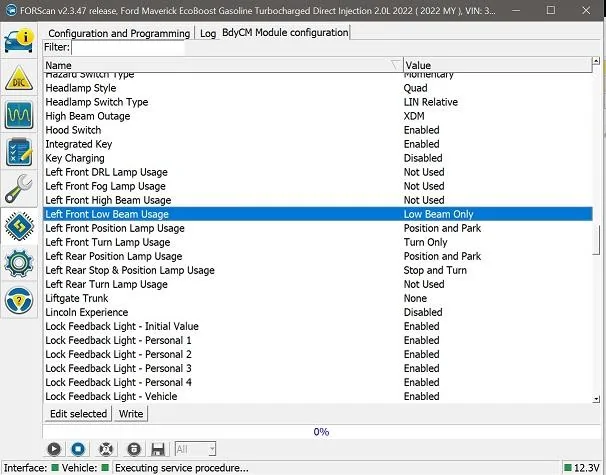

So its my first time with forscan, went in there to get familiar with it.
First I changed 'drl to include park lamps' to enable:
Next scrolled down and modified each low beam to be 'low beam only' instead of 'low beam and DRL' (do this for Left Low Beam as well as Right Low Beam):
Save configuration, and enjoy your lasfit switchbacks plus whatever else you have wired to them :) These come on once you put your vehicle into Drive, they won't be on in Park.
I cannot get the DRLs to remain off on my 24 XLT w/lux and copilot 360 when in Drive. Followed steps exactly but no matter what, when I shift into D the DRLs light up. I hoped to use my Lasfit switchbacks as DRLs and they are on, but so are the DRLs.

Deweyordeweynot - Follow the link in snowcat87's post above yours. As it states, he found the way and It worked for me.
One tweek, I kept my front turn's as turns only. He had them changed to Turn and DRL which makes them come on in amber. I don't know what happens when turning as he didn't include a video.
Keeping them as turn only and using DRL Include Park Lamps will light your front turn switchbacks as white. They alternate white to amber when turning.
The DRL Include Park Lamps also turns on the rear park lights. The signal doesn't separate front to rear so both will be on. I haven't found a way yet to turn them off.

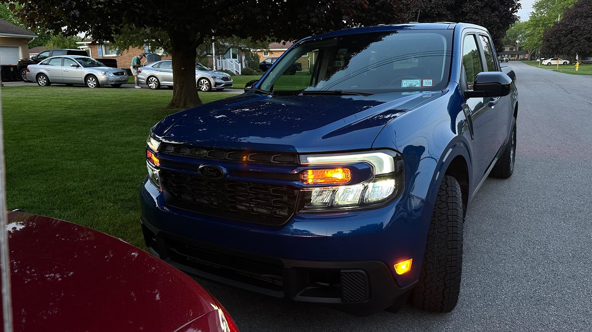

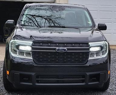

See my write up on this. I did it and made a step by step write up. You need to modify some things in forscan too.
Here is the link to my article, it’s everything you’ll need.
https://www.mavericktruckclub.com/f...lights-tail-lights-on-xl-xlt-mavericks.46264/
Ford Maverick Change XLT parking lights to be the DRL's instead of low beams A0F43085-E9EF-41B1-8A0C-AACBF1B19D95

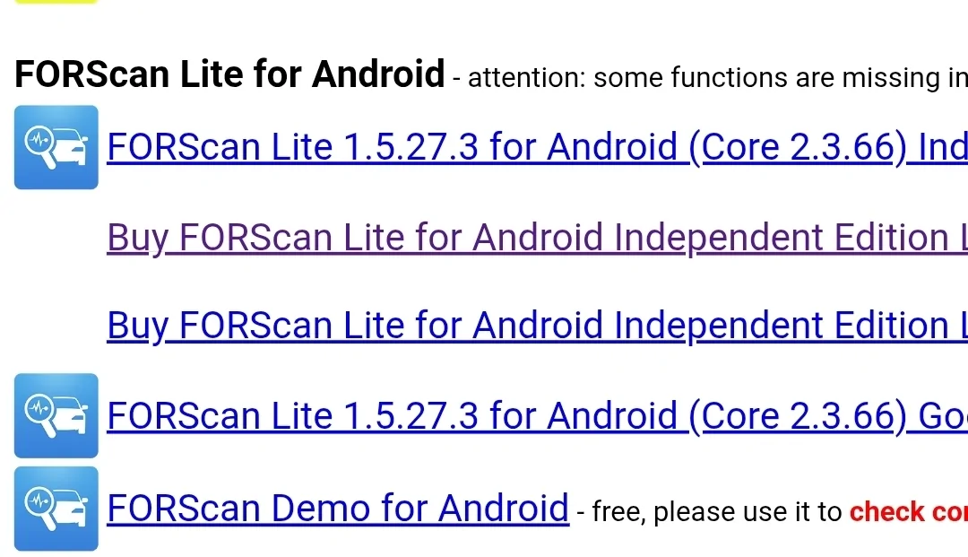

Wich ForScan Lite should I get
To be able to do this mod
Ford Maverick Change XLT parking lights to be the DRL's instead of low beams Screenshot_20251008_173201_Chrom
