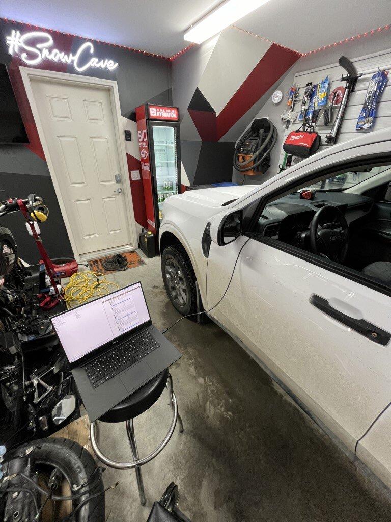

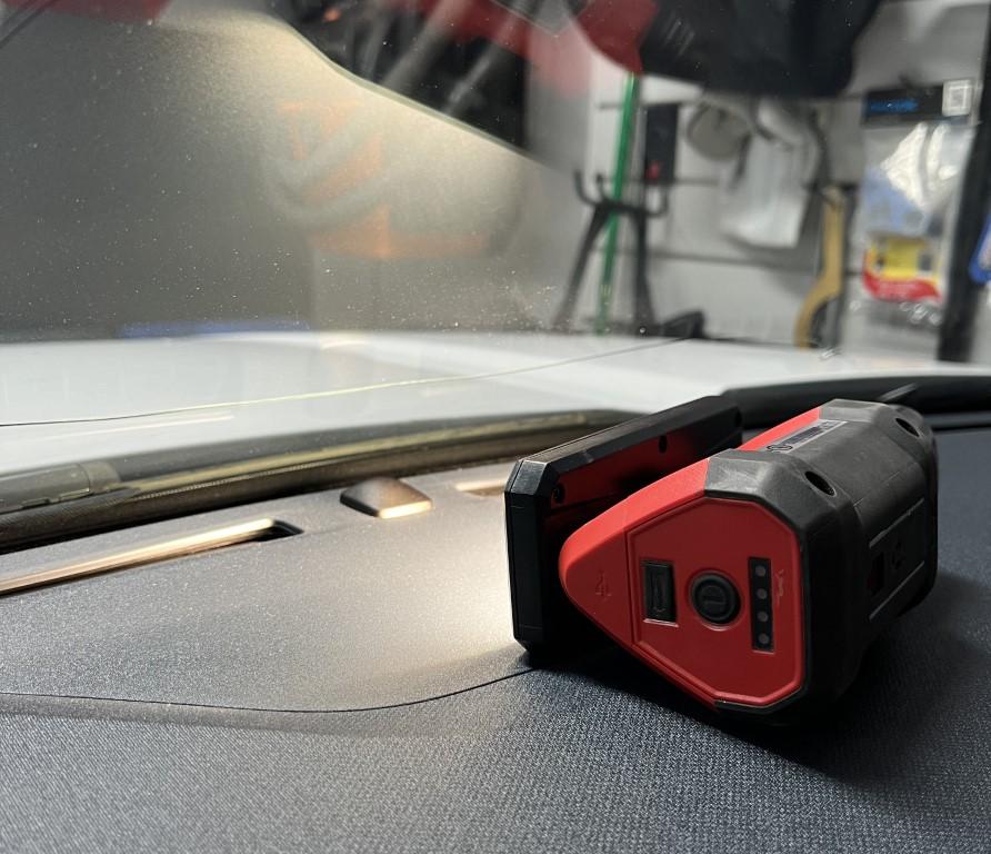

If you want to do this in your garage, the ambient light sensor is the black nub on your dashboard. I used a flashlight to force it into day mode, and then covered with my hands for 10-20 seconds (depends on what you have your mav set to) to make it go to night mode. You can test your results without having to go in and out of your garage or test at nightime etc.

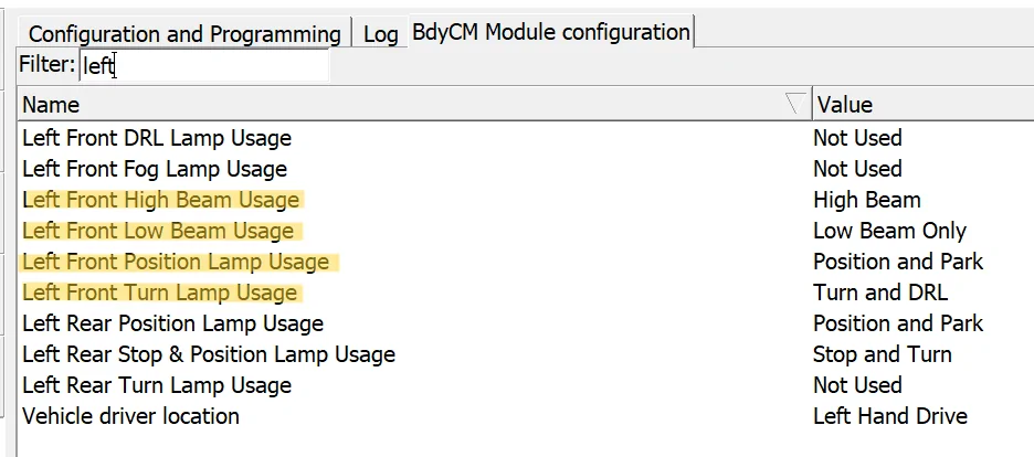

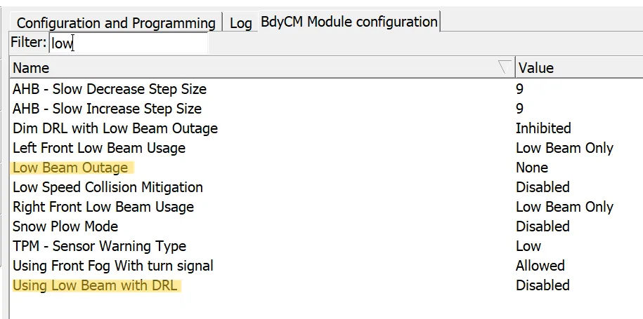

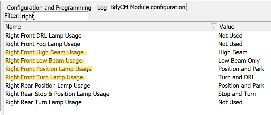

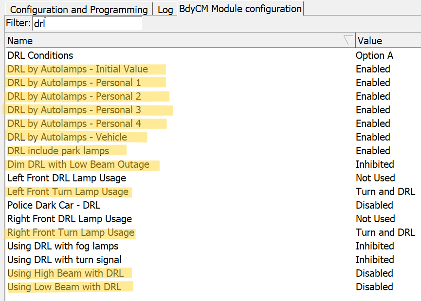

Forscan:
I had a lot of weird anomolies with my truck, causing it do weird things, so go through every setting carefully. What I found to cause mine not to work was the high beam said not used for one side, and "power supply" for the right side? This was really weird. I also had all my "DRL by autolamps" disabled as well.
Below are my settings to get this to finally work, and I checked after a bunch of cycles:
To get signals to be 100% brightness you have to change Left Front Turn Lamp Usage and Right Front Turn Lamp Usage. - Turn and DRL
LEFT
RIGHT
LOW
DRL

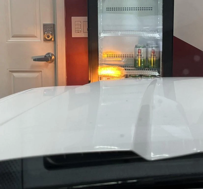

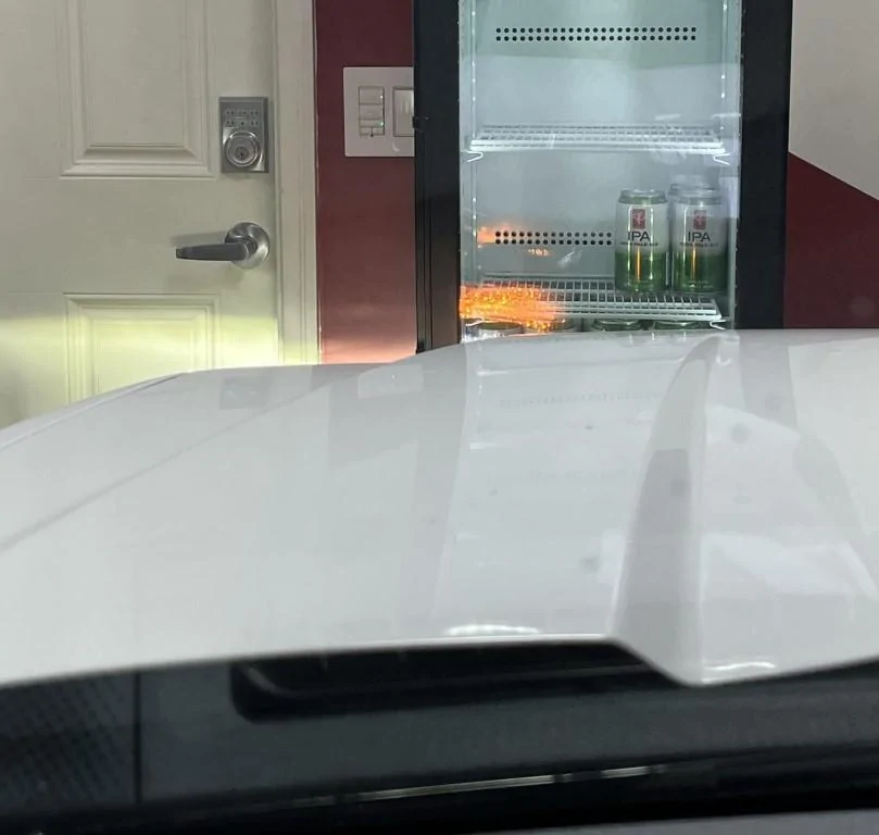

Auto Lights, Sensor Covered, vehicle in Drive, No Parking Brake.
Sensor Illuminated (daytime): Signal 100% Brightness, No Low Beam, Vehicle in Drive no parking brake.
