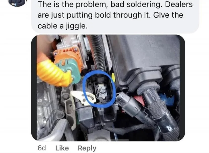

I looked but couldn’t find the post about putting a bolt through the battery harness that is either loose or corroded. Mine already looks like this picture with the bolt through it. Is this a before picture and something else has to be done or is this after the fix? Just wondering if the factory started doing this before the truck was shipped.
Interesting.
What was your build date?

That sure looks like a NORMAL factory termination to me, what am I'm missing here??
YES! I ride the short bus so be gentle.

Or they knew it would fail based on recent data reported to/ by Ford.
I realize that in a HYBRID, the 12v battery may have a lighter load but IMHO, 470 CCA is somewhat under powered and probably a compromise decision based on financial criteria.
Something to consider? Is the battery a glass matt like the ones that are sold for 4 wheelers and off road. In any case I suspect that there is a good possibility of a bad ground and the 14.7 +/- on the buss is not flowing through the battery sufficiently to charge it. If the battery is only seeing less than 12 v it will not charge. Am not sure but a glass mat battery depleted too low will not survive. Also some charge controllers will not even attempt to charge a 12 volt battery if it's below 7 volts (safety to prevent trying to bring 6 volt battery up to 12v. If you have a 12 v lowered than 7 you have to put the battery on a 6 v charge. Then when it is fully charged you will be able to put it on a 12 volt charger and it will not think it's a six volt battery that needs charging. Also I believe that the deep sleep is not triggered directly by the low voltage of the 12v battery but is triggered when the high voltage battery gets below a certain level and the computer has to stop trying to charge the 12v so it put vehicle into into deep sleep to prevent damaging the high voltage battery.
I believe the repair mentioned would be drilling and installing a bolt to clamp where the weak solder joint would be. So approximately where the heatshrink is below the tape-wrapped convoluted tubing; the grey section of the wire near the top of the circled area.
Seems like such an easy diagnosis and fix, if only temporary until a replacement cable comes in.
Can this really be the issue that has technicians and Ford scratching their heads? Not comforting.
