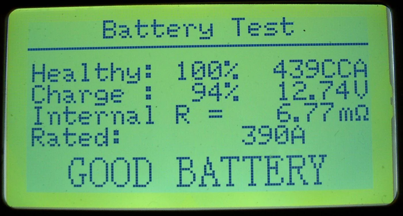

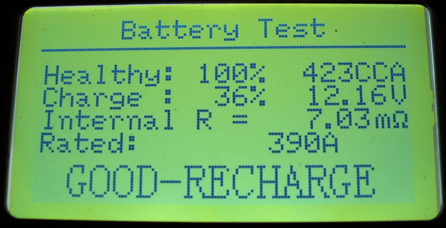

The Maverick Hybrid is still not keeping the 12 Volt Battery properly charged.
In three days and many long trips the 12 Volt battery had discharged from 100% and 12.81 volts (after I had manually re-charging it) down to 36% and 12.31 volts.
@Ford Motor Company is there a fix for this problem?
I again manually re-charging it for about an hour but had to stop because I needed the truck for a trip.
I got it to 94% charge and 12.74 volts.

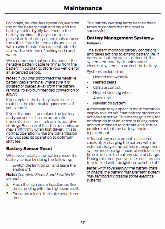

I believe the battery is lead acid deep discharge. If so shouldn't 12.16 read over 50% and 50% should be just under 12.1? And 100% should be close to 12.85v. Is your charger correct one for deep cycle and will not overcharge it?? Just a thought hope it helps. Perhaps it might help if the "new battery install" procedure was followed??

12v battery information is pages 310-313. Nite battery sensor reset on page 311 as well as battery management system page 312 be sure to read the paragraph that states the battery management system requires 8 uninterrupted hours sleep time to relearn the state of charge of the battery. This implies that if not done the BMS may not properly recharge the battery !!! Somewhere it also said to turn of all things that come on when the start button pushed/ key turned. Particularly that the head lights could be blown. Also info on battery page 355-356.
