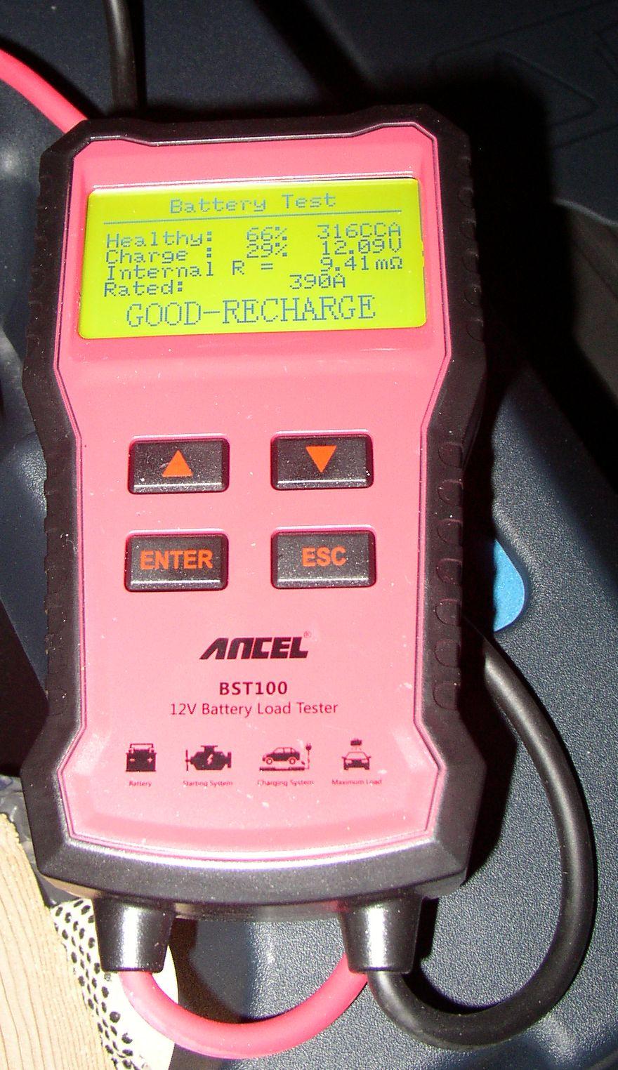

I have an ANCEL BST100 Battery Load Tester that I use for testing 12V batteries.
I have posted pictures showing it and the following results.

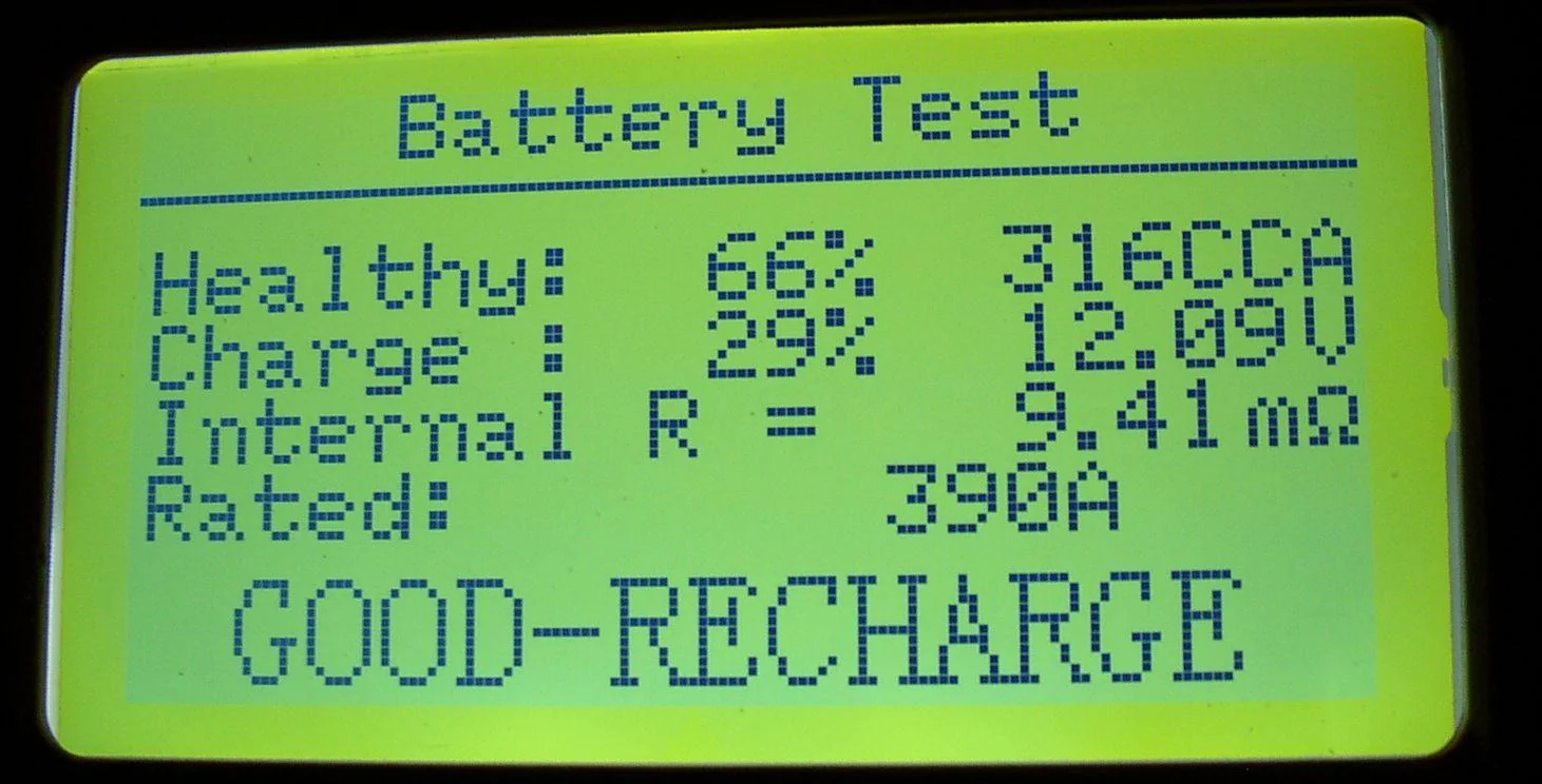

When the Deep Sleep was first reported on my FordPass App these were the results:
Deep Sleep:
Healthy: 66% 316 CCA Amps available
Charge: 29% 12.09 Volts
GOOD-RECHARGE

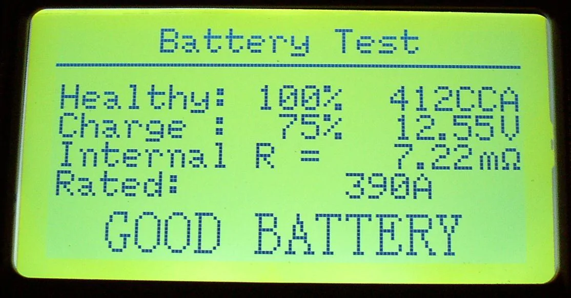

After 30 minutes of ON time I again tested and got these results:
Healthy: 100% 412 CCA Amps available
Charge: 75% 12.55 Volts
GOOD BATTERY

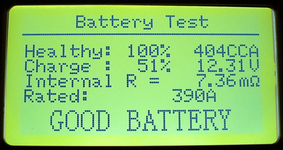

A number of weeks later and after a Home Depot run that took 30 minutes each way I had these numbers:
Healthy: 100% 404 CCA Amps available
Charge: 51% 12.31 Volts
GOOD BATTERY
