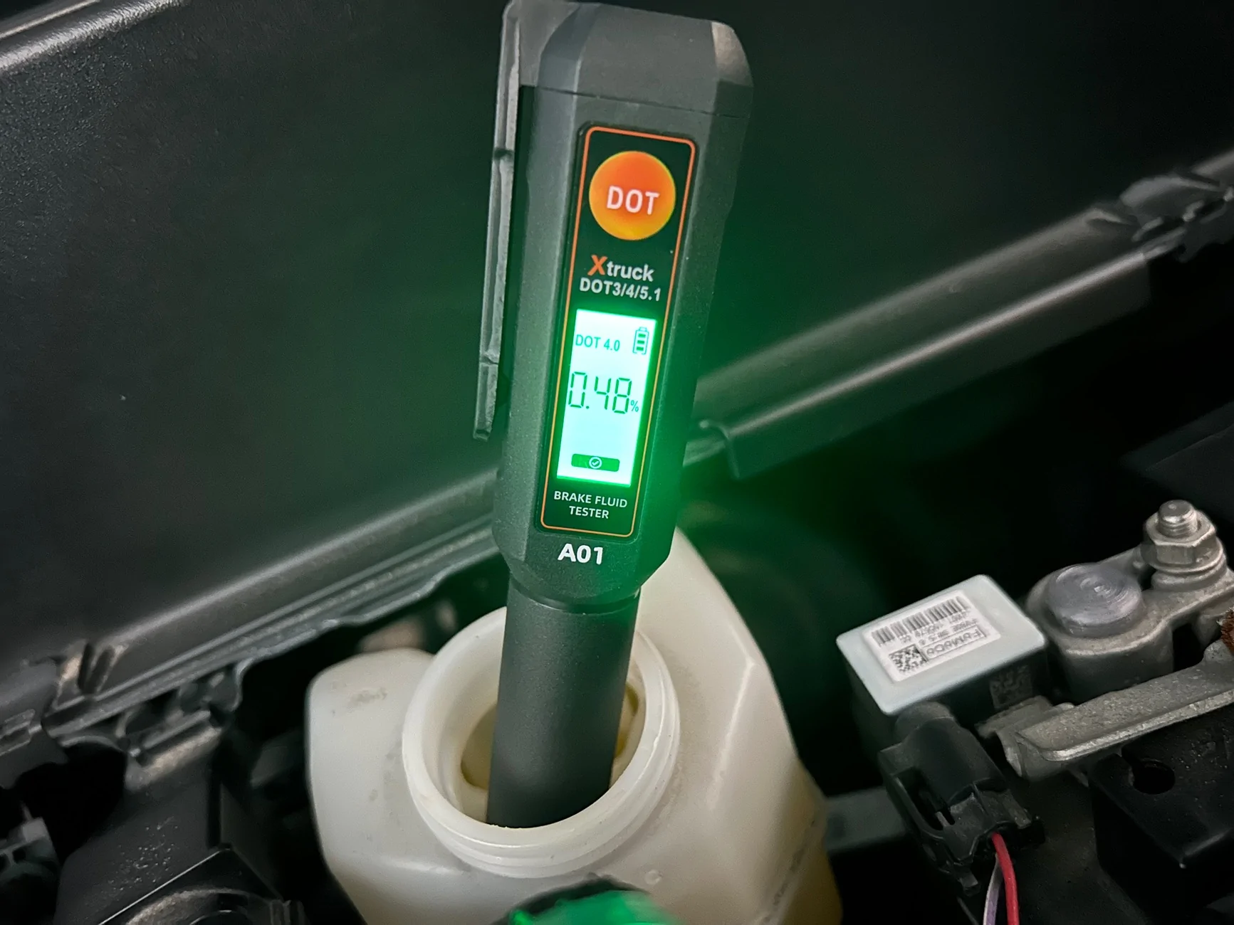

I was intrigued by the recommendation of changing the brake fluid every 3 years. I went ahead and ordered one of the brake fluid testers from Amazon. I’ve had the truck for just about 3.5 years and 45,000 miles. Tested fluid and came out to .48%. In the green and perfectly fine. Just for the heck of it I tested the brake fluid in my wife’s 2019 Flex. We’ve had that vehicle for almost 7 years and 76,000 miles. Tested out to .95%. Also in the Green and should be good for some time. We live in SE Michigan so it can get humid, but nothing prolonged. I suppose it depends on the climate you live in and how hard you work the brakes as to when you need to change the brake fluid.

I've never used one of those testers so I am curious - what is the proper % range for the average vehicle, and what exactly is it measuring? Thank you, sir.

Up to 2% is considered not too bad yet, but above 1% plan on changing.
It's the water content in the fluid - which below 1% is to be expected since it absorbs moisture.
Why it's recommended don't keep open bottles of unknown age and then use it.
It would be interesting for a certain region - to test open jar lids of DOT 3 & 4 and see which is worse after a week and then a month of time.
My mom's car, after 5 years here - was not only above 4%, but looked disgusting.
Another good tester to get - coolant strength refractometer.
That one's in the manual for testing annually or less.
Guessing may not get up to the 200k/10 yrs scheduled maintenance replacement with constant testing.

Hi,
My understanding is 0% to 1% is excellent, 1% to 2% is OK, but consider changing. 2.5% to 3% needs to be changed. 3% or more is danger and change immediately. It is measuring the percentage of water in the brake fluid.

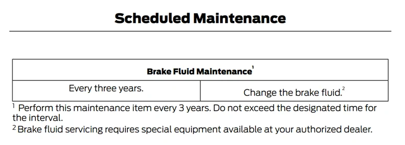

The recommended duration is 2 years or 30k. Not sure why any of this is viewed as ridiculous?
???? please quote your source? 2026 owners manual says:
I was speaking in general, apologies. Generally speaking the duration is 2-3 years. The fluid absorbs water. Replacing it is not a crazy money grab.
I agree it's a needed item but am always cautious to recommend that **READING THE OWNERS MANUAL** is an important part of vehicle ownership. Unscrupulous service departments are always willing to fleece unsuspecting owners out of their money.
