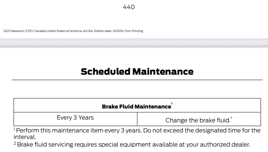

BDennis
Bruce
Jun 29, 2021
44
812
906
So Cal
2022 Maverick hybrid & E450 Leprechaun
My 2022 manual shows "every 3 years". At 3 years my dealer service manager said "Maybe at five years but best to not remove cap. Have you removed the cap?". They check level by looking through plastic. (I don't know but does brake fluid glow in UV light and make it easier to see level?).
Just checked uv due has to be added and has to be comparable with your type of brake fluid so specifically made for different types of brake fluid.
Absolutely
People say they don’t notice any difference in their brakes for way more years or miles, it is because the degradation in braking is a slow gradual process. I went four years on my wife’s Rogue, and the pedal was definitely firmer afterwards, as well as brake pedal feel.
