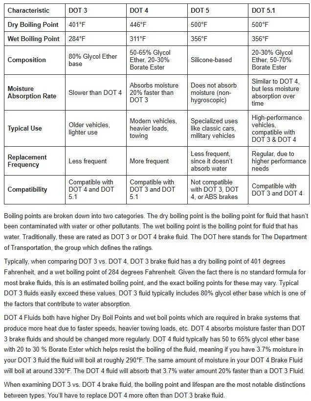

But how in the heck does that moisture get into the brake fluid system? I know what some interweb sources say:
There are a few common causes of moisture accumulating in brake fluid, the most prevalent being condensation from the environment. As brake fluid cycles through the braking system, it is exposed to fluctuating temperatures, which can cause water molecules from the atmosphere to condense within its components. Additionally, improper maintenance procedures (such as leaving brake fluid reservoirs open) can also lead to moisture buildup over time. Finally, manufacturing defects, system leaks, or incorrectly installed components may also be at fault for introducing moisture into your car’s hydraulic braking system.
And from a UK motorcycle site :
Brakes that use DOT brake fluid are more prone to water or moisture ingress. DOT brake fluid is hygroscopic by nature which means it absorbs water from the environment via seams and microscopic pores in your hydraulic lines. This water content has an adverse effect on the performance of DOT brake fluid by reducing its boiling point.

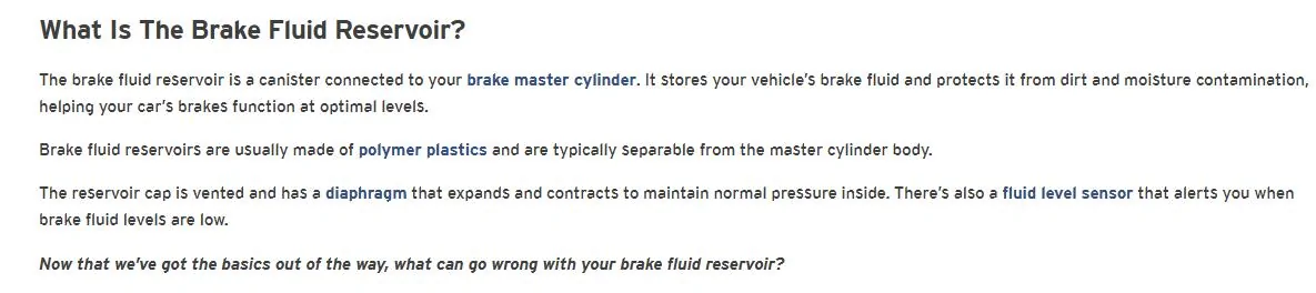

What I've always assumed (but still not 100% positive about) is that most all modern car/truck brake fluid reservoirs (the thing with the cap upstream of the master cylinder) are vented (even though you typically can't 'see' where it's vented).
When you interweb-search "are car brake fluid reservoirs vented" you'll get a variety of so-called answers (and a lot of opinions) from yes they are to hell no they're not.
At present I'm choosing to believe that they are vented as that makes sense to me, and for what it's worth, AutoNation (big dealer group) Mobile Service is in general saying the same thing:

Spec'd fluid is DOT4 LV (low viscosity), At least for Ecoboost.
The brake system is not vented to atmosphere. The reservoir cap is vented, but the expandable rubber seal is not. As your brakes wear, the level in the reservoir goes down. The caps rubber seal will expand to fill the void in the reservoir. The cap has to be vented to allow the rubber seal to expand.
