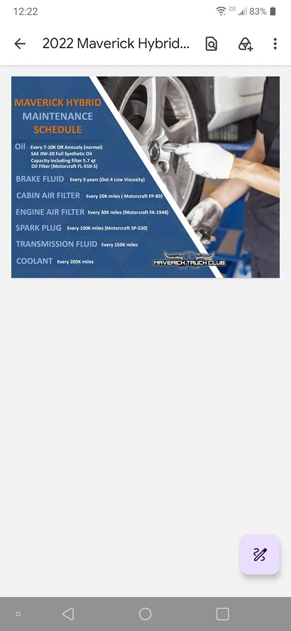

That's a lot of money for that fuel system cleaning that's not really needed especially if your running Top Tier fuel. I don't really know the origin of the following graphic, but I made a screen shot of it here back when I was waiting for my Maverick to be delivered. No mention of fuel system cleaning as a maintenance item. Seems like the brake fluid is three years no mileage specified.
