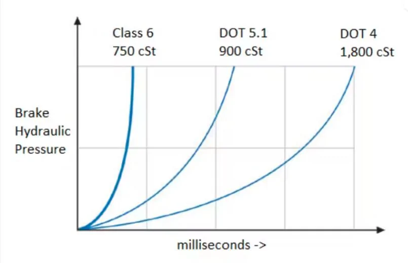

This is getting interesting. So, I confess I was not a brake fluid connoisseur, however am reading up on it.
Here is a chart of typical viscosity of brake fluid. Class 6 = DOT 4 LV, that meets Ford's specs of 4 LV fluid.
Ford Maverick Hybrid Brake Fluid Flush Cost? 1741812721704-p2

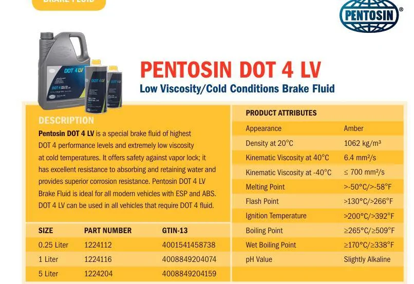

So looks like you are correct. Appartently, after some research, the Ford DOT 4 LV is rebottled Pentosin, which is what I remember using on my VW years ago:
Ford Maverick Hybrid Brake Fluid Flush Cost? 1741812821776-7x
Doing some more Googling, Prestone DOT 4 has a viscosity of around 1048 mm2/sec, so higher than the LV fluid, and that is measured at -40°C.

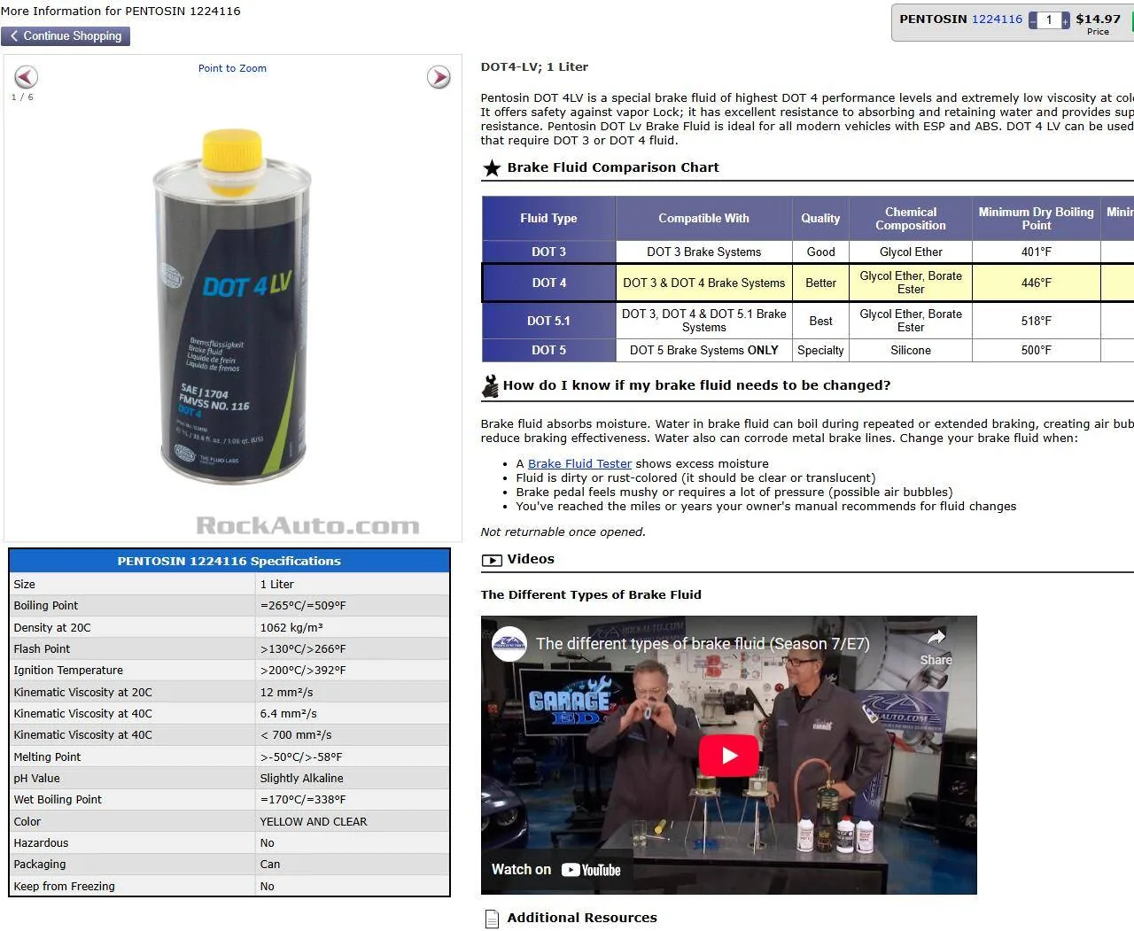

Pentosin is available from Rock Auto for around $15/33.8 oz (plus shipping):
Ford Maverick Hybrid Brake Fluid Flush Cost? 1741813805336-h3

I imagine you'd need 32 oz +/- to complete the entire flush, at least I always have on all the vehicles I've owned. So, for $15 vs the $11 of Prestone, the price difference is almost nonexistent as long as you combine your ordering with something else at Rock Auto.
