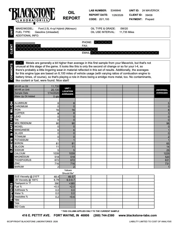

Here is mine from a nearly 12,000 mile interval, following the OLM. Will test again next time.. truck currently has 24,100 miles, OLM says 65% or 7,700 miles.
Ford Maverick Blackstone Labs Oil Analysis Comparison at 10k Miles Oil Report Redacted
Whoever said Blackstone is "AI".. I nearly fell out of my chair with how hard I rolled my eyes. If anything you don't like or agree with is brushed off as AI slop, essentially, then you are a prisoner to your own mind. Good news is that not being that way is very much a choice.

Looks great! I wouldn't call a 50% increase in mileage a "smidge"!

You do see they recommended 7k oil changes, or did you skip that part?
This would be a habit of Blackstone, if all numbers look peachy, pick a number 2-4k ahead of the mileage on this report.
Source: Blackstone Joe of the Slick Talk podcast
