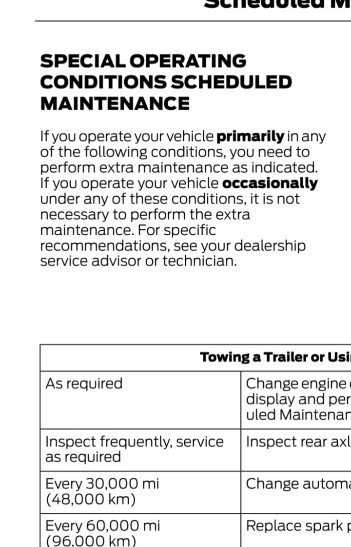

Do you tow , do you idle a lot or drive heavy stop and go traffic?
Is it dusty or sandy or drive on unpaved roads?
Short trips under 10 miles in below freezing temps which I do. . Do you go off-road.
If you do you any of these you are now severe service.

According to the 2023 hybrid Maverick's owner's manual it states that an oil change every 5,000 miles is needed if the vehicle is subjected to severe use which is defined further in the manual as extended periods of operation in extreme heat, or dry dusty areas. Also it includes if the vehicle is subjected to many short local trips with much stop and go (as the gas engine is repeatedly stopped and started). 5,000 miles intervals is a prudent was to ensure longevity of the engine. This is an A.I. composed road trip showing what 5,000 miles is. I would definitely get an oil change before a trip of this length and one soon afterwards.
