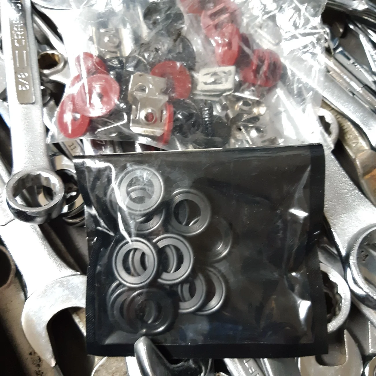

I replace the drain plug gasket with a fresh one every time I change my oil.
Ford Maverick Blackstone Labs Oil Analysis Comparison at 10k Miles 20260413_094844
I don't own a torque wrench.
I use my calibrated wrist to tell me what's tight enough.😉
I put in a quick change valve.
As long as that doesn't leak, I'll never use the threads again.
I had a quick drain plug on my Buick Encore. It was convenient with the lever, it didn't drain fast enough for me, compared to removing the drain plug. I never change my oil when the engine is hot so that doesn't play into it at all.
Personal preference.
Like the Encore, if one was already installed, I wouldn't remove it.

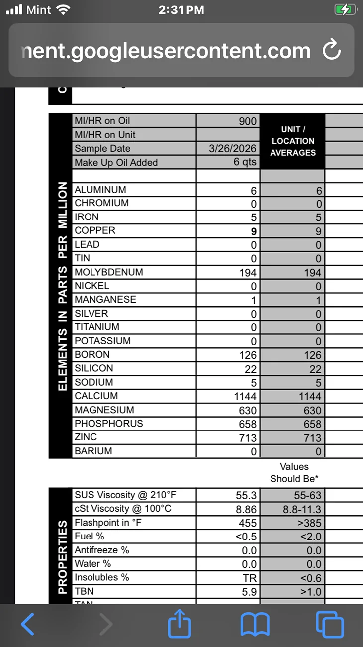

My results received today. Sent sample 4/1…I made note of my concern about oil dilution because my oil cap smelled like gas…25 EB oil changed at 900 and again 7months later (this sample)…5W-30 Full Synthetic Motorcraft
Quote:
“Chops: Thanks for the notes. The high flashpoint rules out any measurable fuel dilution in this oil, and there's no
evidence of water or coolant contamination, either. Wear metals are a little high for the interval, as universal averages
for this type of EcoBoost are based on ~6,100-mile oil runs. We're betting this Maverick hasn't had many oil changes
yet, though, so some extra metal could just be from parts wearing in. In that case, metals may improve next time. The
TBN is high at 5.9, so there's still active additive left in the oil. Try a 3K-mile oil run and check back on trends.”
