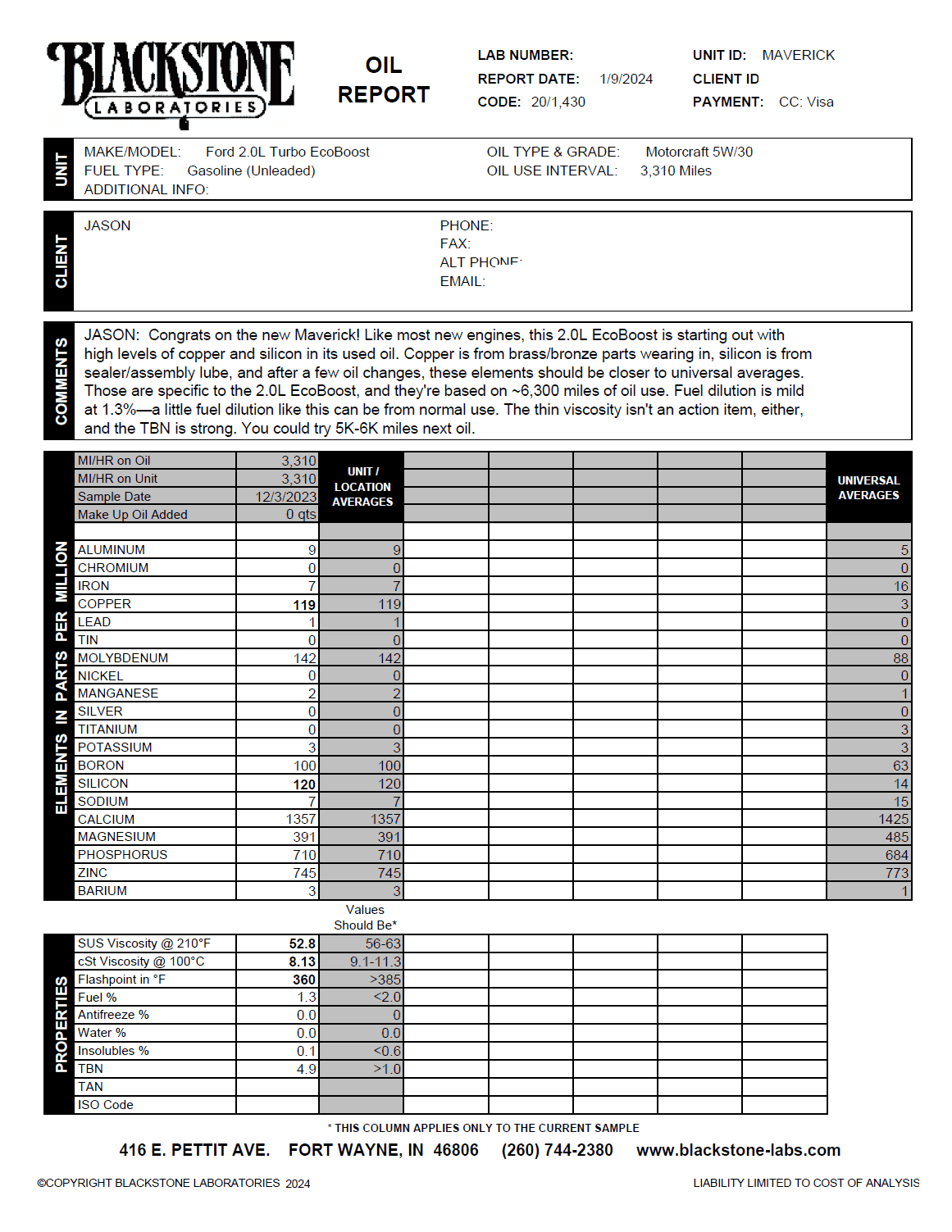

Ford Maverick Blackstone Oil Analysis Report(s) | Hybrid 1719414024878-fh
Should be over 385 Blackstone spec
Ford oil spec at new at 425F.

Well did ya use 50 weight?
Better check!
450 seems unreasonably high.
Blackstone says the average for used oil in gasoline engines is 380 and 410 for diesel engines.
Water in the oil, or some additive you added are the ways flashpoint can go up.
May be a typo? Yours was higher than virgin oil?

This was Motorcraft Full Synthetic 0w-20. No additives.
Blackstone will also tell you that the flashpoint test itself is more of an indicator rather than something that can be valued in a vacuum.
I think it’s also worth noting that the specs listed are their minimum acceptable specs. There will be some variation.
