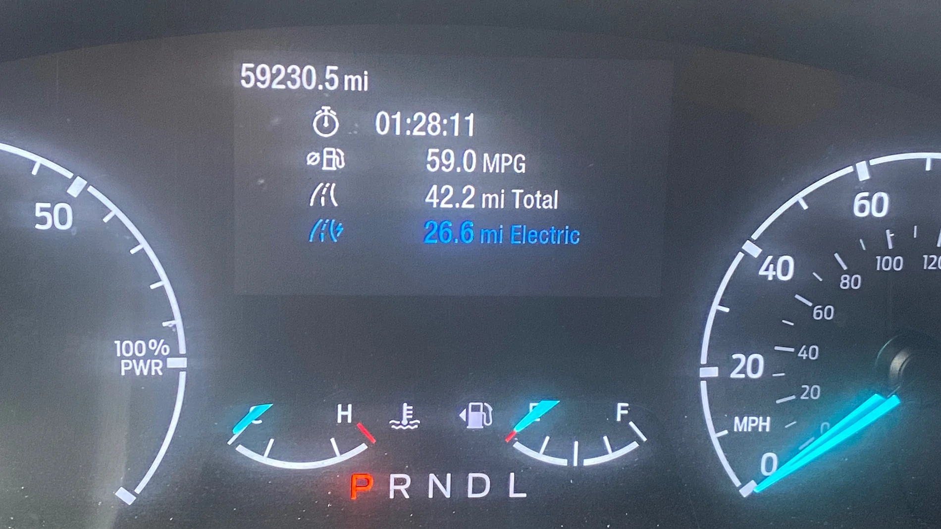

Gary,
If you're changing the oil every 5,000 miles. How many miles of actual engine run time, do you think, that equates to on a hybrid Maverick?
Hybrid engine run miles are fewer than 50% of odometer miles in stop n go and city drive conditions.
Highway / Freeway at 55 mph engine will be on for about 90% of the miles.
At 65 mph engine will be on for about 98% of the miles.
At 75 mph engine will be on 99.9% of the miles.
At 81 mph and above the engine will run 100% of the miles.
In my gentle drive cycle more like 60% of the miles have engine off.
Ford Maverick Blackstone Labs Oil Analysis Comparison at 10k Miles IMG_7773
I've gone 6000 miles in 4 months.
Oil life is 59% remaining.

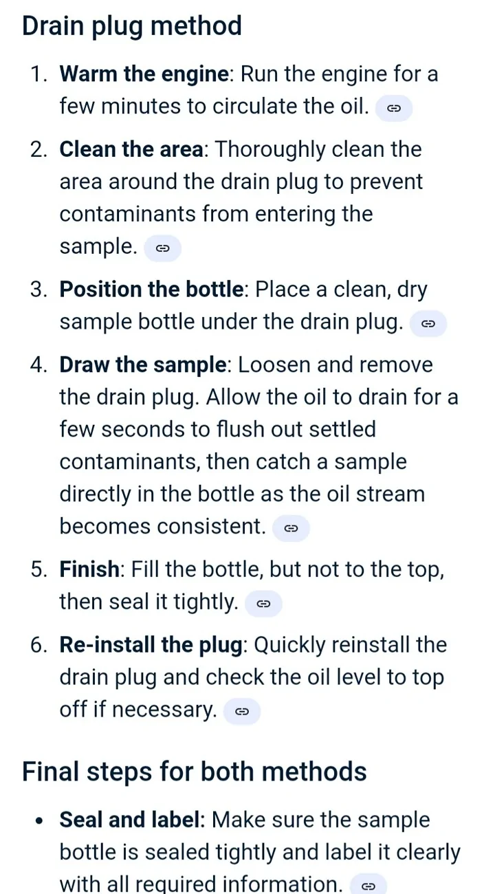

Sounds like a pee test!
Remember to take the sample from midstream. 🫣 #4
Blackstone Laboratories oil collection involves collecting ~3 oz of engine oil in a clean bottle during an oil change or via a dipstick pump, filling out the provided info slip, and mailing it using the prepaid container. The key is to take the sample from the middle of the drain, not the beginning or end.
From Blackstone Laboratories

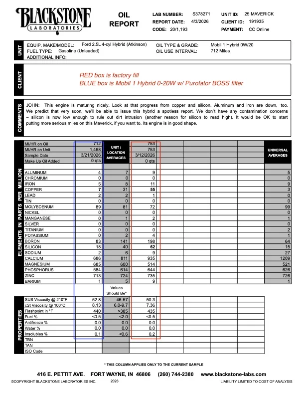

Bought a holdover 2025 w/ 56mi on it. Have a little over 2k so far. Ballpark 75/25 gas/electric due to highway travel. Did my first 2 Blackstone reports. I've used them before on many vehicles.
OEM oil/filter changed at 753mi. Got to admit, since the vehicle was used as a demo model on the dealer lot, it didn't get run a lot, or hard enough, so the drained oil was very cloudy... presumed moisture build up since I live in the Puget Sound area. Used Mobil 1 Hybrid 0W-20 (unbelievably, Wal-Mart had it, Amazon and local part stores did not). Also used a Purolator BOSS filter.
So far, so good. Doing the next change at 5k mi out of force of habit. MAY rely on the oil life indicator, or MAY just continue with my usual 5k increments. Got a 2013 C-Max with 220k, 2006 Miata with 190k and (drumroll, please..) 2003 Acura TL-S with 544k - all with 5k change intervals. Various filters over the years/models (some Motorcraft, WIX, Purlolator...)
I'll wait to see what the 5k # look like. MAY go to 7.5k intervals. Don't know yet.
Ford Maverick Blackstone Labs Oil Analysis Comparison at 10k Miles 25 MAVERICK
