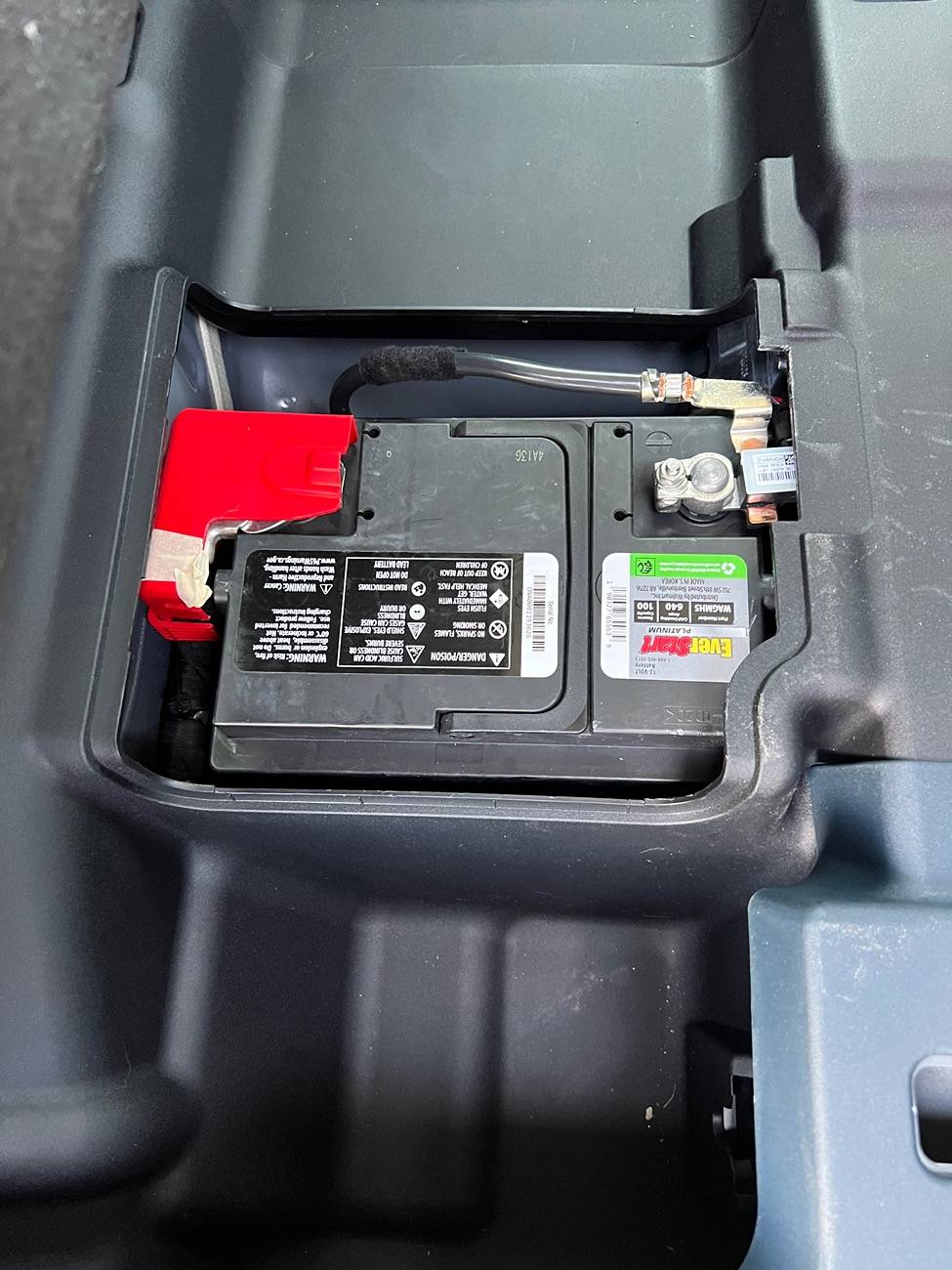

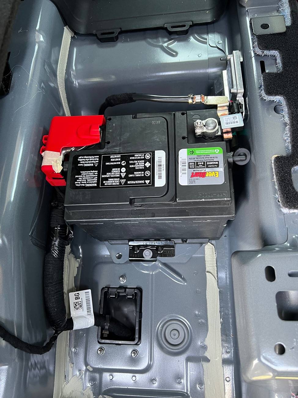

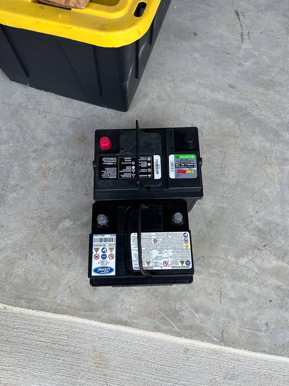

I took a chance on the EverStart H5. It's a big boy but it fits. Don't even try without removing the plastic storage. I hammered the tabs down so I could undo it later if needed. I hope this is the fix.
yes, I suspect that will do it, lol.
did you reset the BMS?
Thank you for posting pictures.
I have been wondering when the time comes what size, I would replace my battery with.
Am I correct, in assuming that you can not replace the plastic cover?

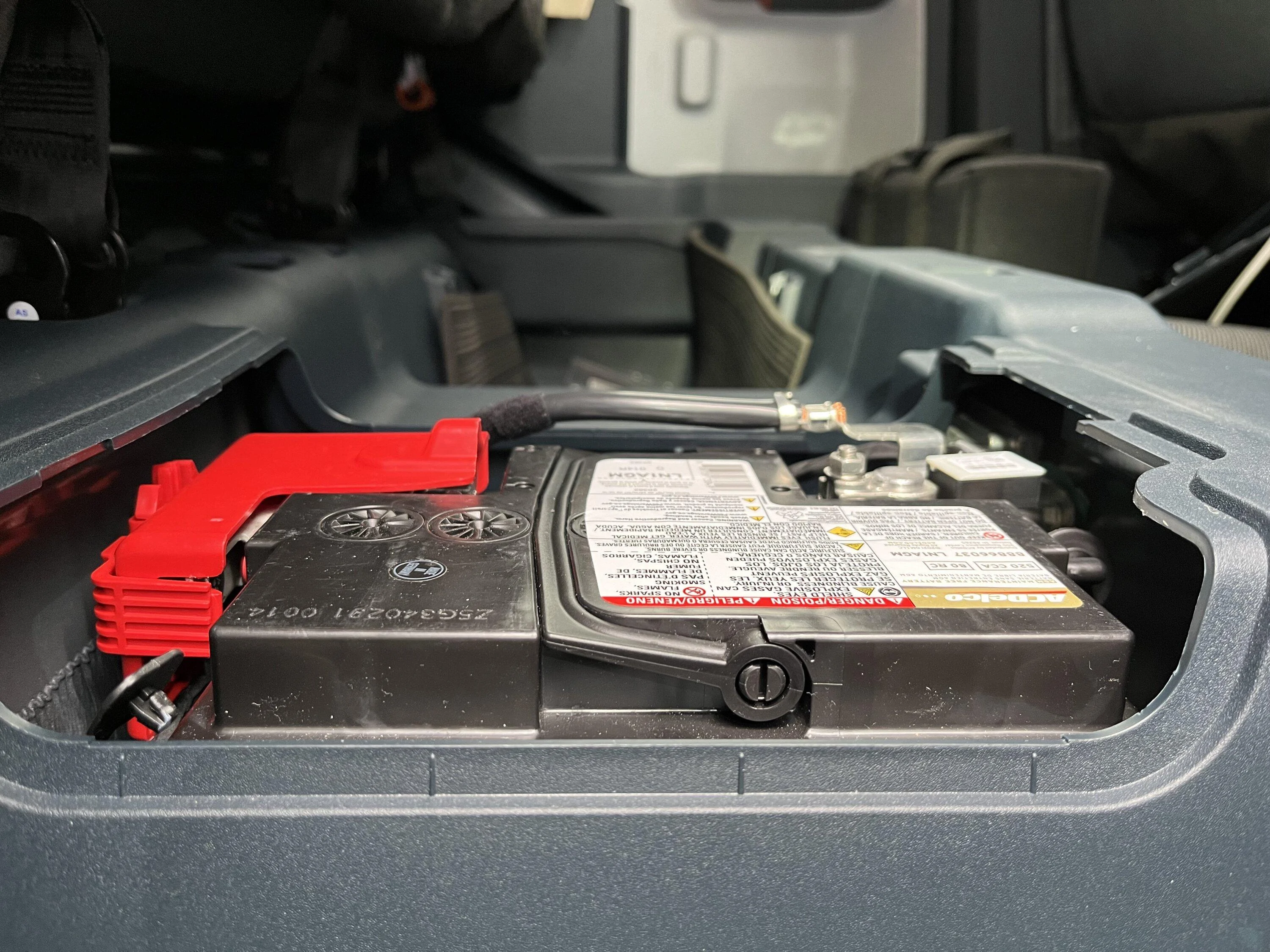

I Installed the ACDelco LN1AGM battery in place for Ford's OEM BXT99RT4-A that was in my Maverick hybrid.
The LN1AGM weighs 32.5 lbs, the BXT99-R is 27 lbs.
They're nearly identical physical size.
The LN1AGM has vent holes at each end of the battery for connecting the vent line and comes with a plug for the unused vent hole at the opposite end of the battery.

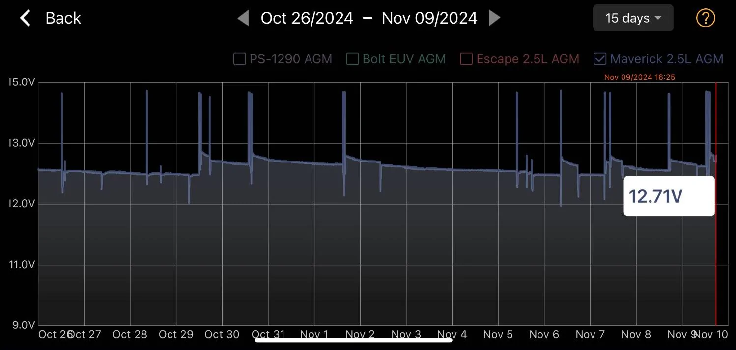

How's the ACDelco holding up? Any more issues with deep sleep? Getting fed up with my OEM battery now that it stays on for less than a minute after the truck stops running.
BlueSpec1
Gene
Jul 10, 2022
779
794
23 XLT 2.5L, 22 Escape Plug In, 23 Bolt EUV
No problems. Put in last Nov 22. Charge it twice a month usually ~ 1st & 15th.
Sitting at 12.71 volts this afternoon.
Hold that. Apparently there's an SSM/TSB to address this finally.
Very nice. Looks like I have to hold off for now. Apparently there was a TSB issued very recently for 12v battery drain on hybrids. SSM 53087. Maybe they're finally taking care of it. They have a procedure for charging and resetting the battery management system but ultimately there's a software fix coming Q1 2025 to fix an underlying software issue.
https://fordauthority.com/2024/11/2022-2024-ford-maverick-hybrids-may-have-12v-battery-issue/amp/
