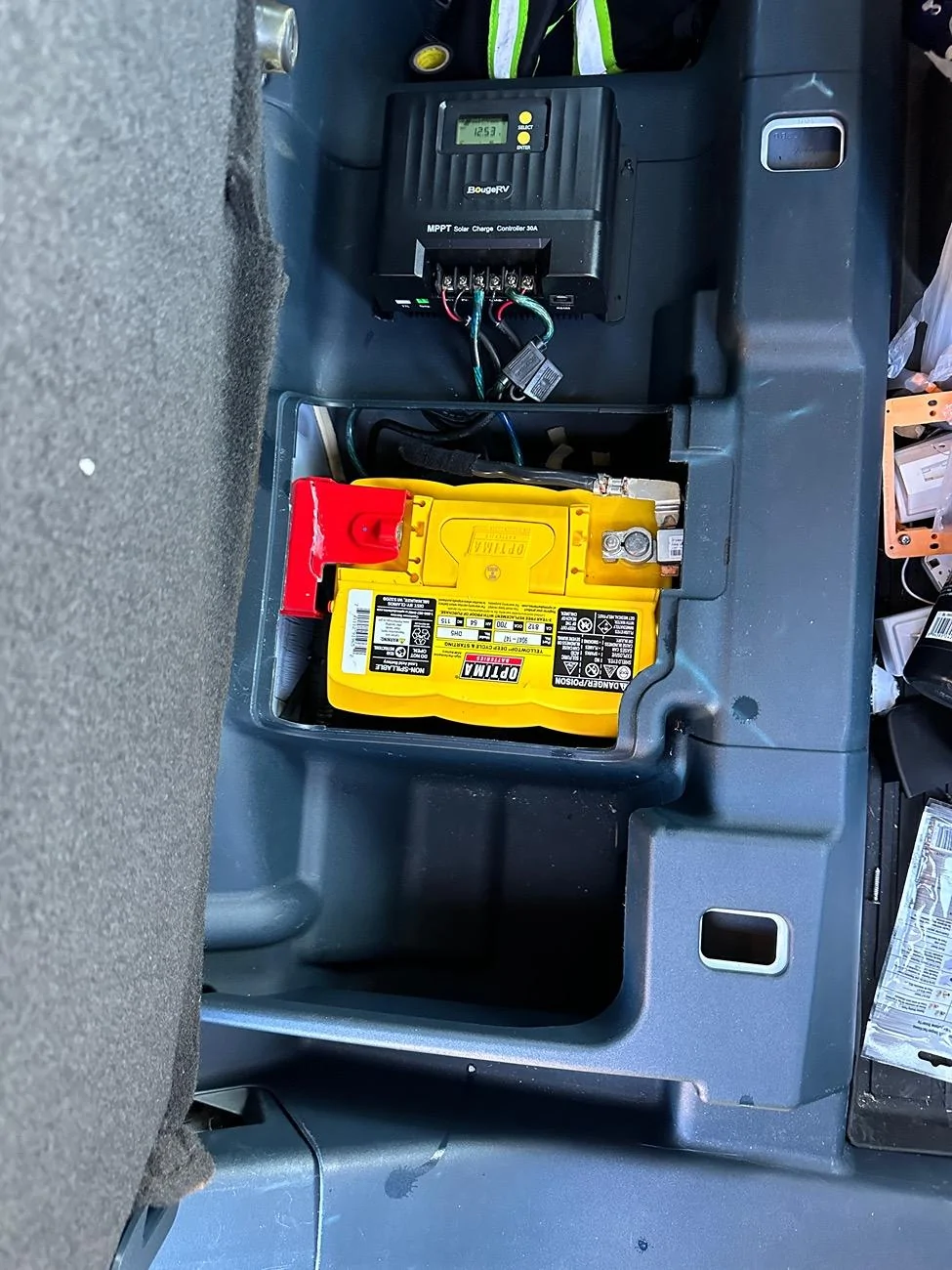

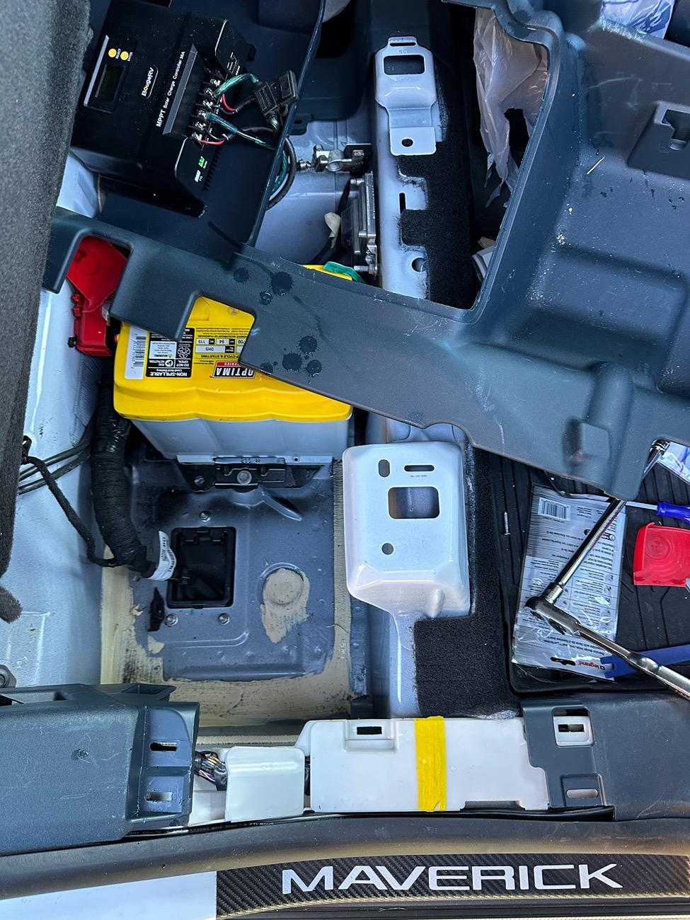

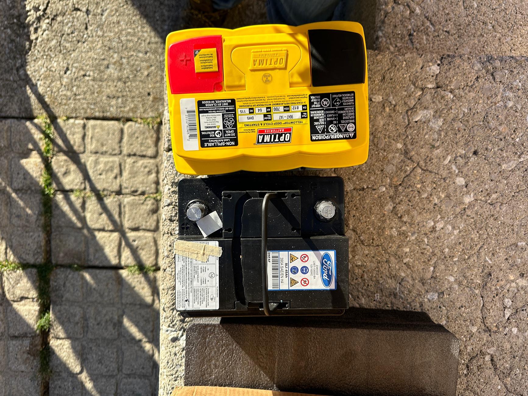

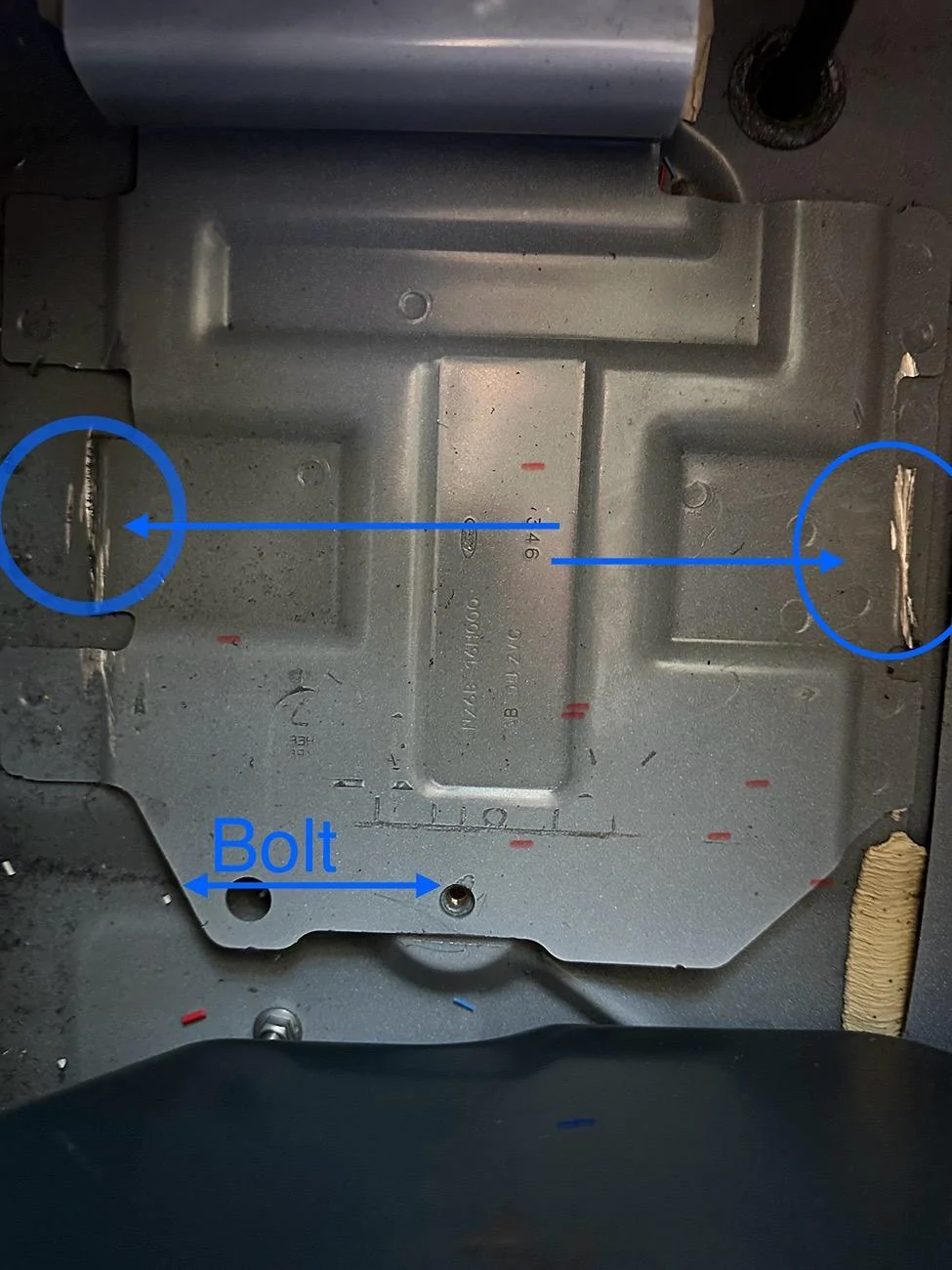

Tabs are easily removed with a cut off wheel to make room for a OPTIMA YELLOW TOP😊. Did this last summer and no more sleep issues
How do you remove the plastic tray since for the life of me I can't get it out?
Do you have to and remove the old H4 first, and if so will the tray snap back in after the H5 is installed?

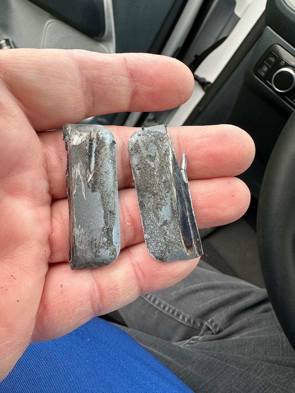

I did pull the old battery first, used an angle grinder to cut the ears off, you could prob use a hammer and bend them over as they are sheet metal. It made it so much easier to work with the tray out , just pulled real hard and it came loose
Then were you able to pop the tray back on top of the new H5 battery?

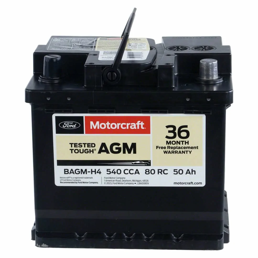

Can anyone confirm what AGM will fit correctly (or at least close) in the hybrid. I can't find any group 99 or T4 in an AGM.
TIA
The Ford Motorcraft one:

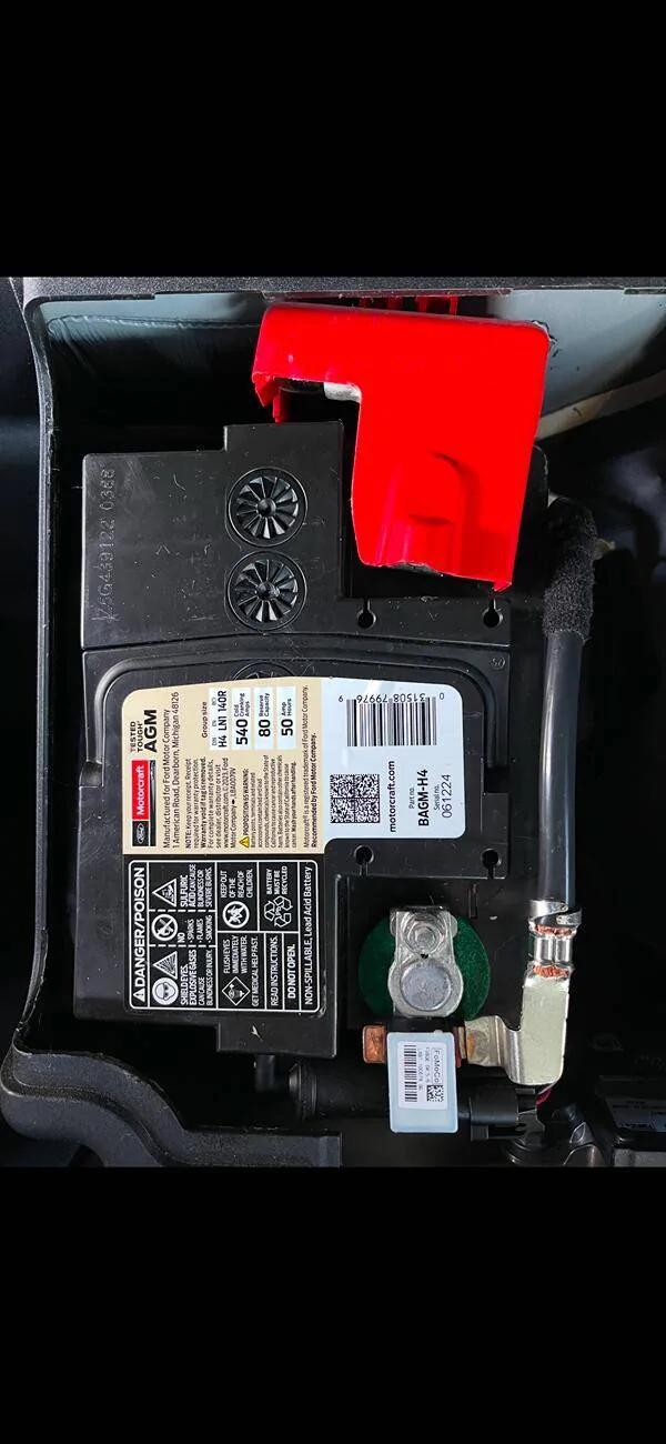

[/QUOTEY]
Yep, this is the same one I bought from FoMoCo to replace that pos flooded one that came in my late 2024 hybrid.
Kissed the low voltage messages and no interior lights issues goodbye!

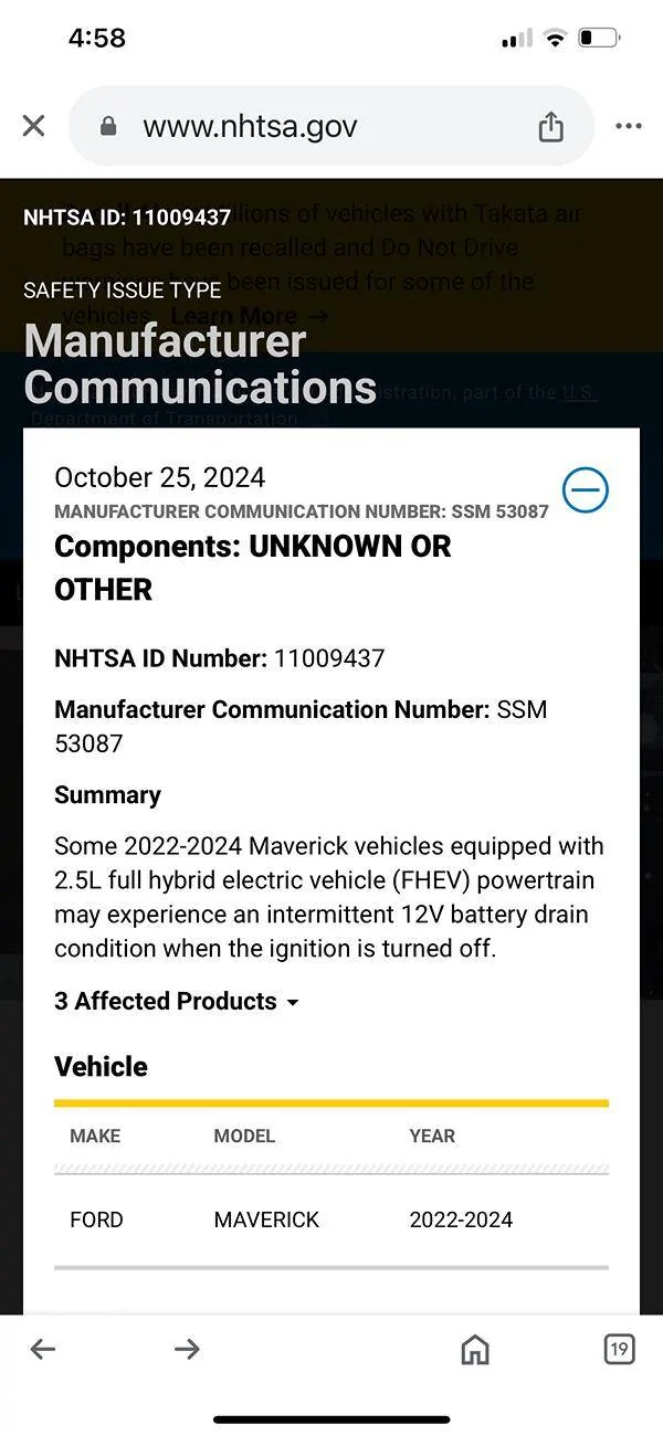

I started getting a low battery even after I just drove the truck. I noticed because the dome light didn't come on.
I got an AGM Delco battery off of Amazon at a very good price. So far so good.

My 2024 Lariat Hybrid would get random Deep Sleep and Remote Functions Disabled during the first 5 months of ownership. Starting at about 6 months, the messages were a regular occurrence, 2-3 times a week, even right after driving.
I replaced the battery with a Walmart EverStart AGM H5 battery ($180, bent tabs to fit) at the beginning of October 2024. Going on 6 months now and not one Deep Sleep or Remote Functions Disabled. The truck went thru a full Wisconsin winter, cold January and February. Below zero nights, single digit high temps. Sorry, but since installing the AGM, I stopped monitoring voltage.
