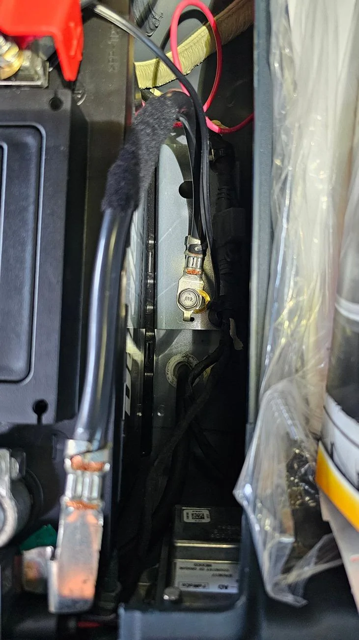

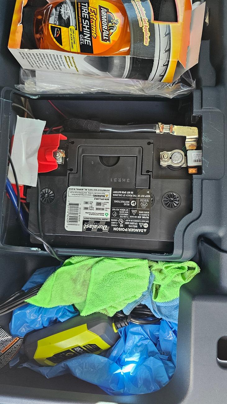

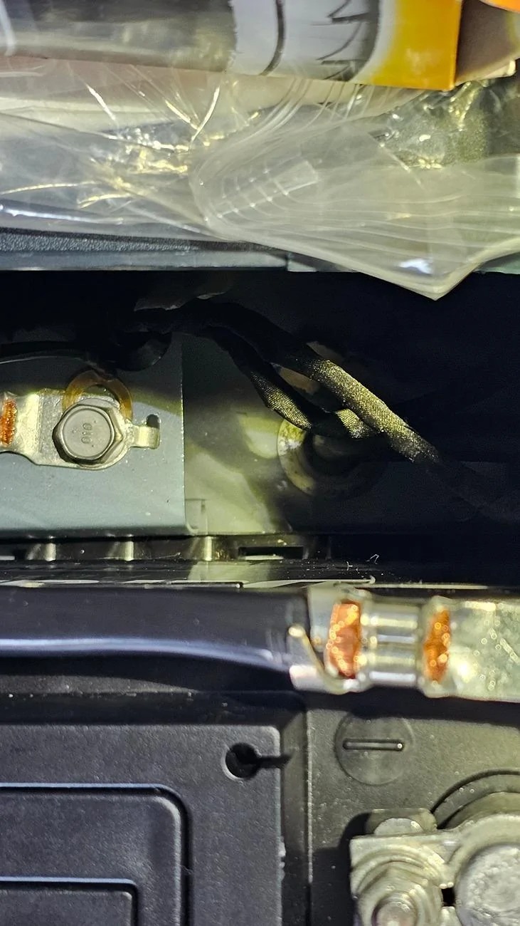

I will take some pictures, but I don't want to pull out the plastic housing all around. All I can say is my battery fit. I was able to use the stock clamp and bolt it down. It has the same dimensions around the four corners as the stock battery. It just sits about a 1/2 inch taller.

Perhaps my tabs are either down or not there? I really didn't have an issue getting this battery in. I got the H5 because another MaverickTruckClub guy had photos on how to do it. I will try to find his link/thread.

Here is the battery installed.
Ford Maverick AGM for Hybrid 20240628_135101
Ford Maverick AGM for Hybrid 20240628_135047
Ford Maverick AGM for Hybrid 20240628_134937
