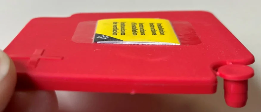

So far the automotive AGM batteries I've seen have vent ports at each end and include one plug for the unused vent port.
The Red cover on the battery positive post has the plug:
Ford Maverick AGM for Hybrid Vent Plug
