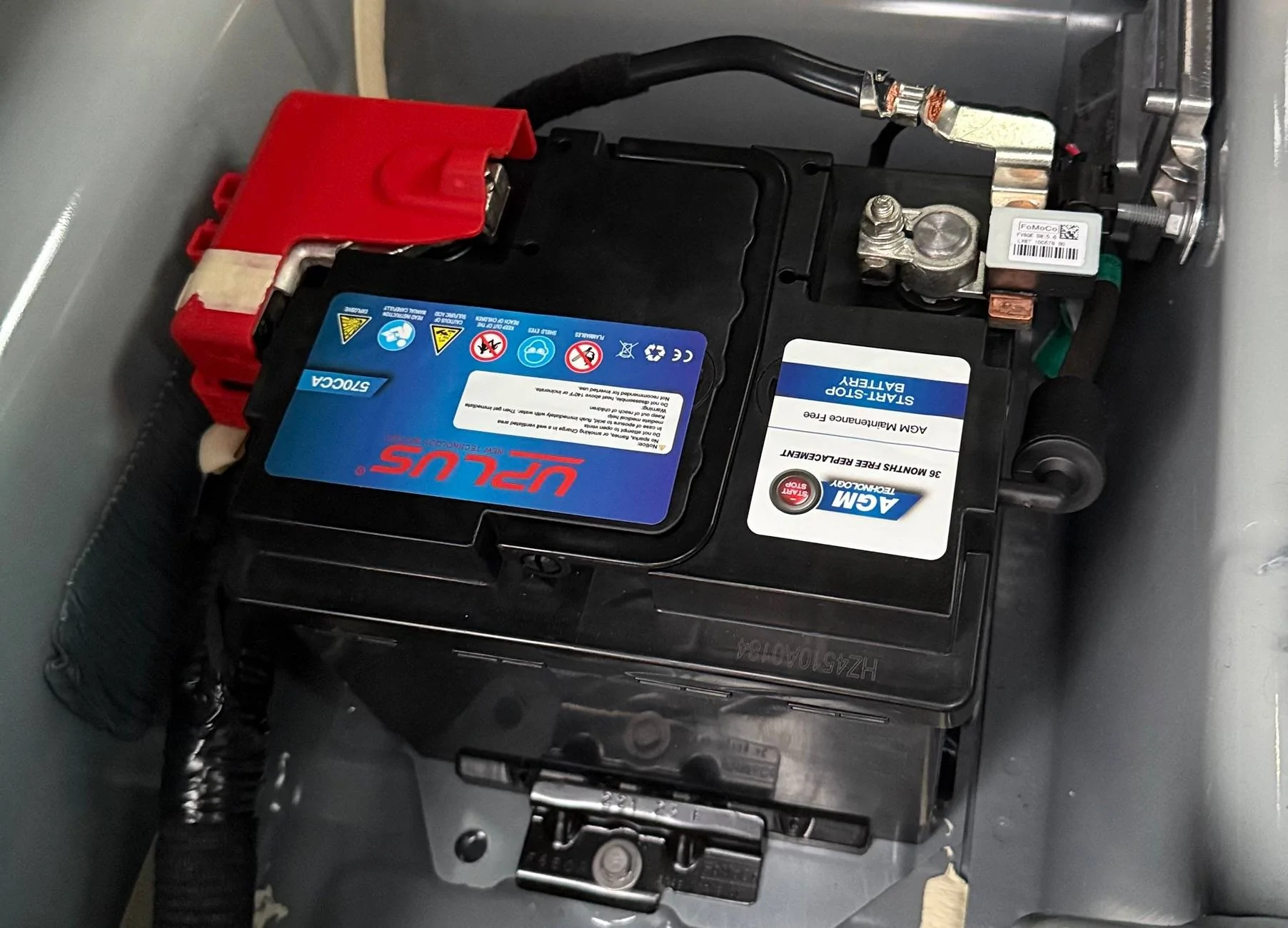

This looks too big. All the other batteries mentioned here are H5s.
H5 batteries are larger and require removing plastics and bending metal.
The battery in the picture below is a perfect fit.
What model number is it? If you say the H5 is too big, what is this? Thanks!
You're going to have to ask "Chewy"
About any specs.

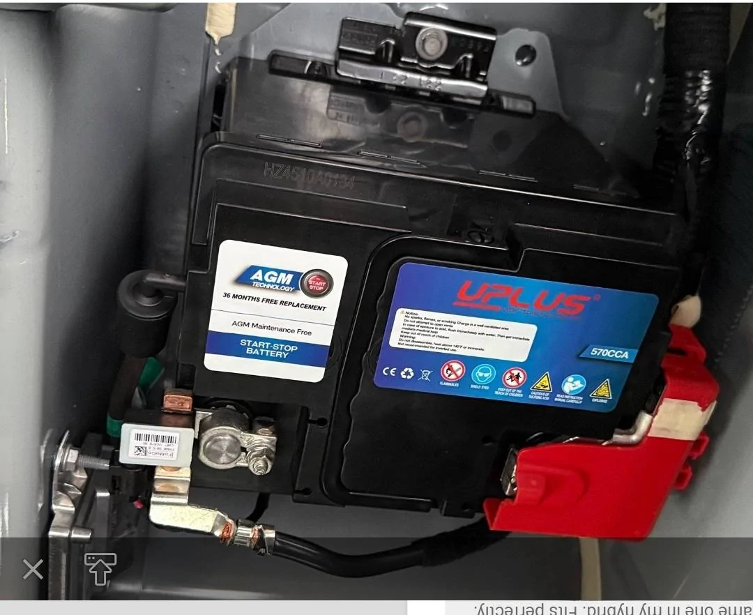

Here's what you have to do to get a H5 to fit.
I took a chance on the EverStart H5. It's a big boy but it fits. Don't even try without removing the plastic storage. I hammered the tabs down so I could undo it later if needed. I hope this is the fix.

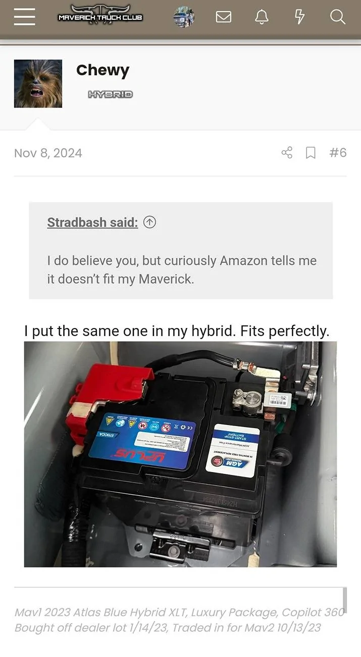

Amazon said the H6 was the right one for my Maverick, so I just went out and measured the one in my truck, and the H4 is the right size. Ford replaced my battery this past February, but still have deep sleep issues. Thanks for bringing the size difference to my attention and Amazon not having the proper info.
