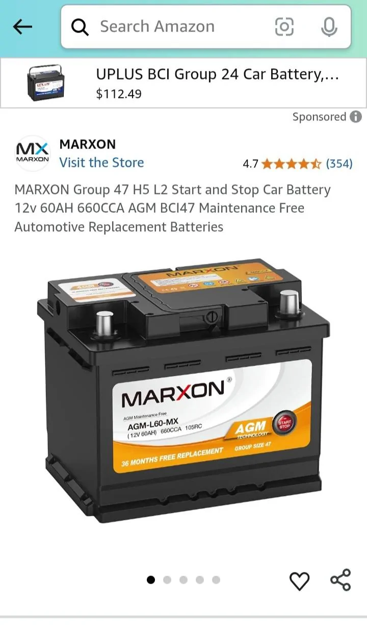

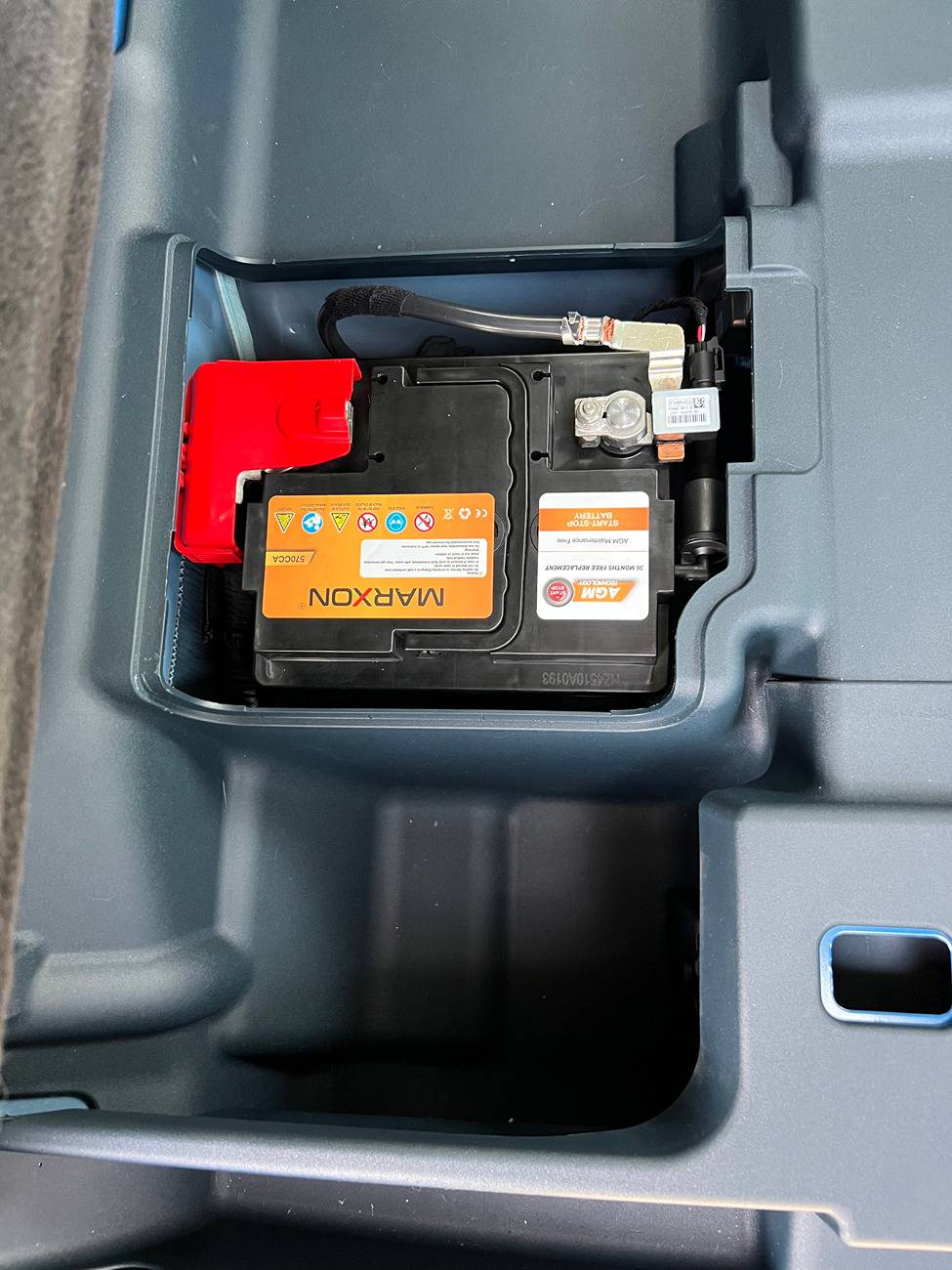

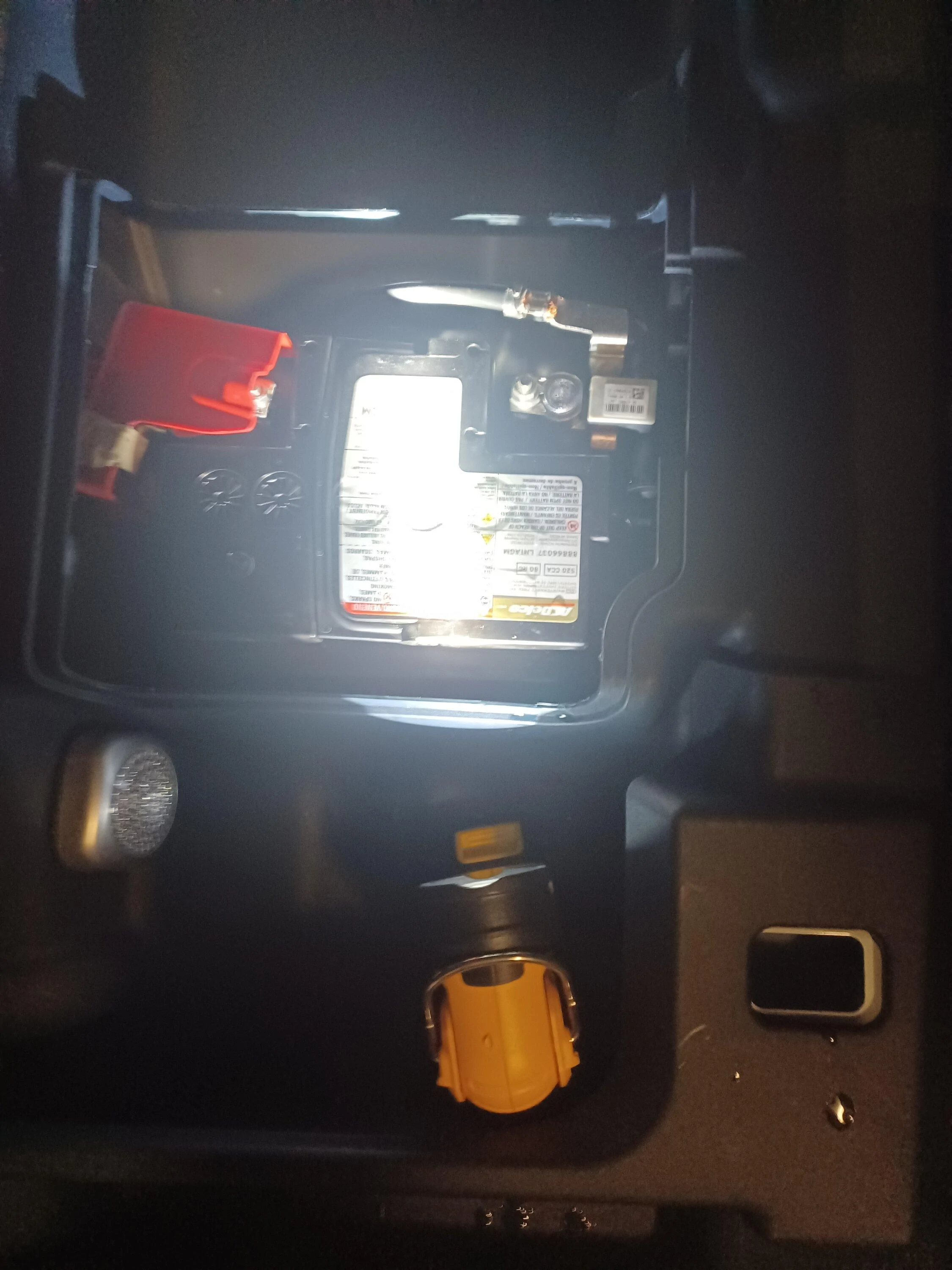

Put in a MARXON today, got it off amazon looks to be the same as the UPLUS everyone is using but was cheaper with coupon, the original ford battery was at 12.0/11.9 volts after removing from truck. nice to have my interior lights back.

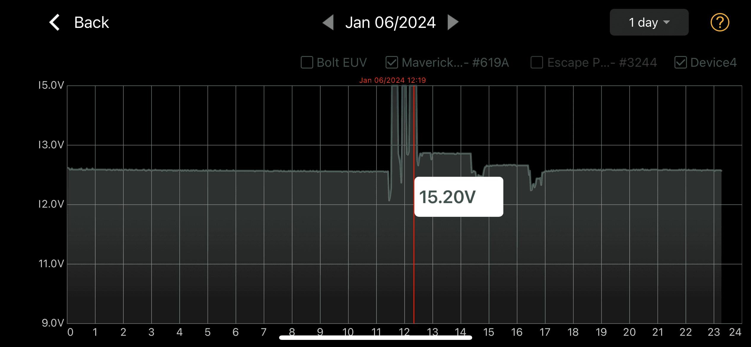

I started putting my battery on a charger once a week and it has been better, but found making lots of short trips in a day works too! This was last Tuesday while following our realtor around look at houses.

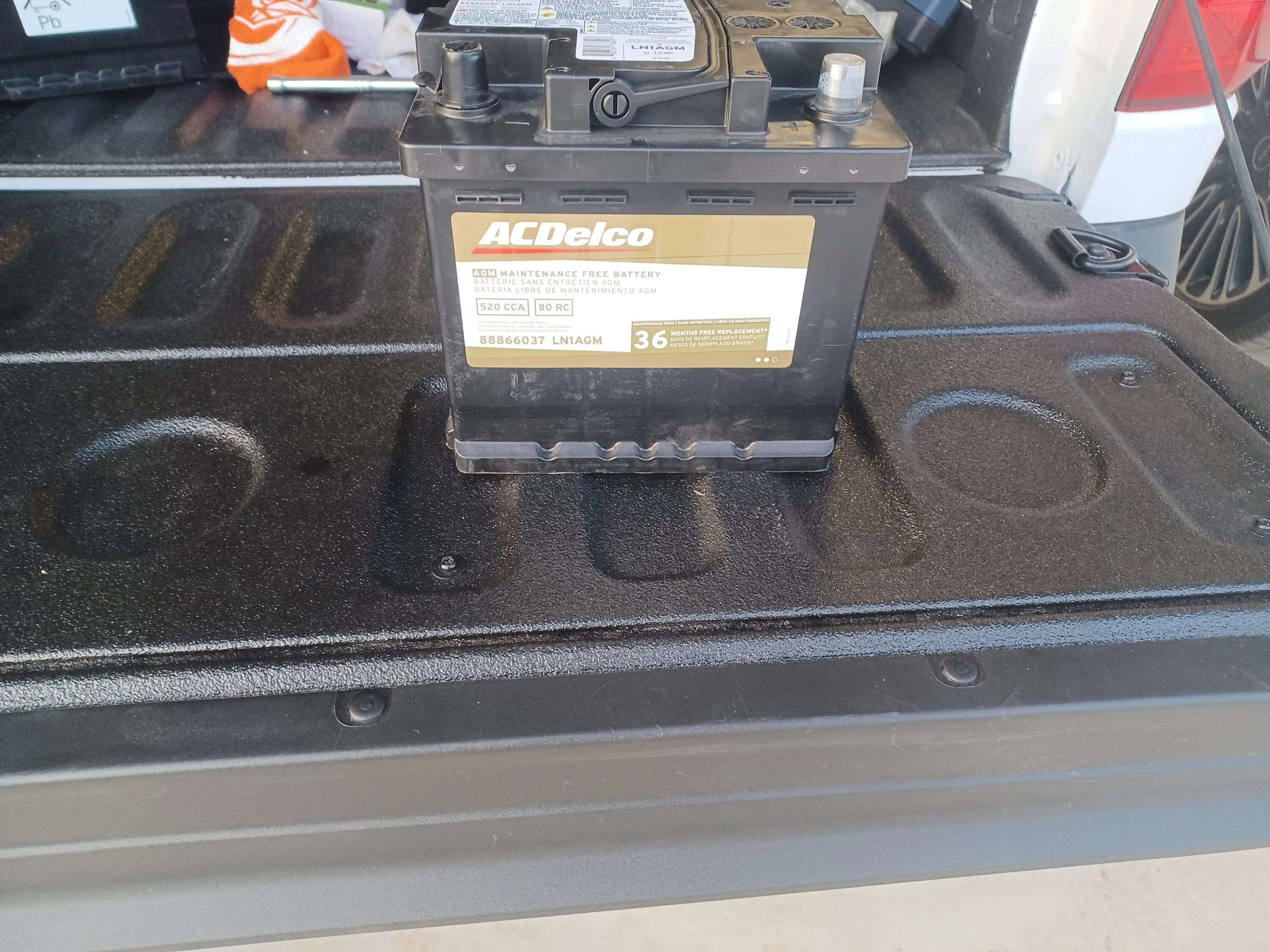

Update: April 1st. 2025 after a small run around with the dealer I decided to bite the bullet and drop in my own ACDelco LN1AGM. All I did was update the BMS (both ways). All of the deep sleep issues reset (dome lights, passenger side keyless entry...). While driven the truck SoC has never dropped below 62% and averages in the low 70% range, and the voltage is averaging 12.70V. I was a little hesitant having to pay a little over $300.00 CDN but when you do the math it is close to $220.00 USD and in line with what many are paying here.
My truck has been in storage since May 24th (as I suffered a stroke that has affected my vision) and it is now temporarily (optimism) on a trickle charger, but the average SoC and voltage remain about the same.
"FREMONT"

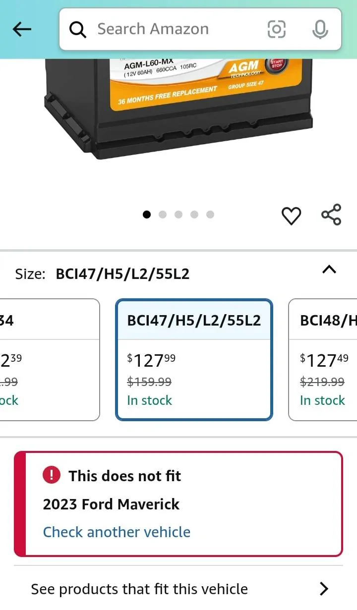

Because of the age of your post, I realize a reply is a long shot.
It's always good to have multiple options for agm batteries that fit the Maverick
Is your battery group 47 H5?
Ford Maverick AGM for Hybrid 20250711_093446
Ford Maverick AGM for Hybrid 20250711_093430
HeyBales
May 3, 2024
5,180
4,895
KC Metro area
I noticed in his pic it says 570CCA.
That may make it the correct but smaller H4 / LN1 / Group 140R size, since it seems to fit perfectly in space.
And I still wouldn't expect that drop-in replacement to be tagged as valid for Maverick yet.
Maybe 25MY!
ETA: corrected to 25MY. Not sure why am I thinking ahead to 26 for some reason.
Maybe 26MY!
it's probably buried somewhere in this thread, but this is the Motorcraft H4 AGM that the 25+ Maverick hybrid comes stock with. https://parts.levittownfordparts.com/oem-parts/ford-motorcraft-trade-battery-bagmh4
