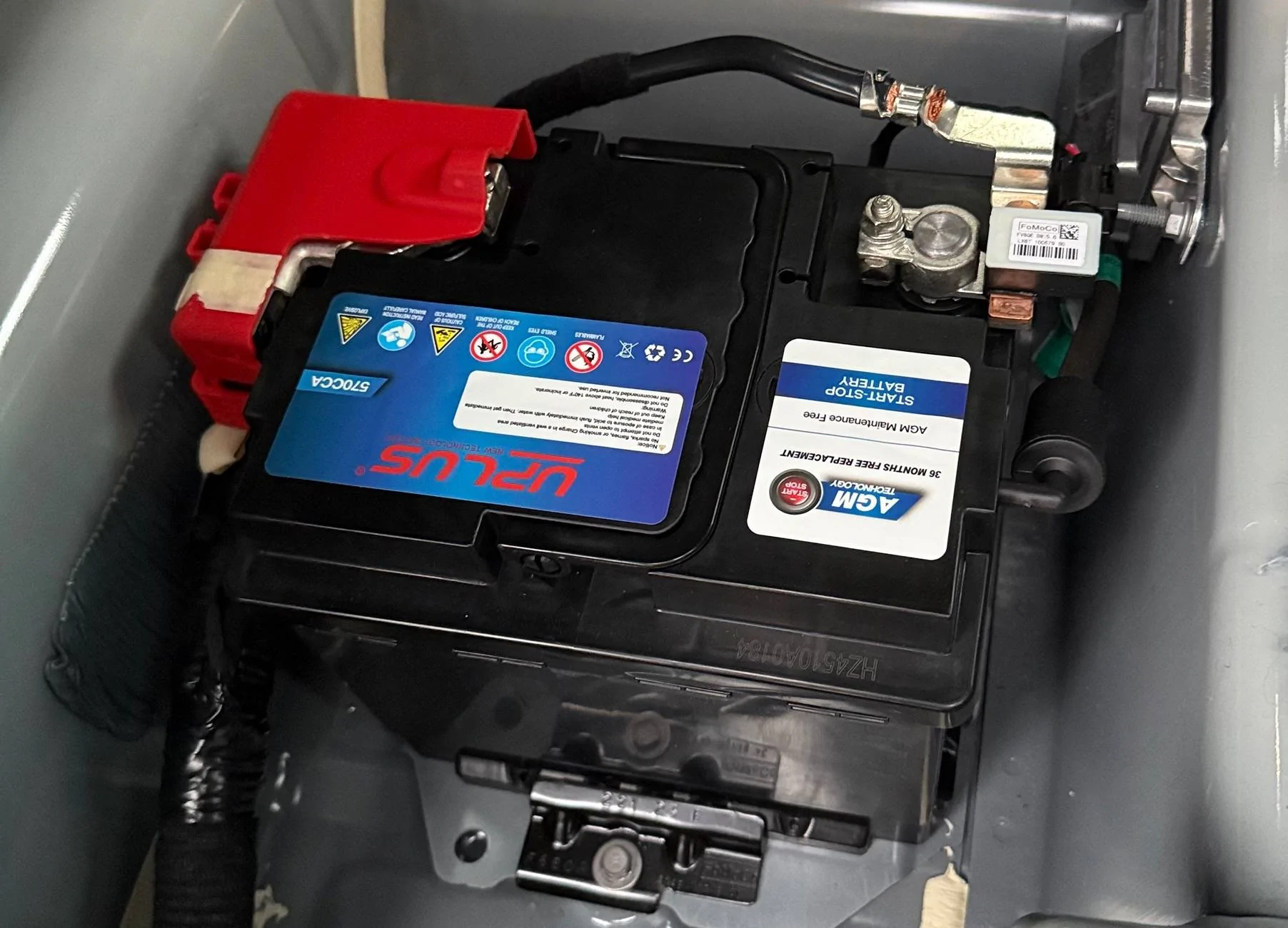

Both Sam's and Walmart's are LARGER H5. They are not just drop in. You have to remove all the plastics and bend some metal.
If you want an exact fit drop in...
Then you're looking for.👇
I put the same one in my hybrid. Fits perfectly.
Because it's an internet battery.
I asked about how the core fee was handled. "Chewy" he did not send it back. He posted that he took the old core to AutoZone and they gave him like a $15 credit.

This is the one I have. It is a littler taller than the stock battery, but it works great! I would suggest you remove the plastic around it. I didn't have to bend anything to make if fit in the flooring. Software is already set to charge an AGM battery.
The only thing you have to do is the BMS battery reset overnight count the sheep thingamabob!
