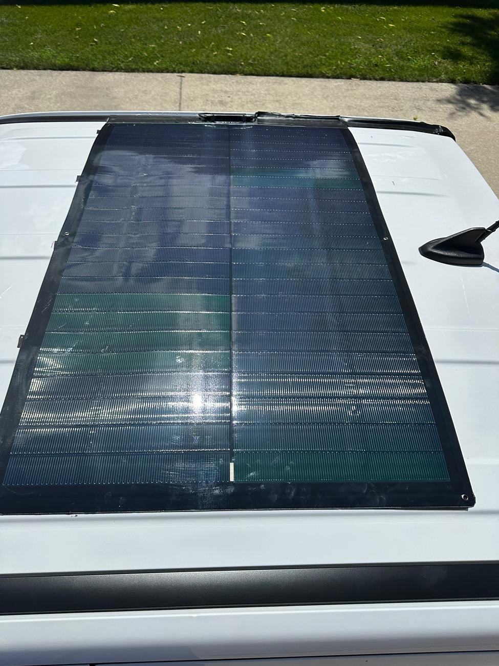

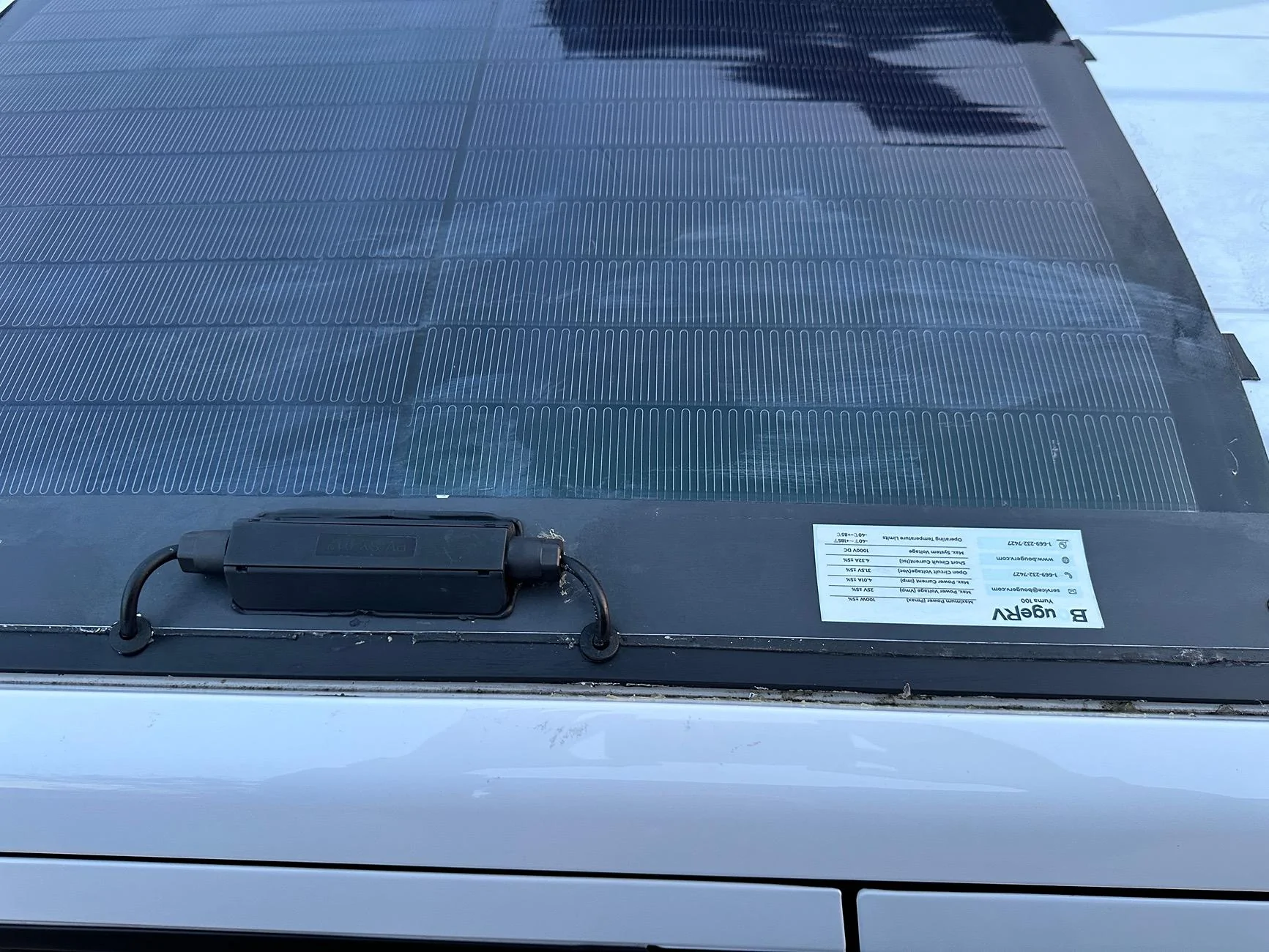

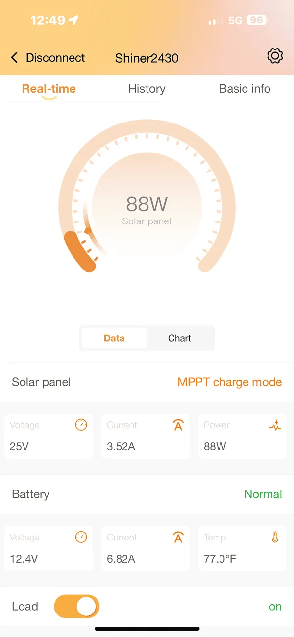

I have a BOUGE RV solar panel on the roof. Keeps the battery topped off as I’m running strobe lights during the day.
