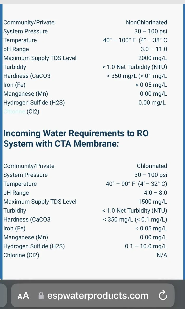

Reverse osmosis is a type of unusual filter in the sense it works in reverse, under high pressure it removes water from the junk, it does no remove junk from the water. While good, it's not perfect. It usually removes around 95% of contaminates. And has some restrictions for the incoming water as well.
