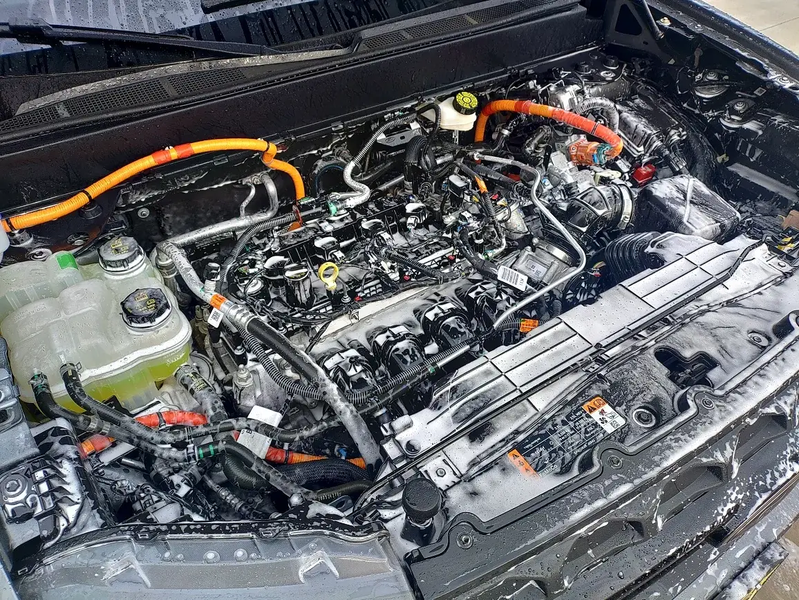

What did you use to spray? You just spray it as is, not cover anything? I'm about to buy Gunk degreaser spray bottle to clean my engine bay, but worrying if there is anything I should cover before doing so.

Been doing this since my 2015 Prius days. I use a light mixture of orange cleaner and water in a spray bottle and spray over the dirtiest places first, then I use the "spot free" rinse setting to rinse it all off. Don't use the hard power spray option. It could damage the wiring. I clean it once every 4 months.
I also did the same thing with ICE engines that I have owned over the years. Just use the "spot free" rinse and your good to go.
