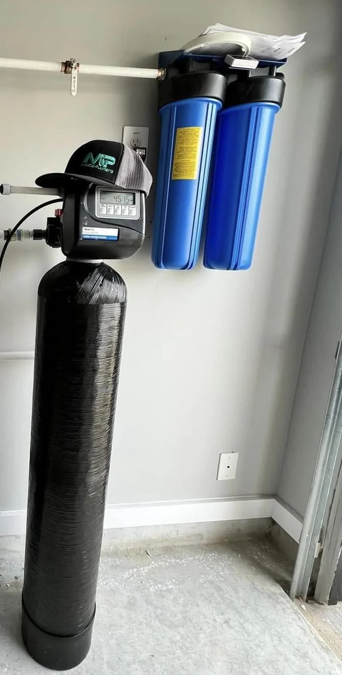

I run a 20 micron carbon into soft water, followed by a 10 micron carbon and finally a 5 micron. That is just the house feed. I have another dual filter setup at my point of use; 1 micron into a 1/2 micron. That is my "wash water." After my "wash water", I do a final rinse using reverse osmosis. I use an air gun(30PSI) and very large micro fiber cloths for drying. Always wash at first daylight to minimize heat/sun down here in Ron's Land of Freedom. Never have spots on my black cars this way. The RO final rinse is the absolute key for a spot free wash.

You are very lucky. Our water in Florida is absolute junk. Out of the tap it tastes and smells funny due to our water source being aquifers which have a lot of sulfur and other metals. That's one reason why I go to such extremes with my water filtration, I also have a few show cars that I made my setup for.

Get a CR Spotless Water System. You will never deal with water spots ever again.
Ford Maverick Water filtration for washing your Maverick ?? IMG_6798
