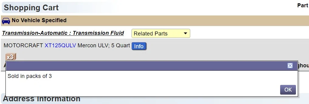

If you want to tackle it yourself Rock Auto is the way to go! Part Numbers an Pricing. I'm doing the same service and more on my Tremor soon. :crackup:
MOTORCRAFT XT125QULV Mercon ULV; 5 Quart
$34.79
MOTORCRAFT XY75WQL SAE 75W Disconnect Rear Drive Unit Fluid
$33.79
MOTORCRAFT XY75W85QL SAE 75W-85 Premium Synthetic Hypoid Gear Lubricant
$25.99
PERFORMANCE TOOL W1141 Fluid Transfer Pump
$5.63
PERFORMANCE TOOL W4034 18" Funnel
$2.12
