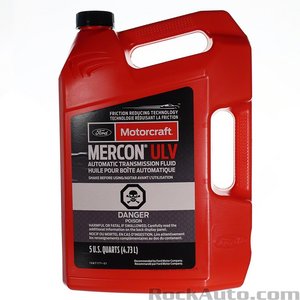

If you want to tackle it yourself Rock Auto is the way to go! Part Numbers an Pricing. I'm doing the same service and more on my Tremor soon. :crackup:
MOTORCRAFT XT125QULV Mercon ULV; 5 Quart
Ford Maverick Trans/RDU/PTU service costs XT125QULV-FRO__ra_m
$34.79
MOTORCRAFT XY75WQL SAE 75W Disconnect Rear Drive Unit Fluid
Ford Maverick Trans/RDU/PTU service costs XY75WQL-FRO__ra_m
$33.79
MOTORCRAFT XY75W85QL SAE 75W-85 Premium Synthetic Hypoid Gear Lubricant
Ford Maverick Trans/RDU/PTU service costs XY75W85QL-FRO__ra_m
$25.99
PERFORMANCE TOOL W1141 Fluid Transfer Pump
Ford Maverick Trans/RDU/PTU service costs W1141__ra_m
$5.63
PERFORMANCE TOOL W4034 18" Funnel
Ford Maverick Trans/RDU/PTU service costs W4034__ra_m
$2.12

What quantities are you buying? My local guy will let me source the fluids, looks like the PTU is good with 1 qt, the RDU may need a little more than a quart (so a 2nd one), and a drain & re-fill on the trans looks like just over 5qts.

Nice, I would go Rock Auto for sure then! Based on my research, checking the factory spec sheets, and talking to a local Ford dealer, you don't need a second bottle for the rear diff. 1 bottle of each gear oil is plenty.
I’ve seen a ton of conflicting information online about the fluid amounts, but that's usually because people confuse the total "dry factory capacity" with what actually comes out during a standard service. Just a heads up, I haven't physically done the service on my own Tremor yet (planning to soon), so definitely verify your levels as you fill!
Here are the spec capacities for a standard drain and fill:
  • PTU (Front): The unit is tiny. It only drops around 13 oz. (1 Quart of 75W-85 leaves you plenty extra).
  • RDU (Rear): The total capacity is 28 oz. (1 Quart bottle is 32 oz, so it fills it right to the brim with 4 oz to spare).
  • Transmission (8F35): The total dry capacity is around 8.5 quarts, but a ton of that stays trapped in the torque converter. A standard pan drain-and-fill only drops about 4.5 quarts. (The 5-Quart jug of Mercon ULV covers it perfectly).
Here is the part number breakdown from my order if you want to copy them:
  • MOTORCRAFT XT125QULV Mercon ULV; 5 Quart — $34.79
  • MOTORCRAFT XY75WQL SAE 75W Disconnect Rear Drive Unit Fluid (1 Qt) — $33.79
  • MOTORCRAFT XY75W85QL SAE 75W-85 Premium Synthetic Hypoid Gear Lubricant (1 Qt) — $25.99

Thanks! HRG
