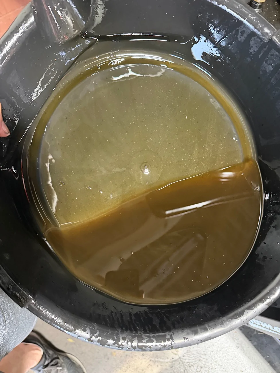

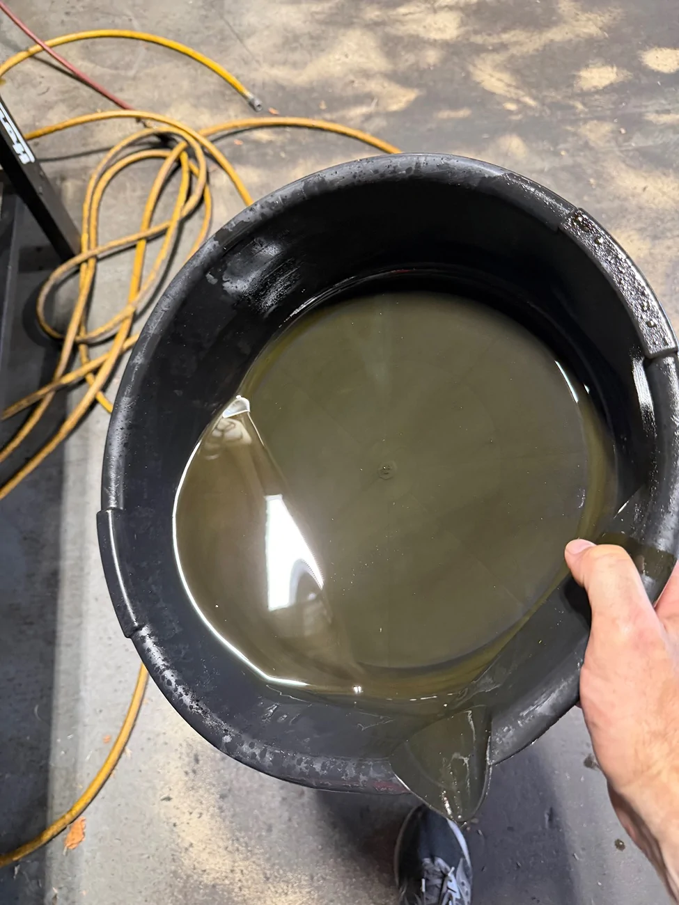

I planned a trip to Florida towing my 2500lb camper. Decided I should service the transmission, RDU, and PTU before the trip. Glad I did. The truck had 38k when I performed the service. Transmission fluid looked fine but the RDU and PTU fluids looked like liquid metal. Like many other people’s opinions, I highly recommend you service these items before 30k miles. Both units seemed underfilled and obviously very metallic. This is a 2023 Maverick, Ecoboost, FX4, 4k towing.

I did my wife's Bronco Sport PTU and RDU at 15K miles and it looked a lot like what you showed. Recently changed it again at 30K miles and the fluid looked almost pristine and probably could have gone a lot more but showed that first change out is pretty important.
Probably will do my Maverick Hybrid AWD at 5K miles and then every 15K to 20K miles after that.

When I did my first PTU and RDU service at 25k miles, the fluids looked just like that.
As @Hootbro mentioned above, when doing my second service yesterday at 50k miles, the PTU and RDU fluids looked essentially brand new. Which was very surprising, but great to see!

Quick! Store the drain oil in clear mason jars, let it sit for a week, then see if any water separates out.
I definitely should have, but it was a few weeks ago and the fluid is long gone. If I was still active duty I would have taken a couple samples over to NDI for oil analysis, would be interesting to see the results.
besides being dirty is that metal in there try putting it a magnet in it.

Wondering if it’s PEMEX lube oil?
I would have sent it for sample analysis.
My truck approaching 10 k miles. Might bring it in for tranny, and drive check, change.
