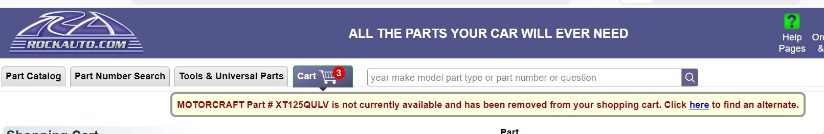

Damn! Trans fluid is out of stock!
Oooh not good! They have the quart bottles a bit more money but in stock. After this post RA will be out of 5qt an qt bottles lol. :crying:
MOTORCRAFT XT12QULV
Hahaha, too late!

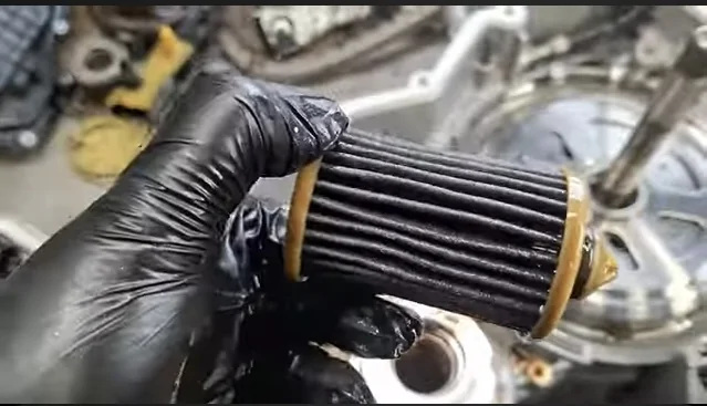

Here is a pic of the filter in our 8F35 transmissions. Requires removal of transmission and then disassembly to replace. Going to drain & fill my transmission fluid DIY often since that filter has to last a lifetime!

When I did my draining fill on the transmission it cost me $40 for the fluid and maybe took 30 minutes taking my sweet time.
It will take me 30 minutes just to jack my truck & remove the the 15 cover screws:)
Is there a trick to the refill? I hear the 4-5 quarts pour in really slow.
Including breaks - I plan on a 3 hour DIY job. I pay myself by the hour so no need for me to rush. Paid breaks too. I’m a great boss!
