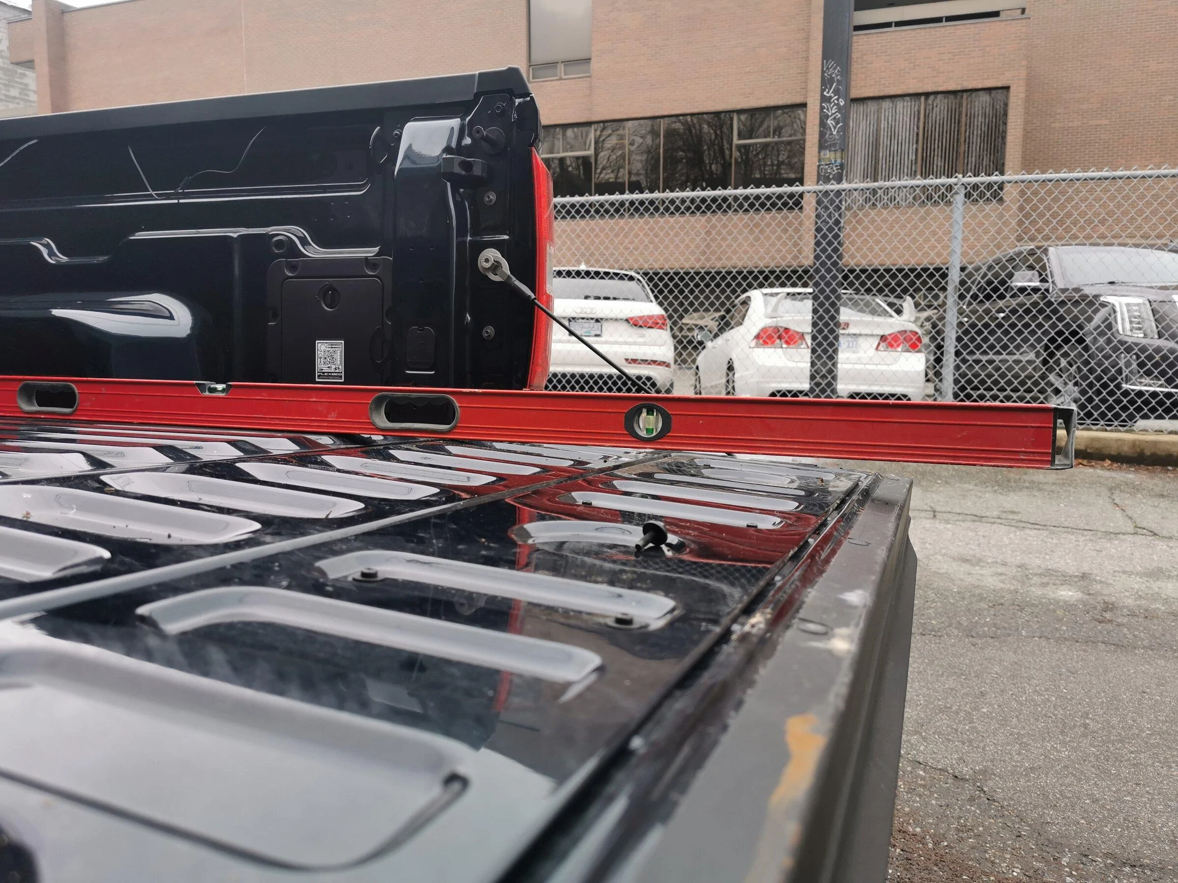

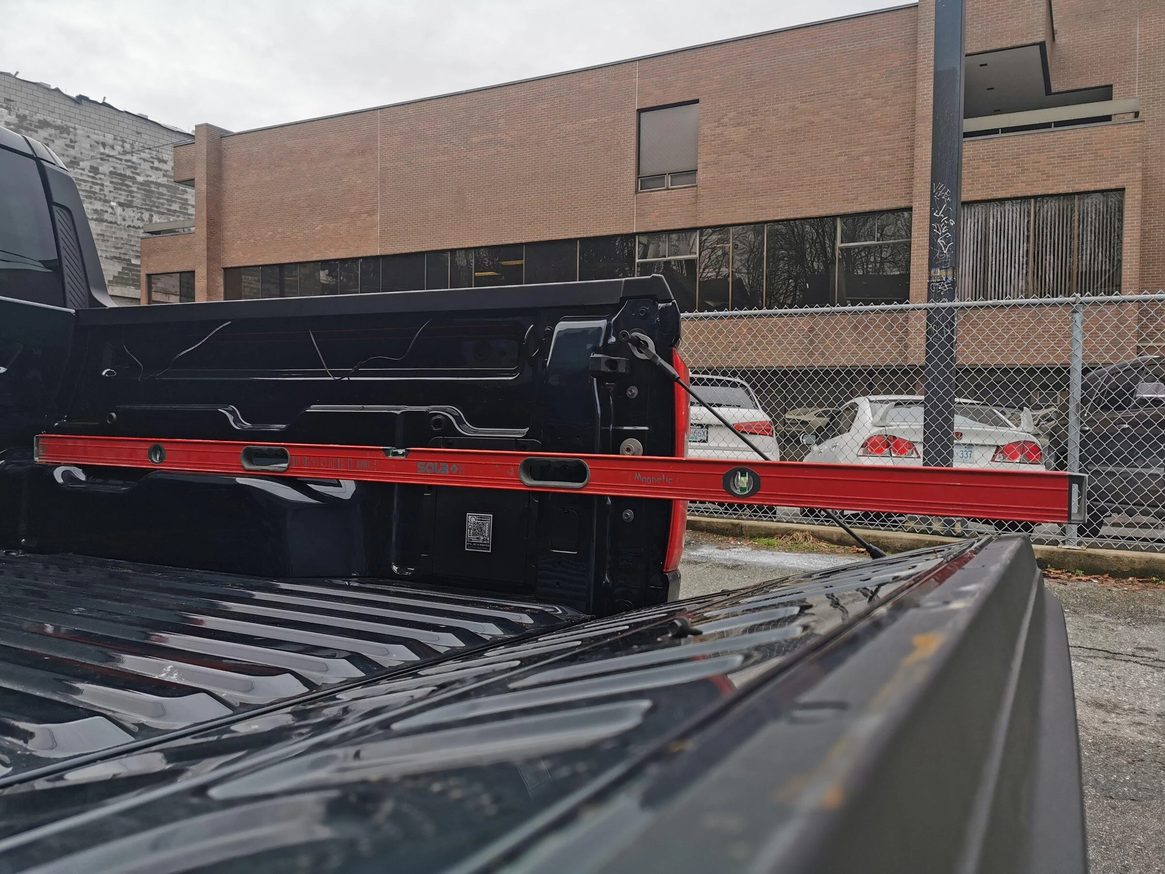

As the title suggests, the cables are too long and the tailgate is not level with the bed. It is also not level with the wheel wells when in the half-up position.
People have pointed this out before reacting to pictures and I assumed it was optical illusion but my Sola don't lie.

I bet either the designer screwed up cable length or the manufacture of cable did. I bet someone interpreted the cable dimension wrong. They included something in the assembly thinking it was cable measurement. Just a guess.
I wouldn't be surprised if the original cable length was done in imperial measurements, but the manufacturer uses metric measurements! If I remember correctly there was a NASA mission that got screwed up because of this very problem!

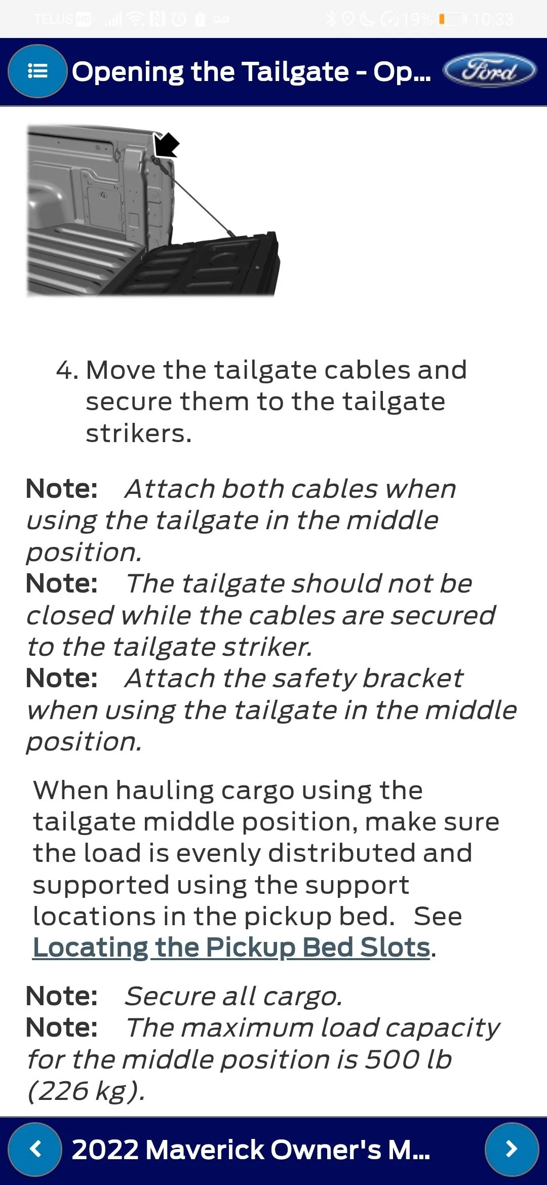

500lbs middle position according to manual.

FWIW: I seem to recall reading here many months ago (before any retail trucks delivered) in a topic involving the unique Flex bed design considerations that the slight offset is done intentionally by Ford. This was many months + thousands of posts ago- so I wouldn't know where to begin looking for it. I do not frequent any other Maverick forums or message boards, so I know I read it here. Could of been in a Ford issued informational posted here by Admins or an article published elsewhere and posted here- can't remember that specific detail. I didn't think anything of it at the time as it was a tiny detail in the massive amounts of Maverick information flooding the interwebs. Maybe someone with better search skills and more time and patience can validate or disprove my memory. I could always be wrong on any topic o_O
I have a suspicion the manual has a typo, because it doesn’t list both fully down and lifted load amounts.
You may be thinking of the thread about one cord being taut, and the other loose a little by design; this is to allow slack in one so that it can be more easily pulled off the lowest position I believe. Although I don’t really see the sense in that since you still have to lift the gate to get it to it’s upper position.

Not sure which is right or wrong in this discussion, but one of the first Maverick videos I watched was from a Ford Customer Communications Manager showing the bed and tailgate. He uses terms such as "flat", "level", "aligns with wheel well" when describing the tailgate position which tells me it should line up.
If you have a balanced load at 500 lbs rating it will carry its share of the load in the lower position with a 1500lb +/- payload but as soon as you put it in the middle it has to carry more of the load with calculations needing to be made for the angle and the amount of load hanging over the edge.
I had to contemplate this the other day. I loaded 30 2x6 10'. The math sais they weighed about 475lbs. I was like "ok how do I know how much of the load is on the tailgate in the middle position." I decided I will make a cross support that planes out with the tailgate at that angle, if that makes any sense, to share more of the load and then I could at least double the amount to carry 60 2x6 10'. Once you get a visual idea of what it will haul, in a certain material (spruce in this case) it's easy to guess. Note that rating are usually a fraction of the actual failure point as well.
