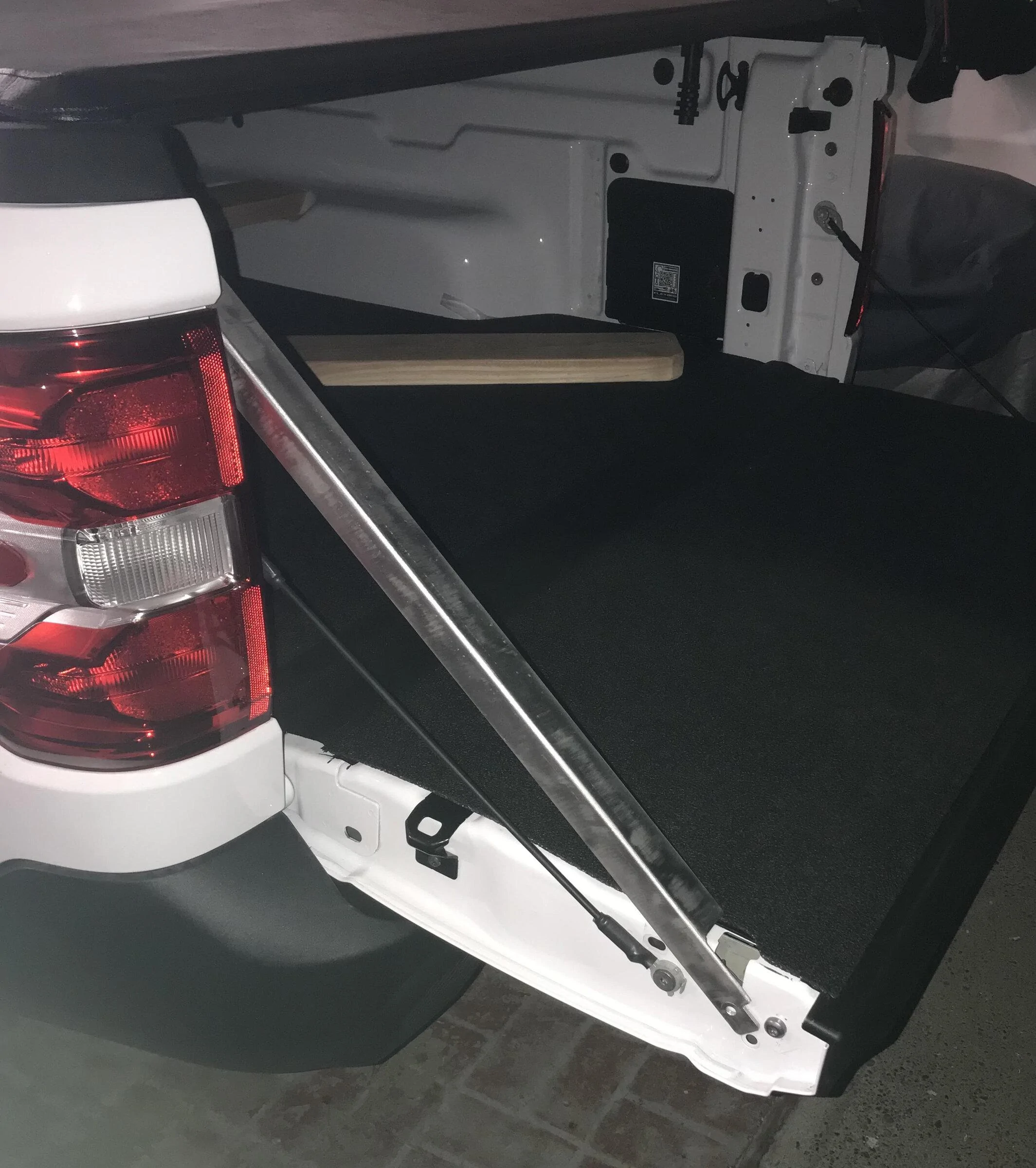

Picture of support with bottom not attached gives you an idea that the tailgate will have to come up some for the bolt to line up. Once the bolt is out it is easy to align the holes. Yes, I made them so the tailgate will be level when in use. The factory straps will not be supporting any weight but still attached for safety.

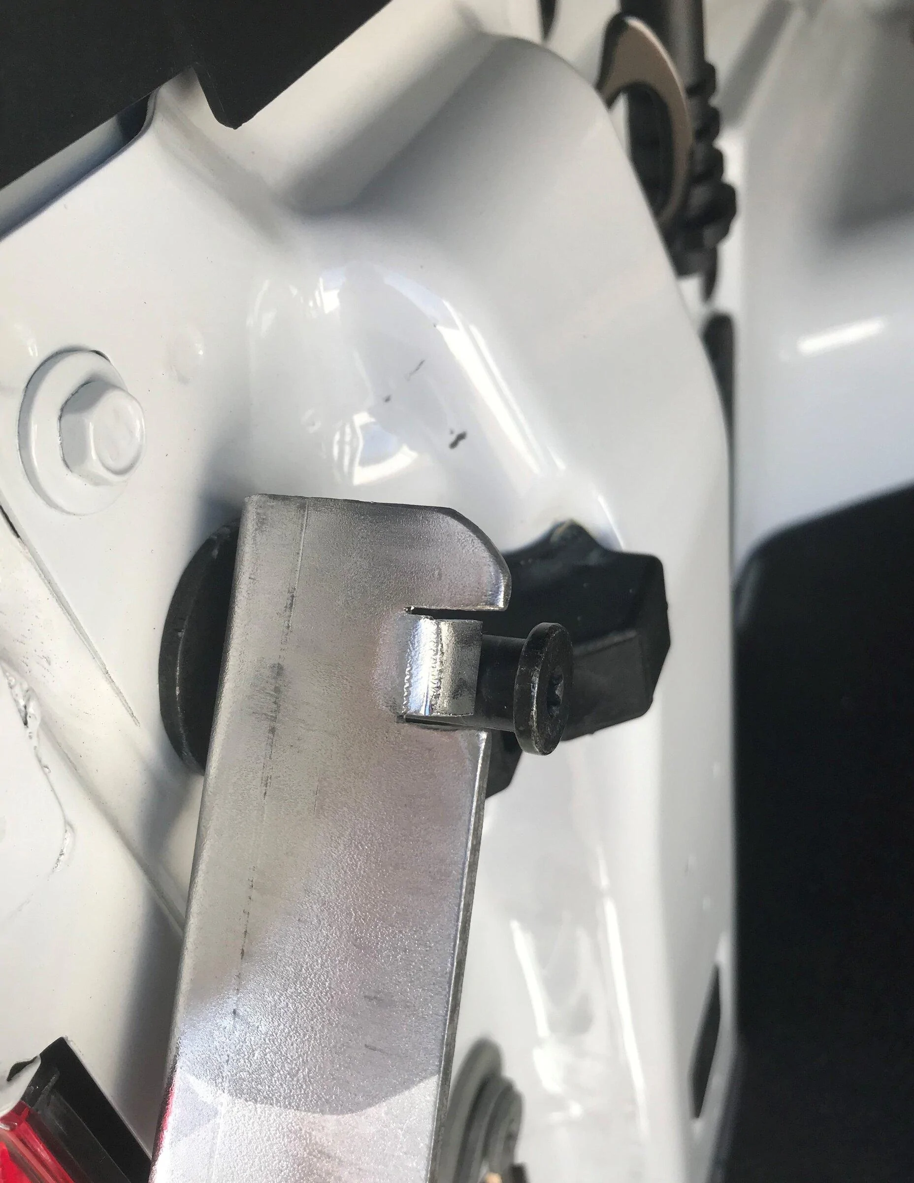

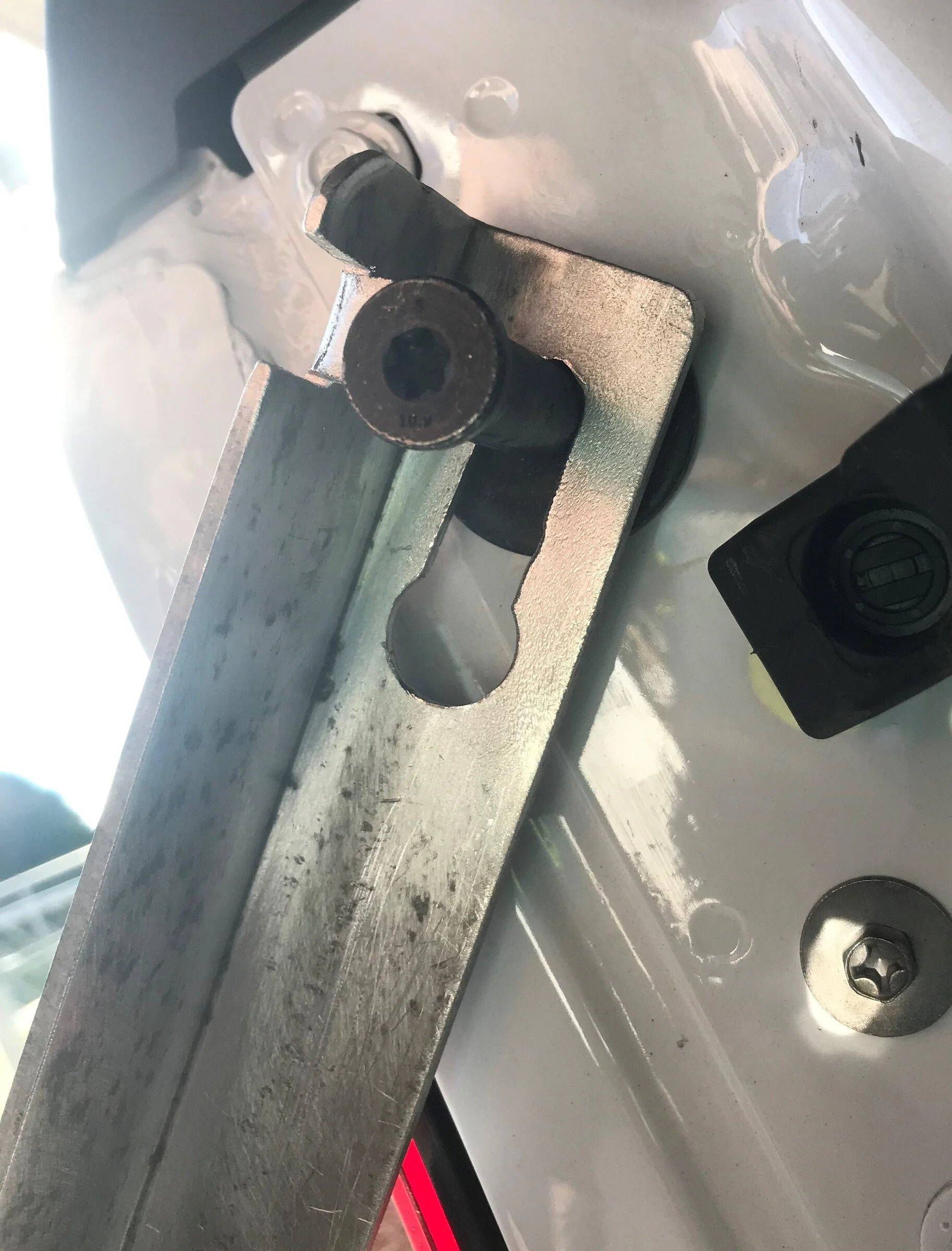

These pictures show how I made the top attachment. They slide on then down prior to bolting the bottom in place. The bent over tang keeps the top part from moving toward the large end.

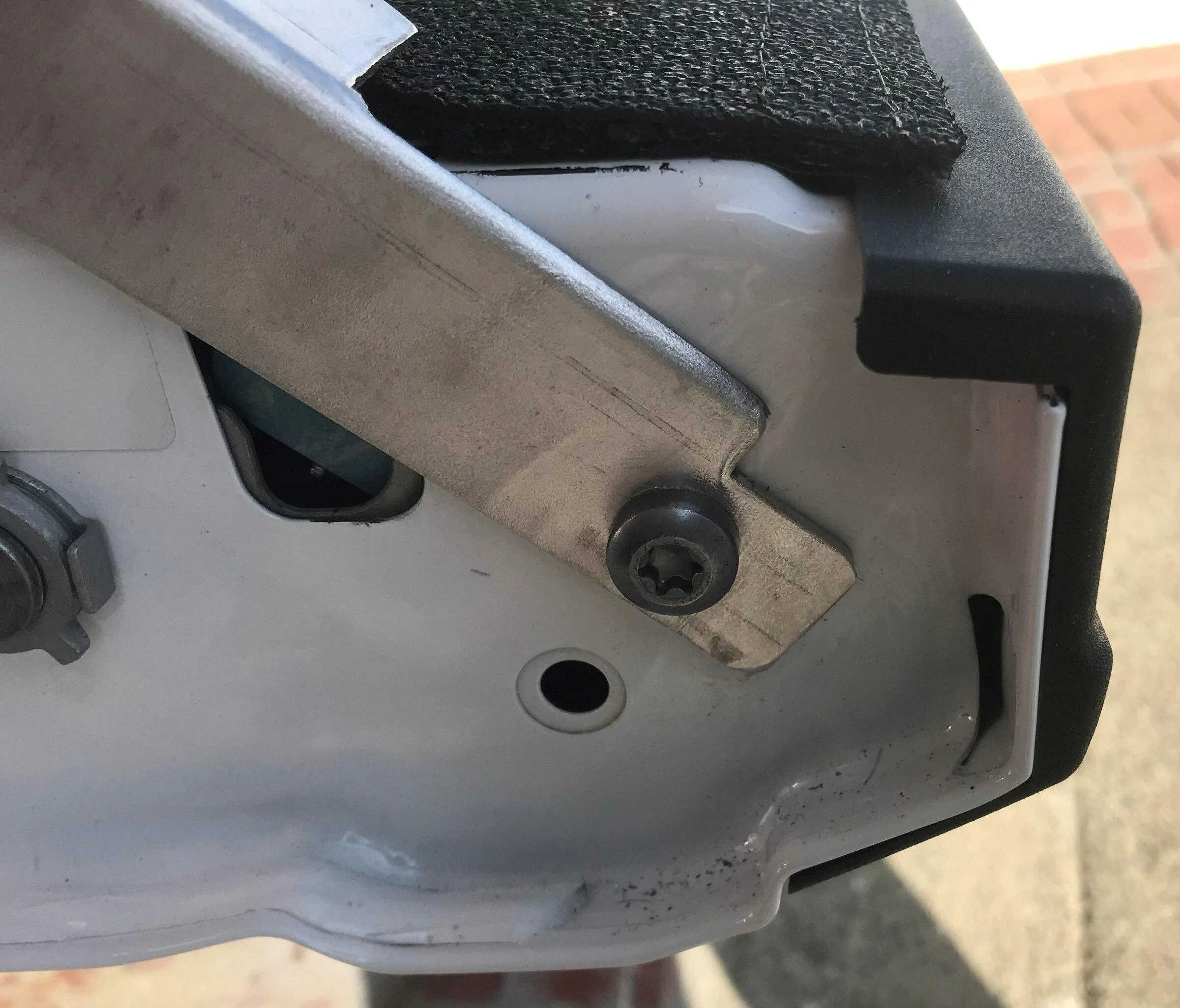

The bottom end has the top cut to clear the bed and duct tape on the inside to protect the paint when bolted in place by the one of the tailgate bolts that holds the tailgate latch in place. At star Allen head tool is required to remove the bolt and tighten it back down. The material was already narrowed at this end by the bolt but should still be plenty strong.
