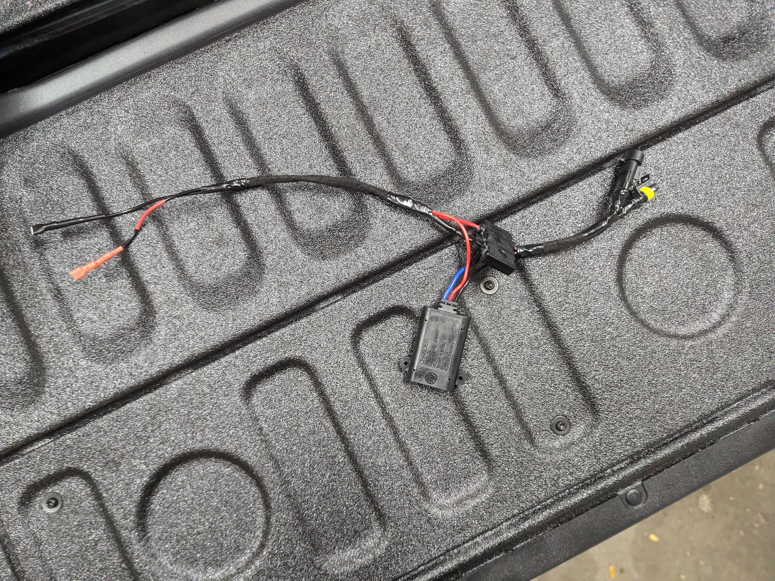

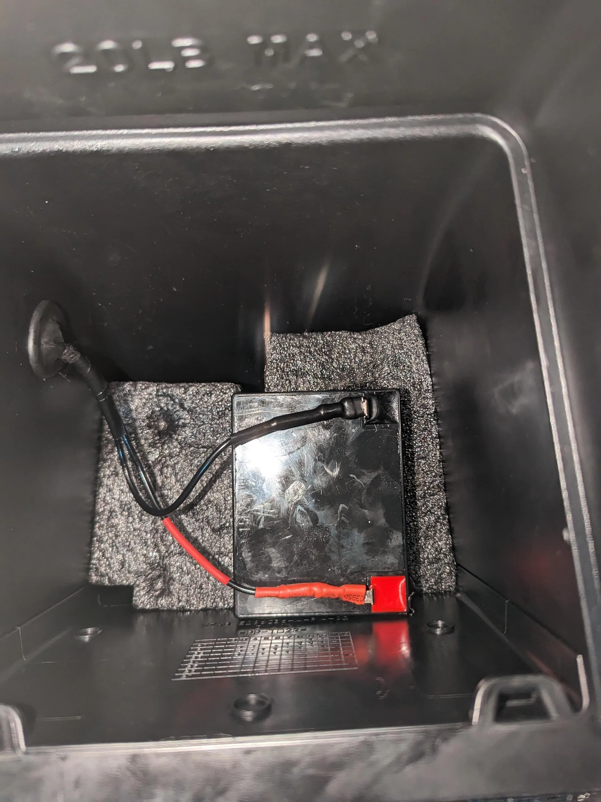

I thought I should post an update to this with the changes I made to my setup. I decided to add a battery that can power the lights when the key is not in the ignition as well as a 12v-12v charger to keep it topped off. Having to have the key in the ignition for the lights to work was really annoying and as I've had deep sleep issues already without the lighting I didn't want to draw on the trucks 12v battery. So far I'm really happy with the setup though it was definitely more involved than I originally intended when I started.
Battery in cubby, foam blocks to wedge in place
Harness with 12v-12v charger
Battery: https://a.co/d/bOIJ60h
Charger:https://a.co/d/5DG79l8
