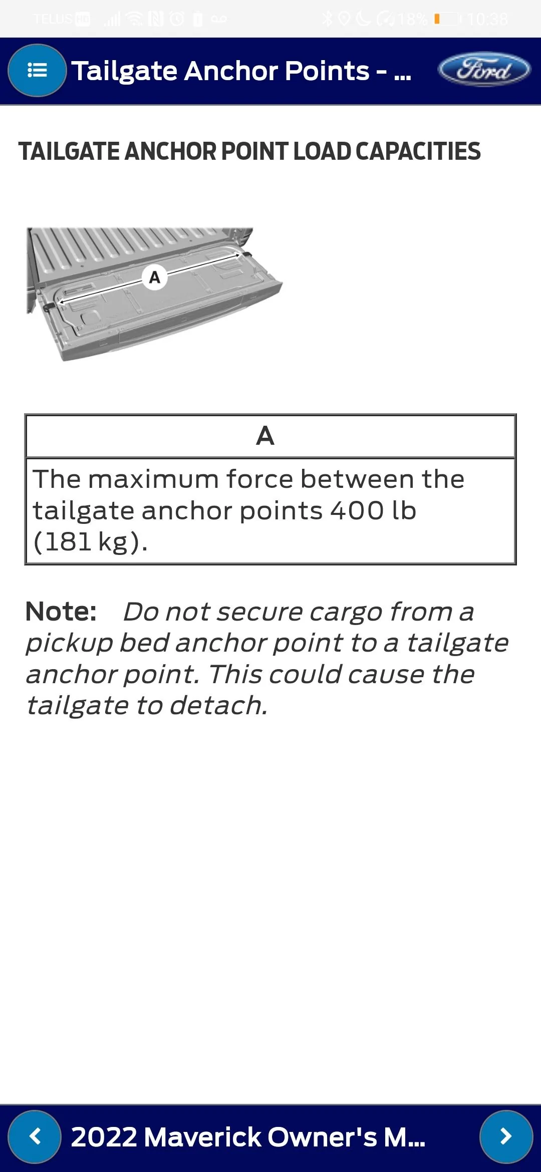

Either way at 1/3 of the length of the box plus tail gate it is rated at 1/3 the payload. It is "rated" to carry weight not dangle in the breeze.
