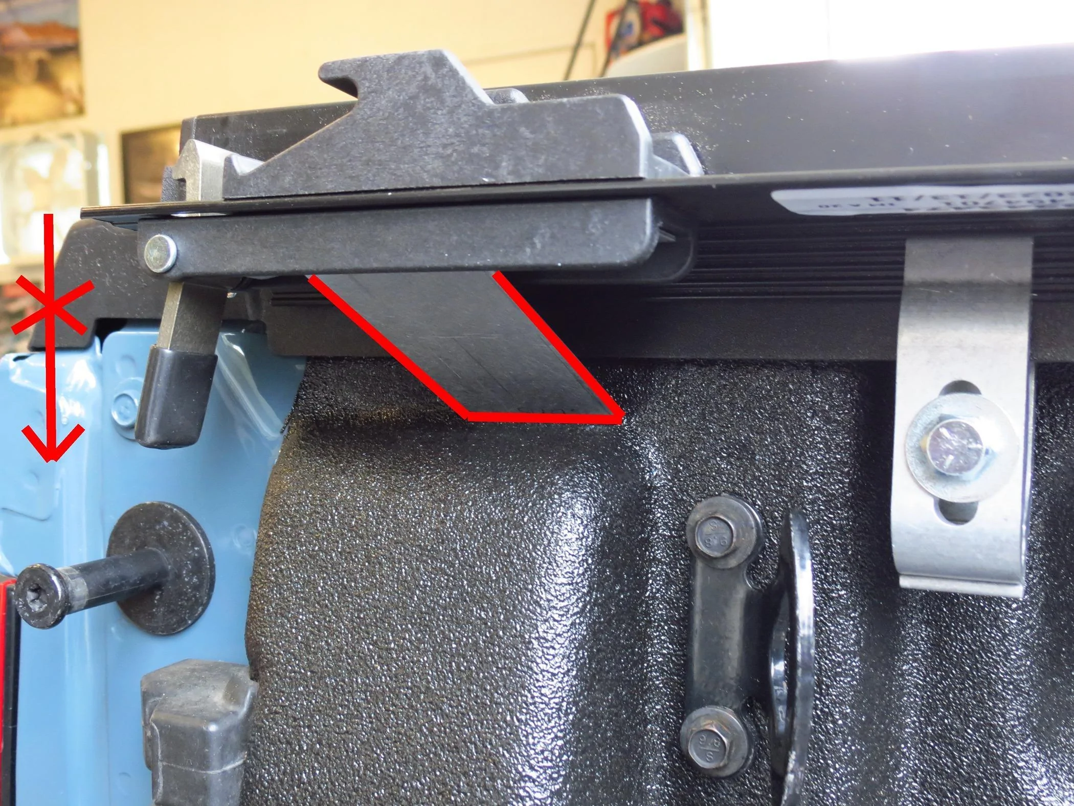

I think I ran into a similar behavior. Instructions say to have the cover unlatched when closing the tailgate, and then press the cover down to latch it for the best weatherproof seal. This wouldn't reliably work on mine and it sometimes refused to latch. It seemed like pushing down on the cover pressed the entire side rail with the latch in it downward very slightly due to the latch's stiff spring. Then when trying to latch it by pressing the rear cover bar downward, it contacted the gate top and couldn't be pressed down any further but the latch still hadn't clicked & engaged.
Here's how I fixed it. I cut a 4" piece of stiff scrap aluminum (in red) and slid it between the latch bottom bracket and bed side. This was enough to keep the rail from flexing downward a couple of millimeters and the latch now worked reliably.
More info & pics on this install on page 7 of my build thread (whole thread is here).
Very interesting. I did contatch truxedo customer support. They told me to close the cover then the tailgate. Which is not correct. But now after being on a few days seems ok. So that shim is similar to a cross type support. May have to revisit that thanks
