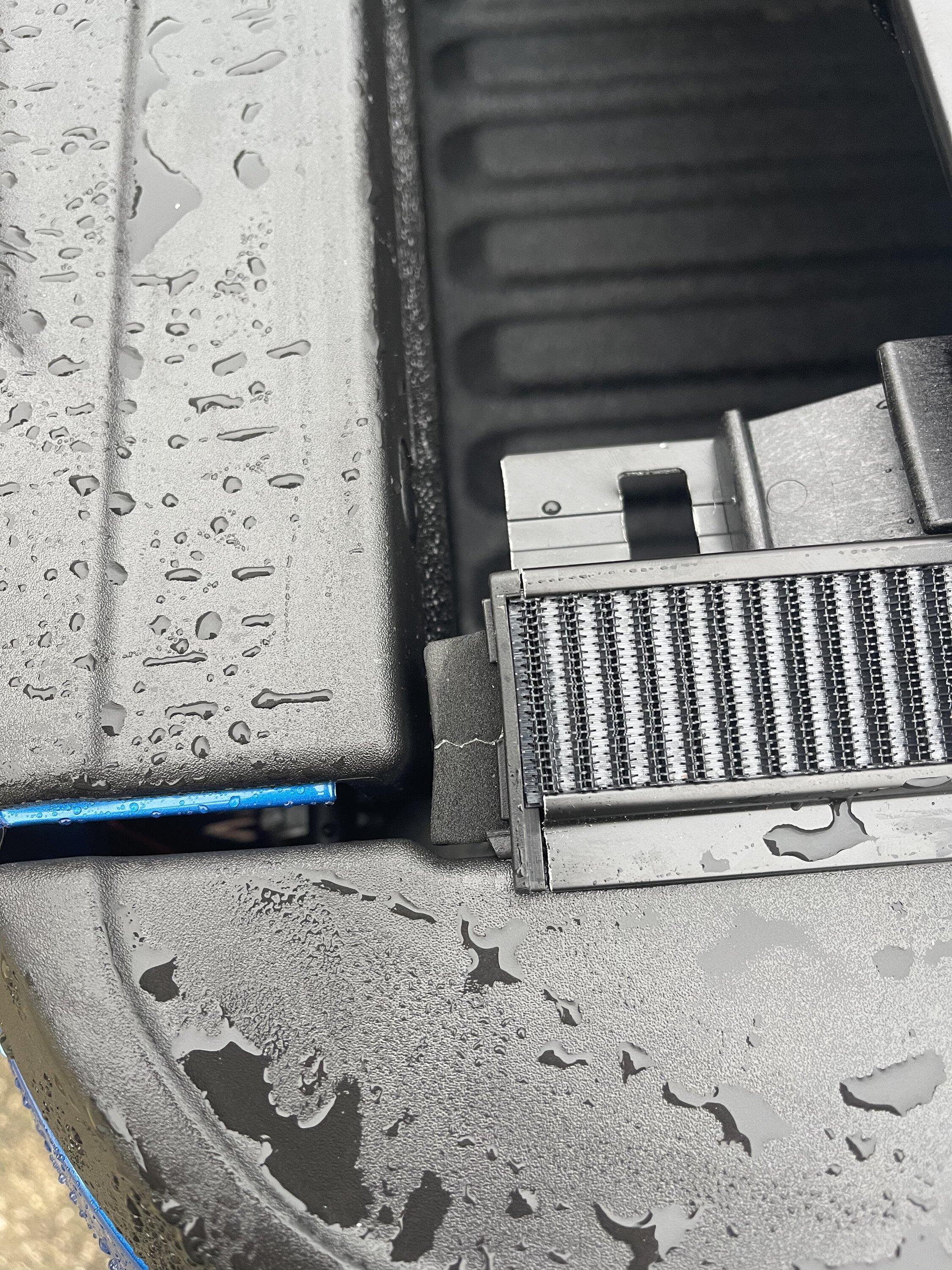

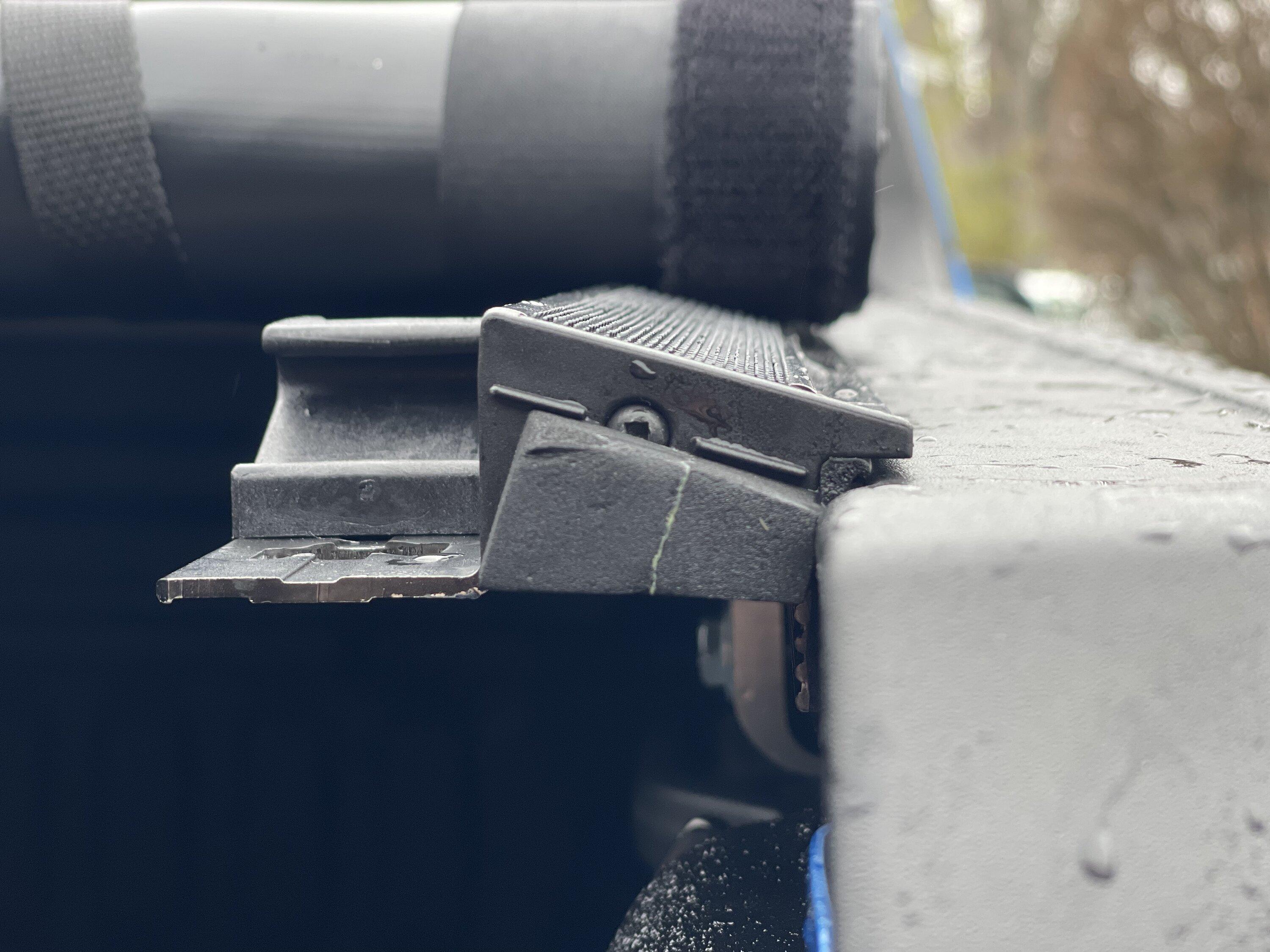

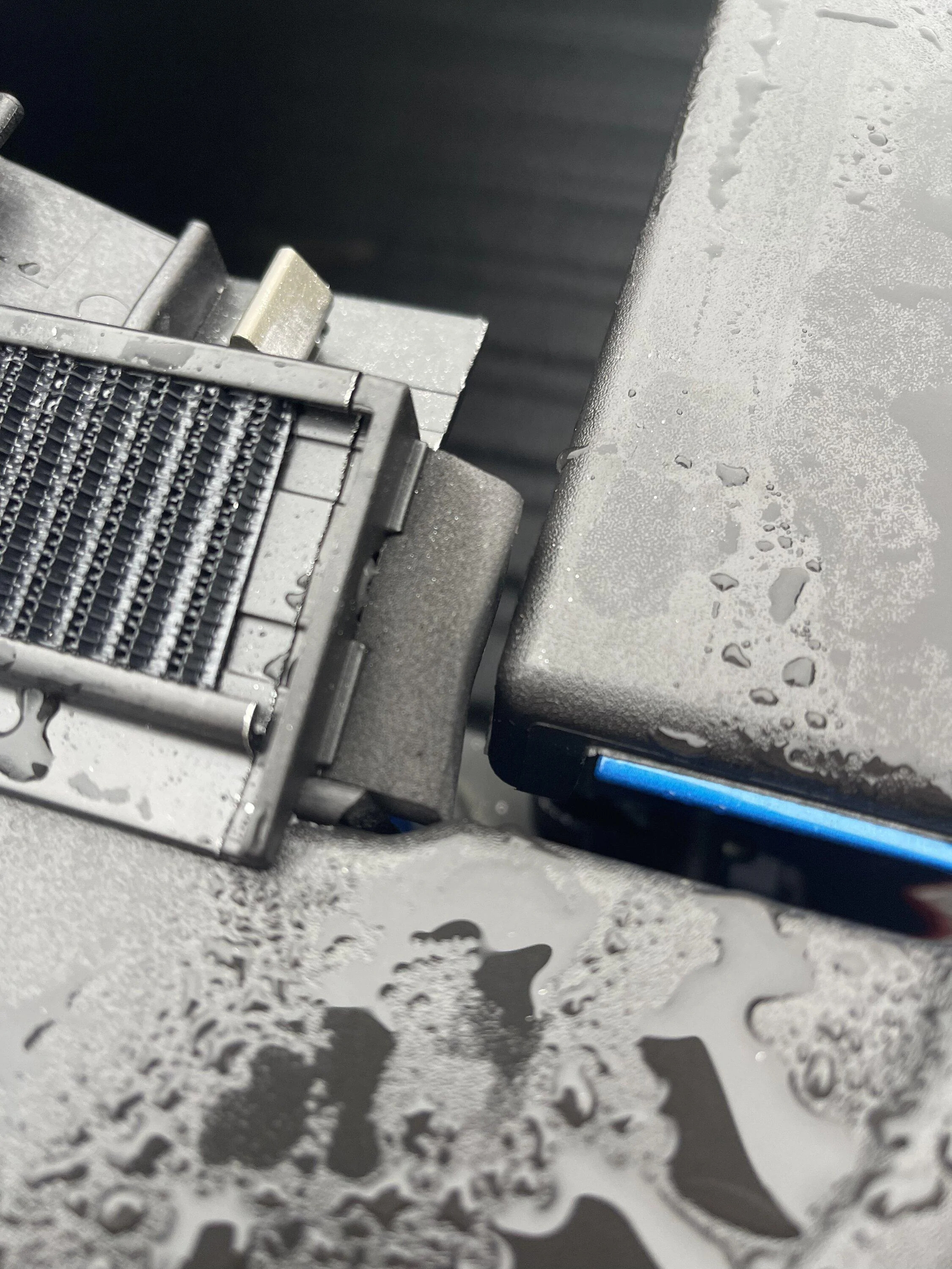

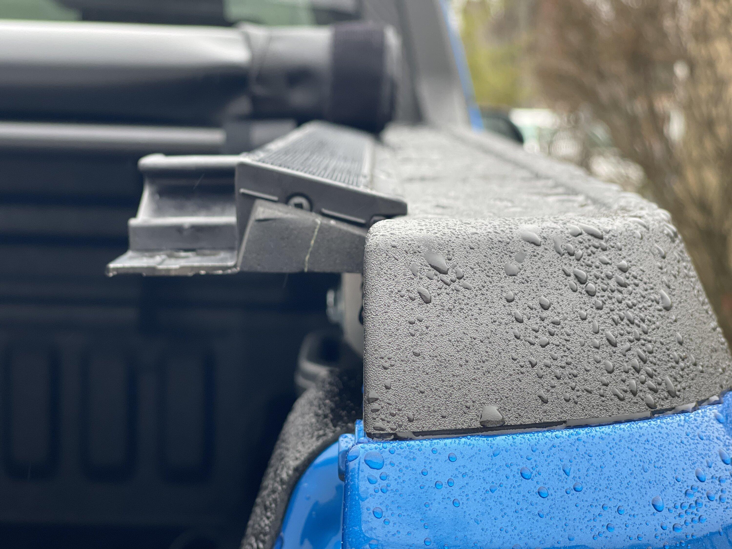

Anyone know how to adjust the x15 pro to allow the cover to be closed/latched with the tailgate up? I just installed my cover yesterday and I can not get it to close with the tailgate up.

Just a guess but maybe the cover needs to move towards the cab. Mine will close either way but I always open the cover to shut the tailgate so that the rubber seal will be on top of the gate to better shed water.Anyone know how to adjust the x15 pro to allow the cover to be closed/latched with the tailgate up? I just installed my cover yesterday and I can not get it to close with the tailgate up.

I tried moving them towards the cab and it didnāt resolve the issue. Super bummed.Just a guess but maybe the cover needs to move towards the cab. Mine will close either way but I always open the cover to shut the tailgate so that the rubber seal will be on top of the gate to better shed water.
I readjusted back by the tailgate like you suggested, I raised it to where itās higher than it should be now to try to compensate to get it to close with the tailgate up.You have the rails too low or angled. readjust the rail at the tailgate end a little higher as already suggested.
While you are at it move the rails back where you had them, That rear foam pad should have an 1/8" of compression not a gap as your pictures show.

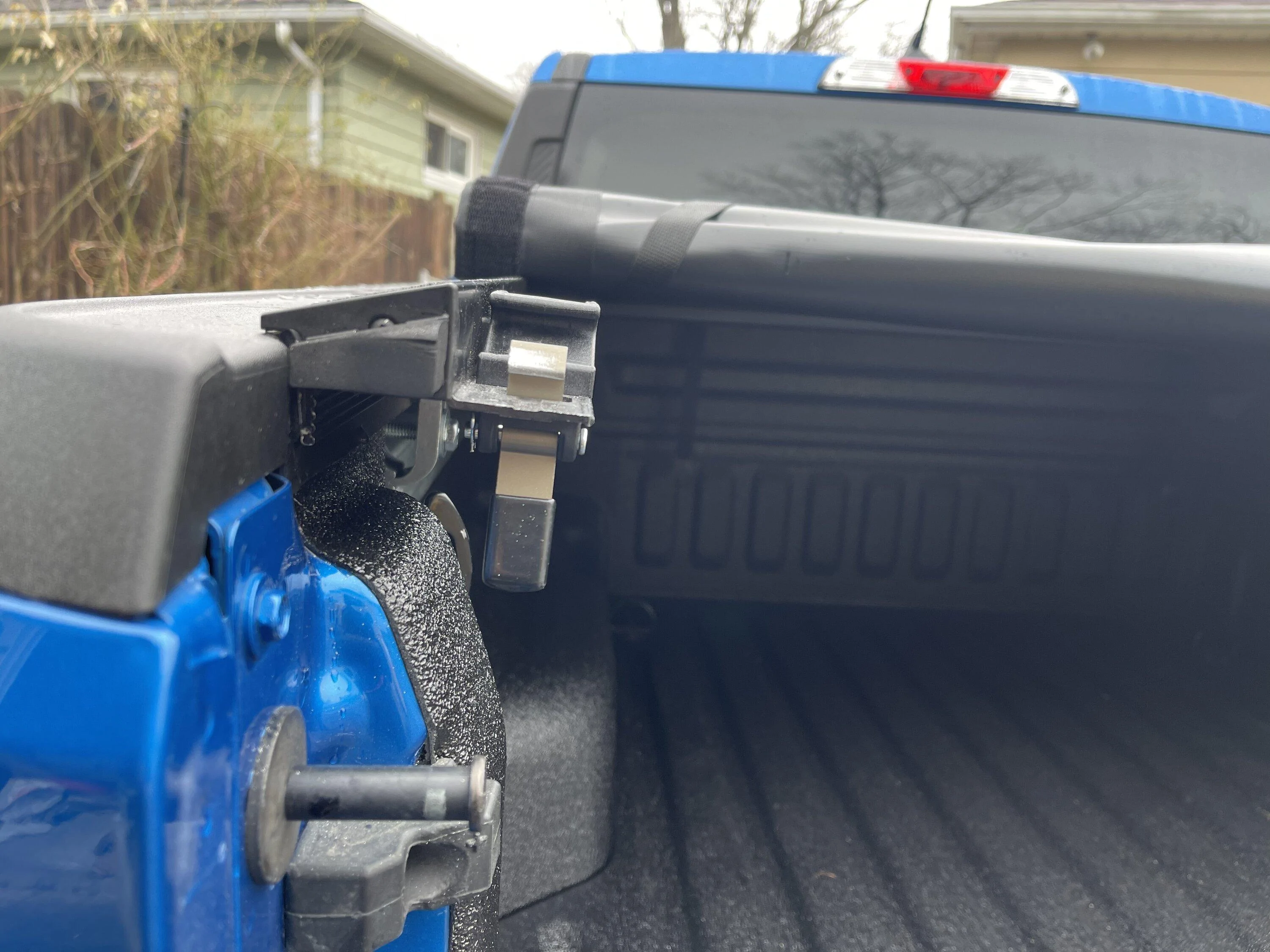

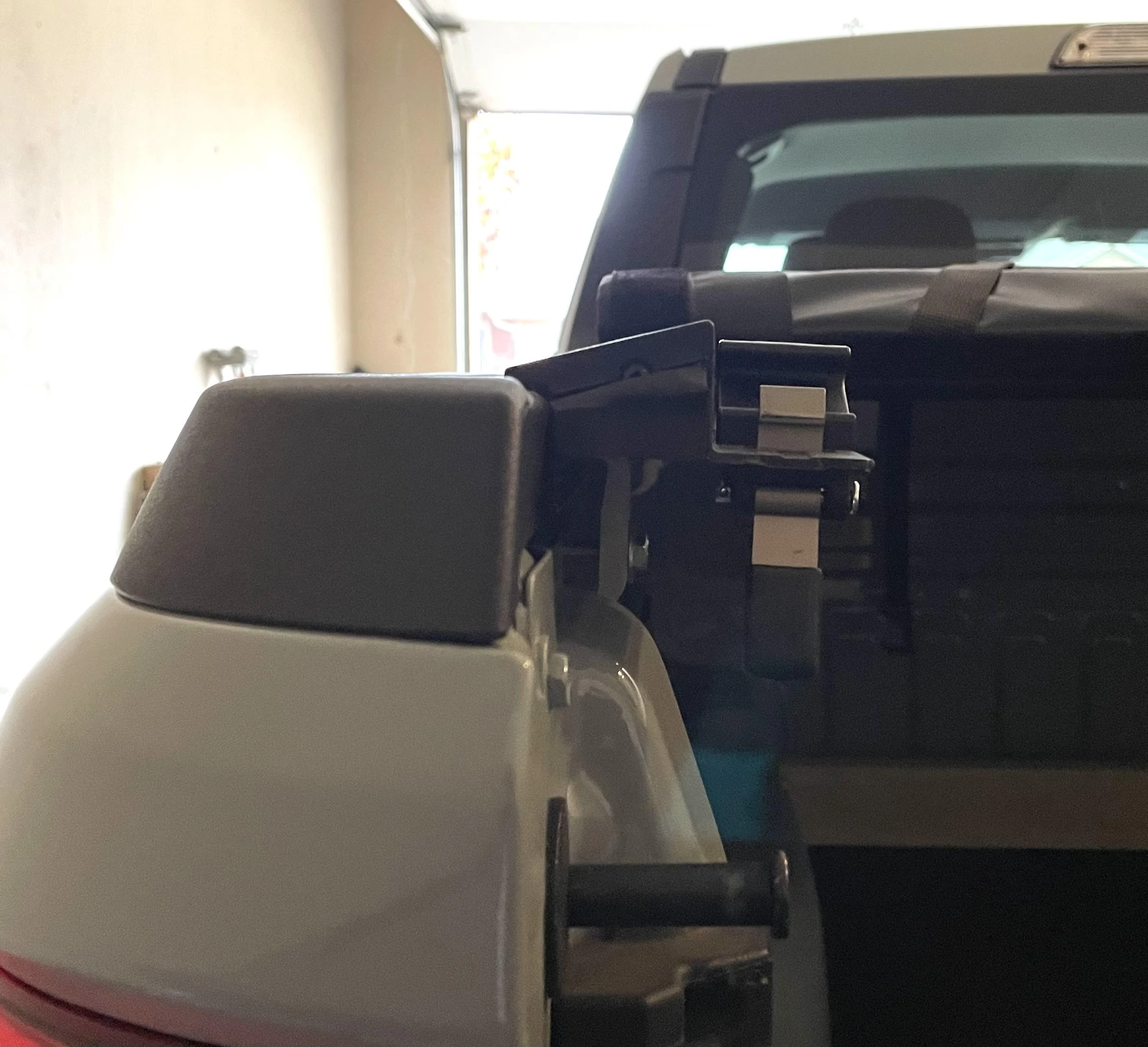

Looks like this.The latch is on the driver side, how does it look? I had the same thing and needed fiddle with the angle to get it right. I also backed off the tension adjuster a bit.
What do you mean? Are you saying the tension adjustment screw needs backed off?Looks to me like it needs to rotate a bit counter clockwise
