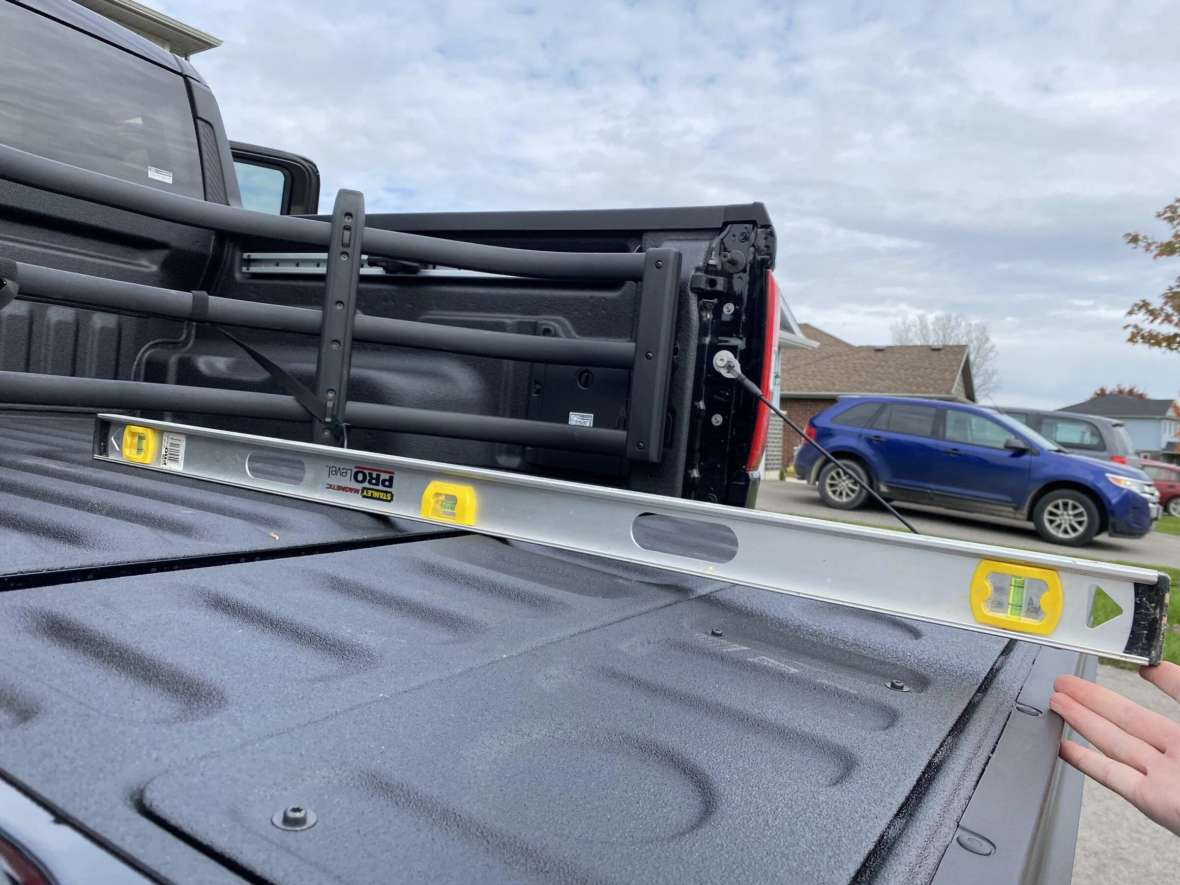

Regarding the Maverick, has anyone put a metric protractor on it to verify level?
Bmckenz
Brendan
Oct 23, 2021
ON, Canada
2022 Maverick Lariat 2.0 AWD
Yeah, the chute/retro rocket fired at -200 feet due to unit conversion oversight, or lack of.
metric level right here haha (I am in Canada)

As the title suggests, the cables are too long and the tailgate is not level with the bed. It is also not level with the wheel wells when in the half-up position.
People have pointed this out before reacting to pictures and I assumed it was optical illusion but my Sola don't lie.

Maybe there's a cable available that's a 1/2" (or so) shorter? When I was a kid, I worked at an auto parts store, by now I'd have 10-20 out on a counter comparing ends and OAL.
https://www.oreillyauto.com/shop/b/hardware---fasteners/cables/tailgate-cable/d3490ab12197
HRG
Yeah I might do a little research on some other cable options.

Here is what Dorman has to offer.
https://www.dormanproducts.com/c-694-tailgate-cables.aspx
The closest would be the 21" but I am not sure if they are measuring center to center or end to end. It's also for a 350 super duty so it might be for beefier hardware. Amazon.ca sells singles for 11.99. I will order one and report back.

I did look at Gate King but it looks like too many moving parts for my liking. At that price I would probably just fab something lik the DG braces I posted earlier.
