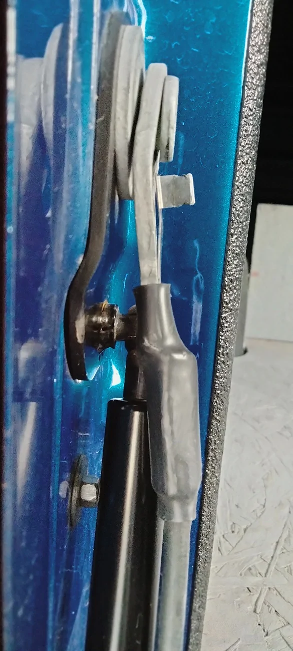

The attaching end of my23 cable has a small bend in it.
Ford Maverick Tailgate Assist Strut - Binding with the tailgate cable IMG_20260225_093159

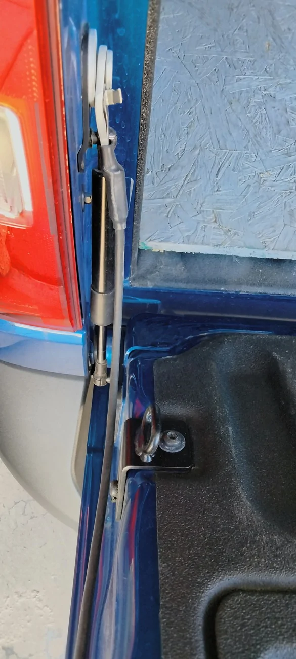

Rick I replaced the driver side tie down with one made from one of our members.
Ford Maverick Tailgate Assist Strut - Binding with the tailgate cable 0001
That's me (thanks Glen!). Yes, when you install the tailgate strut and remove the factory tie-down bracket which now interferes with the strut, you lose a useful tie-down point. I made a replacement tie-down for mine.
Ford Maverick Tailgate Assist Strut - Binding with the tailgate cable 236269-5d38332d1e5f7e8761f1030b274d31c5
Works well and clears the new strut and no issues with the cable. Enjoyed making it enough that I keep making more. I have a thread here in the For Sale forum if anyone would like one. Don't lose a tie-down point!

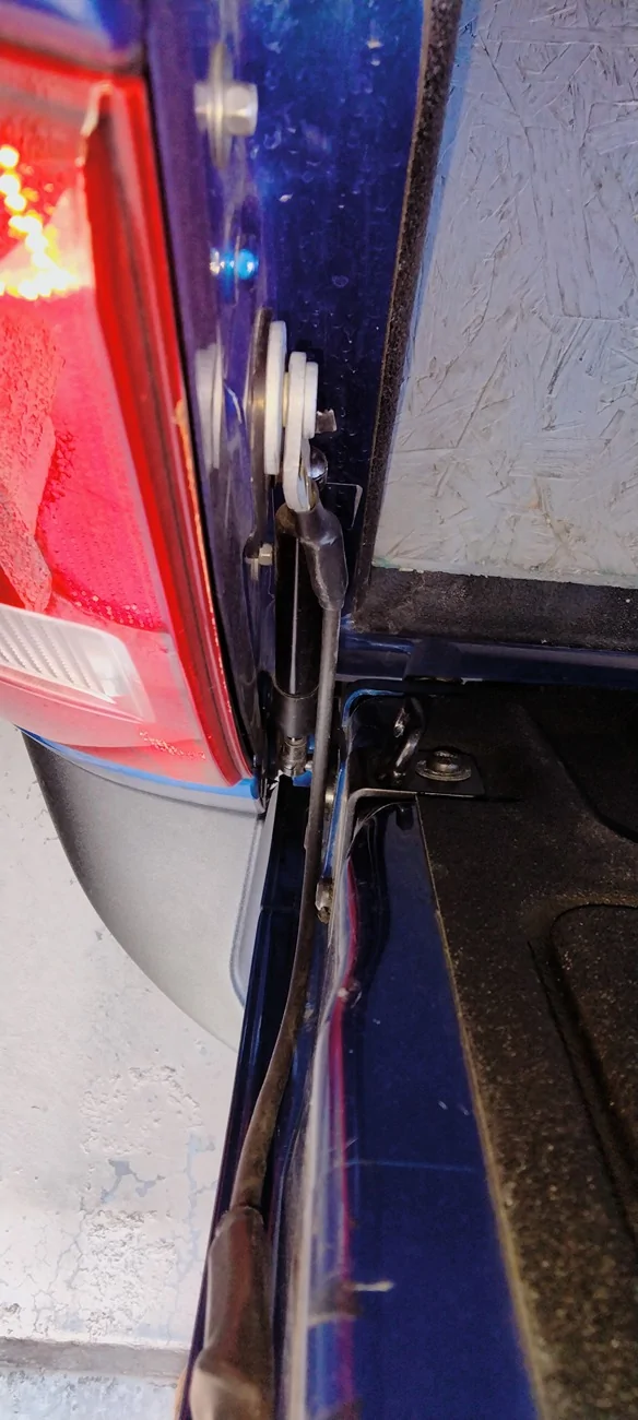

Yes caused by leaving my tailgate down going over rough roads with my Catrike.
Ford Maverick Tailgate Assist Strut - Binding with the tailgate cable 20260208_131740

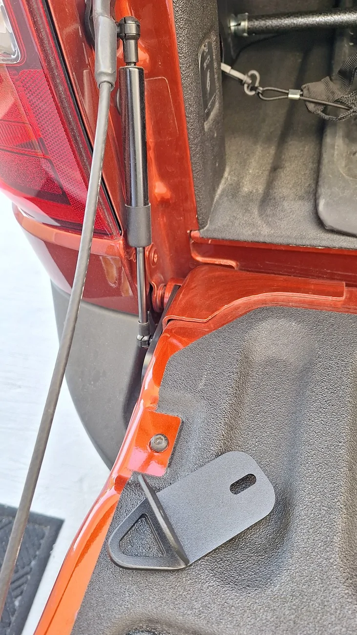

I installed a tailgate assist strut, following the instruction video - but the tailgate cable binds on opening and closing. Did I do something wrong? I considered just removing the cable, but wanted to see if there are others who've had and overcome this issue?
Try this out
https://www.etsy.com/listing/1817791225/tailgate-cable-guide-for-ford-maverick
It works great!
Ford Maverick Tailgate Assist Strut - Binding with the tailgate cable 20250104_112844
Ford Maverick Tailgate Assist Strut - Binding with the tailgate cable 20250104_112739

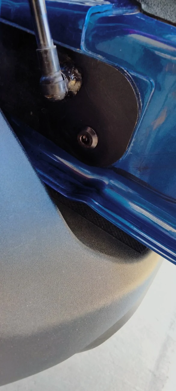

Anyone have issues with the Tailgate Cable Guide deforming? It was great new but now it pops off the the strut all the time.
Ford Maverick Tailgate Assist Strut - Binding with the tailgate cable IMG_20260610_114032
Ford Maverick Tailgate Assist Strut - Binding with the tailgate cable IMG_20260610_114025
Ford Maverick Tailgate Assist Strut - Binding with the tailgate cable IMG_20260610_114006
