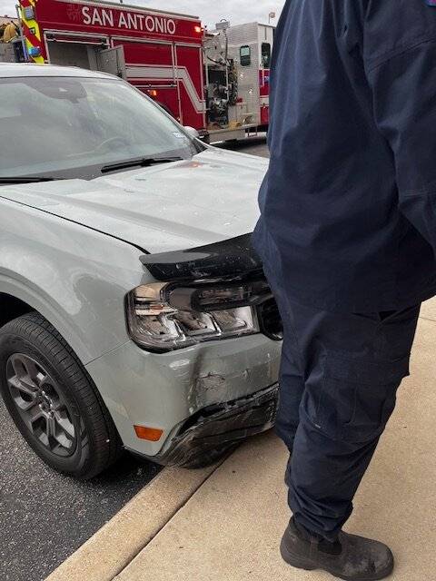

With the information provided (and zero follow up from OP) - mainly the pictures of the scene - that is roughly an 8 inch curb that the Maverick "jumped". That is about 3 inches higher than your standard parking block that is also angled and would allow the wheel to roll up it.
Put your Maverick in drive and let your foot off the brake and your Maverick will not jump the parking block, let alone a square 8" curb.
The other piece for me is that you see a SAFD pumper truck parked perpendicular to the Maverick which indicates that OP was not parked in front of the building but crossed a two-way lane in the parking lot he was in.

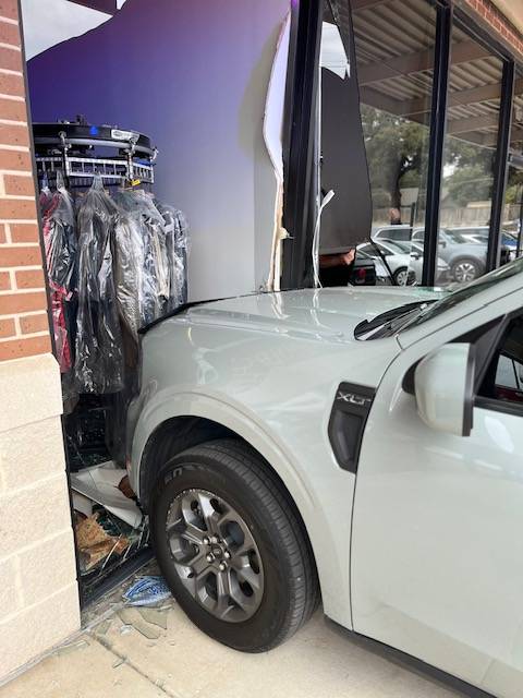

I was not going very fast but when I stepped on the brake the pedal went to the floor and suddenly the truck jumped the curb.
This is the description that really reinforces the accelerator being pressed.
Pushing the brake pedal all the way to the floor would not cause the Maverick to "suddenly jump" the curb.
But pressing the accelerator sure would.
This was probably also compounded by the fact he was likely in Electric only mode and the engine did not make an immediate sound when receiving throttle input. The MG1 provided enough torque to pop the truck up over the curb and into the building.

This past Friday my wife and I were going to dinner and when I was parking the truck in front of the bistro where we planned on having dinner with friends the brakes suddenly failed as I was parking. I was not going very fast but when I stepped on the brake the pedal went to the floor and suddenly the truck jumped the curb. I was pumping the brakes as fast as I could and I think on the 3rd pump the brakes engaged but it was too late we had run into the store front damaging the truck and the store front of two businesses.
After the police and half of the FD showed up we determined the truck was drivable and since I only live about 5 miles from the bistro we decided to just drive home slowly. About half way home I had to make a left turn and when I was slowing down the brakes did the same thing again and again on the 3d or 4th pump the truck stopped with what I would call a hard stop and a grabbing sound in the brakes.
