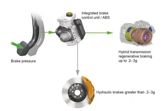

With all the left field comments here I would like to suggest to Randy that your problem is somewhere in your Brake Control Module, connections or software. It definitely should be looked after by the dealership. Ford Mavericks are well known for grabby braking at slow speed and has been issued a couple repair software tickets by Ford. Below is some information I copied for you.

"In a Ford Maverick, the "brake-by-wire" system works by using a sensor to monitor how much pressure is applied to the brake pedal, then sending that information to a control unit which electronically determines the necessary braking force, activating the brakes through an electric pump that generates hydraulic pressure to slow the vehicle down; essentially replacing a traditional mechanical linkage with an electronic signal to control braking power."
"Key points about the Ford Maverick brake-by-wire system:
Sensor on the pedal: A sensor on the brake pedal measures how far it is pressed down.
Control unit: This unit receives the signal from the sensor and calculates the required braking force based on driving conditions.
Electric pump: The control unit activates an electric pump which generates hydraulic pressure to apply the brakes."
PS: Don't drive the vehicle again after the brakes fail, it might not end well for you!
this is technically possible but it does not explain why he didn't have issues coming home, or why the pedal went to the floor, or why a maverick idling can't get over a curb.
pushing the gas by mistake does explain all 3 of those. human errors are much easier understood and forgiven than mechanical systems and the software that controls them.
so, let's say you're betting your next paycheck. where are you putting that money?
