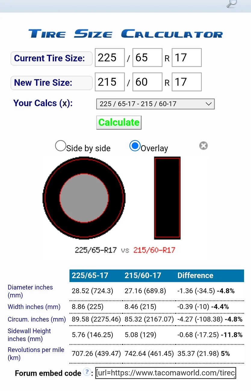

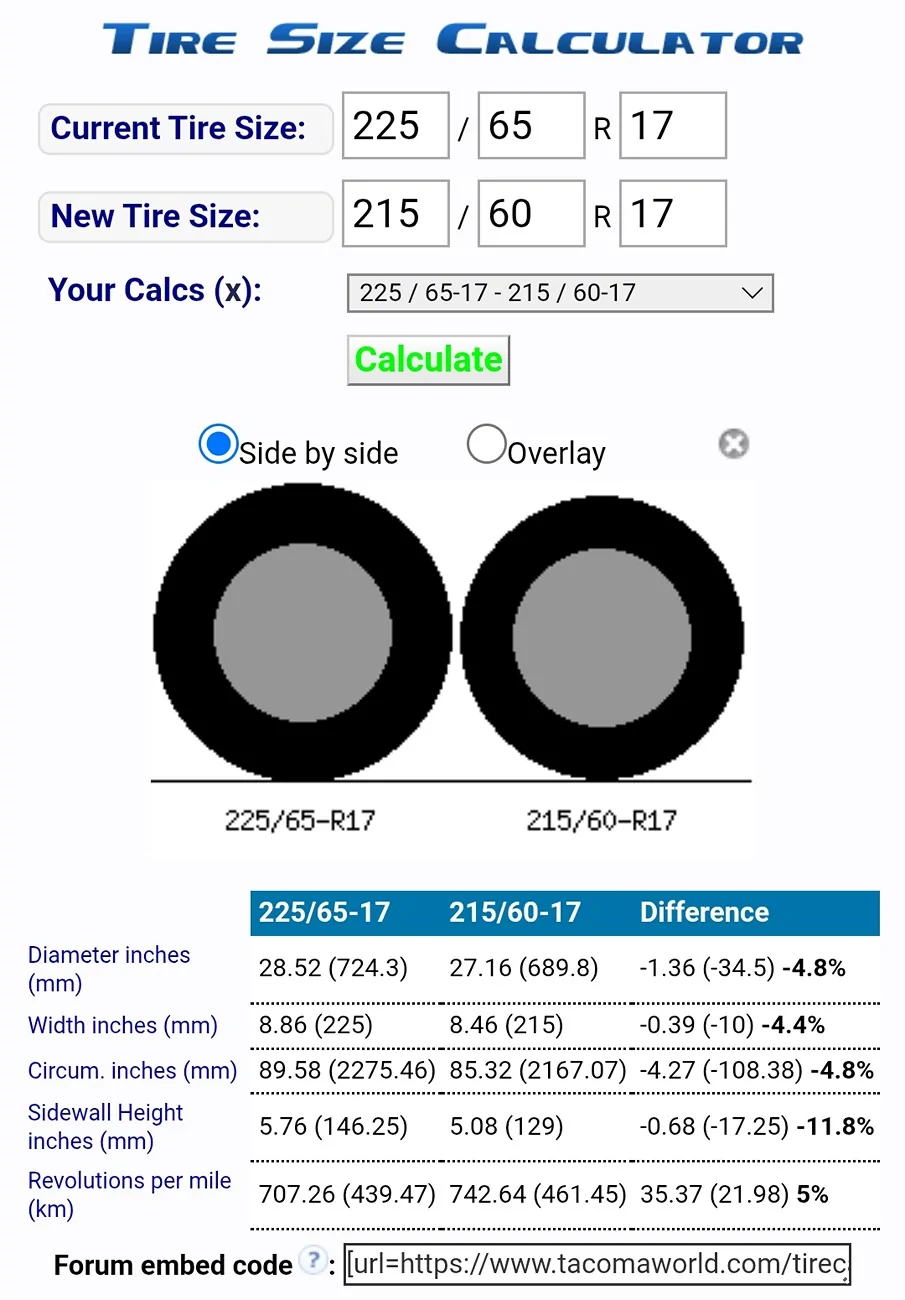

2022 hybrids came with a full size spare. My XLT spare came from the factory mounted i
on an XL silver steelie, the tire is slightly smaller in diameter being 215/60-17 with my stock tires being 225/65-17.
Yep, my 2023 came with the same size tire.
I refer to it as a full service spare. Full load rating, full speed, rating and full treadware.
Our spare tires come with a H speed rating and treadwear mark of 440.
Because of the size difference. I would not do 80 miles an hour with this spare on my truck.
A treadwear rating of 440 means a tire is expected to last 4.4 times longer than a baseline reference tire graded at 100 during a controlled government test. As a general rule of thumb noted by Reddit users, you can add two zeros to estimate potential mileage, meaning a 440 rating roughly points to around 44,000 miles of expected wear under ideal conditions.

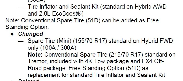

I was just noticing that it seems everywhere Ford has mentioned this "full size / conventional" spare it is marketed as 215/70R17.
However, the spare I have is 215/60R17 and that makes it quite a bit shorter than the 225/55R19 tires that came standard. Seems pretty bogus and we should have been getting 215/70's ?
However, the spare I have is 215/60R17 and that makes it quite a bit shorter than the 225/55T19 tires that came standard. Seems pretty bogus and we should have been getting 215/70's ?
That typo has been on the site & Order Guide for at least a couple of years now.

I'm thinking 215/65R17 would be the perfect size. About 10-20mm smaller to start, and the more worn your main tires are, the closer they will get to the spare's diameter.
