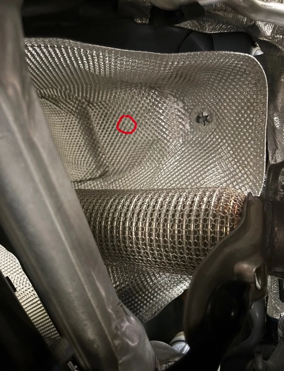

I just drilled a 1” hole right about here, so I can access it with ease now. My cabin filter was dry though.
