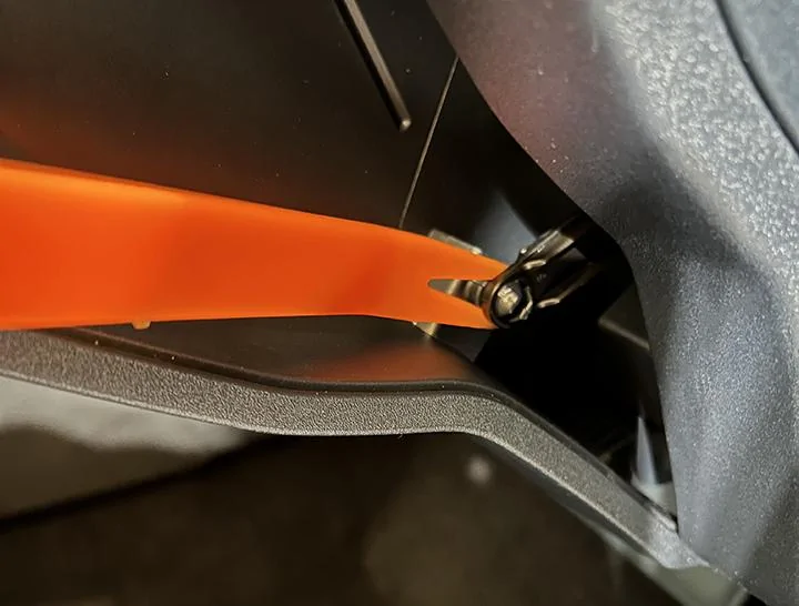

1. Open glovebox and empty the contents. On the right side is the damping lever. Using a trim tool as shown works best as it makes it easy to separate the lever from the mounting post. Push the tool in a little and twist to pry the lever outwards.
Ford Maverick How-to DIY: change the cabin air filter c1

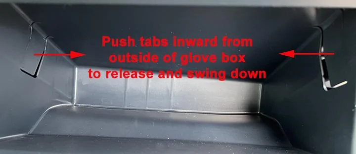

2. From the outside of the glovebox, push the tabs inward at the same time and rotate glovebox downward. You can now easily lift the glovebox up from its hinges and totally remove it.
Ford Maverick How-to DIY: change the cabin air filter c2

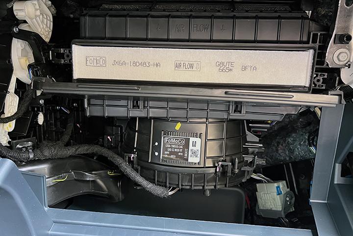

3. There is a (cheap) plastic lock tab on each side of the cabin filter housing. CAREFULLY push each tab outwards to release the cabin filter door. The door is attached at the bottom with plastic hinges. Grab the tabs on the top and rotate the door downwards.
Ford Maverick How-to DIY: change the cabin air filter c5
4. Remove the old cabin filter by grabbing the edges and pulling it straight out.
Ford Maverick How-to DIY: change the cabin air filter c4

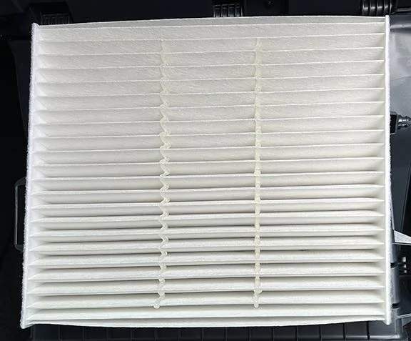

This is what the filter looks like:
Ford Maverick How-to DIY: change the cabin air filter c3

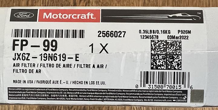

The Ford part number is: JX6Z-19N619-E. The OEM filter is made in the USA. MSRP is $29.95.
"FP-99" is also used to describe/verify the correct filter.
Ford Maverick How-to DIY: change the cabin air filter c6

Nice writeup! Just a note: I just pulled the lever in step 1 with my hands and no tool. It's probably safer to use the tool like you mentioned, though...

I tried removing the lever by hand but mine was really on there tight. Agree, the Maverick filter is easy, some vehicles as you noted can be quite involved. Cabin filter installation can be a very high profit center for dealers. I have heard of people being charged $100-$200 - and that's for easy ones to change!!

The OEM filter listed by the OP above is $18.94 at Fairway Ford Parts. They do take FordPass Rewards but have to call or email them.
