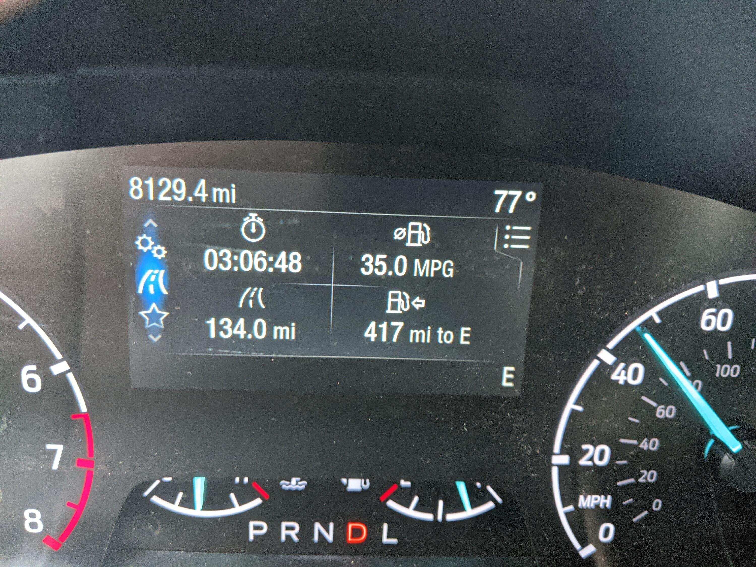

Yeah truck computer shows a bit more than the actual mileage, when calculated by hand. I have about 3500 miles on the truck and have NEVER calculated more than 32MPG
