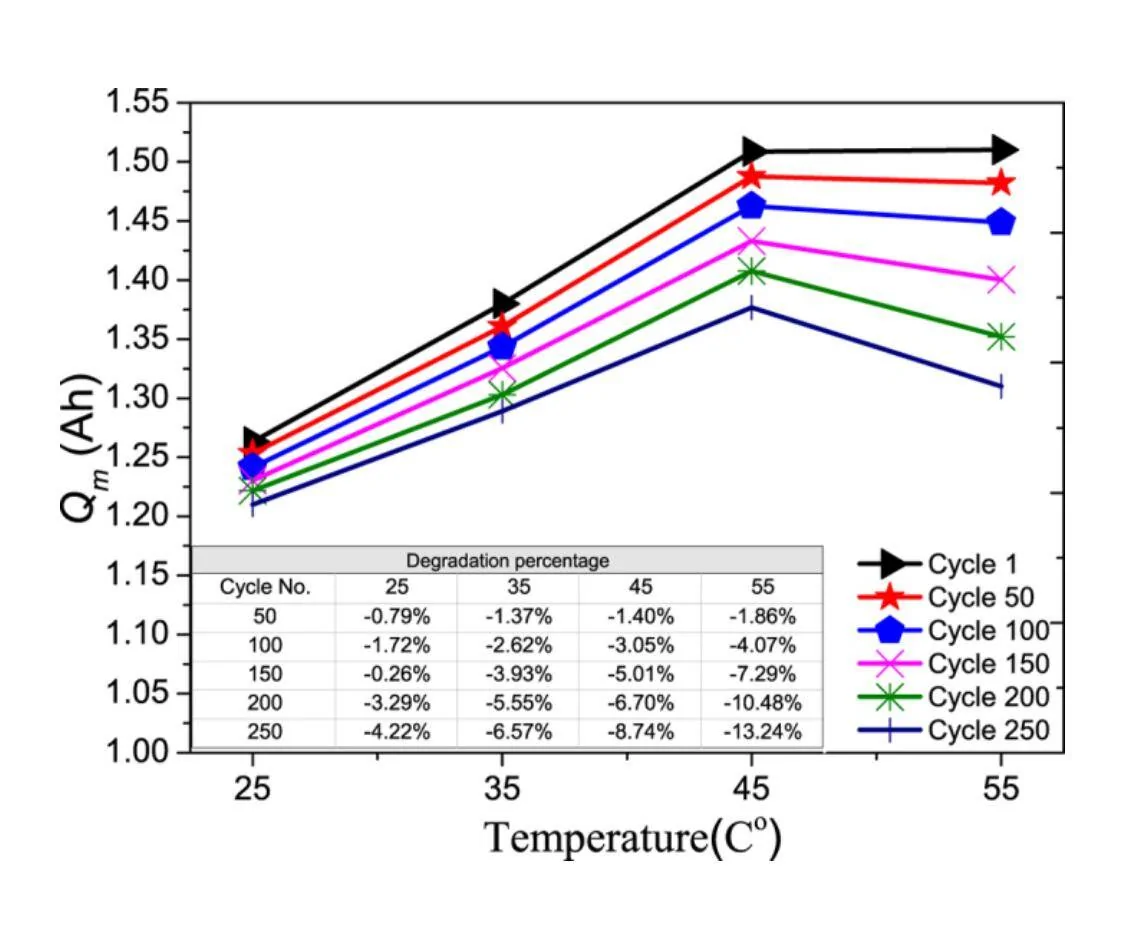

Wattage output goes UP with temperature rise. But, high temperatures degrade the longevity.
For an Electric Drag Race where the prize money comes in seconds, I have read they heat the batteries to like 140°F just before the race.
Here is a decent chart. Sorry it is small.
Ford Maverick Better hybrid performance in really hot weather- 1726632948772-h7
Snip from a Tesla group:
"The batteries want to be fairly warm for max power discharge and that's why the Model S will actually heat the battery when you turn on Ludicrous mode."

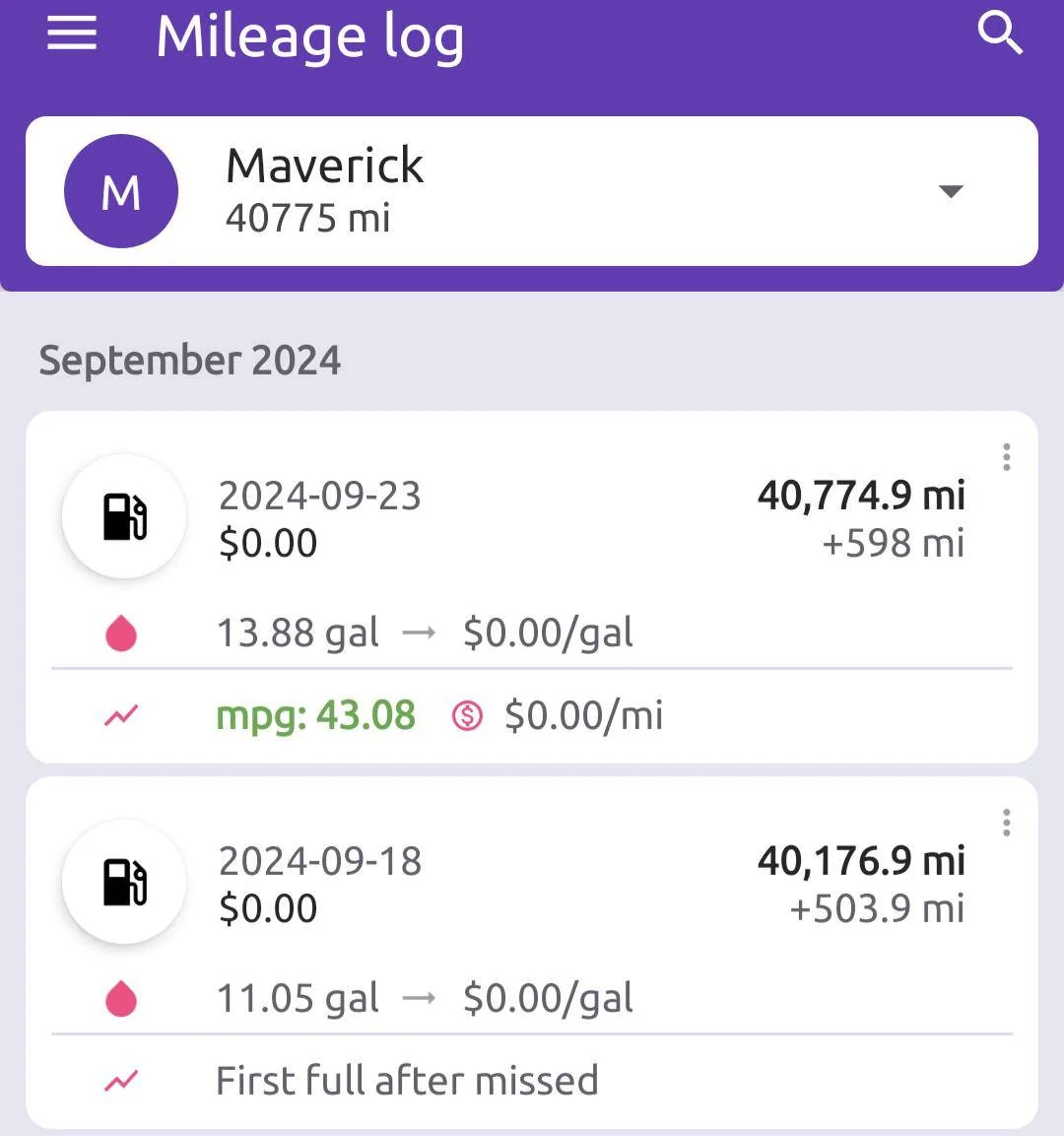

I checked my mpg...
Ford Maverick Better hybrid performance in really hot weather- Screenshot_20240924-161544
Still having high temperatures around 100, and up-
