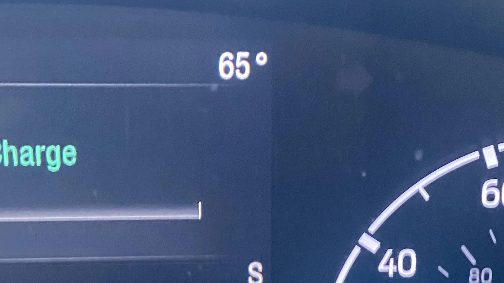

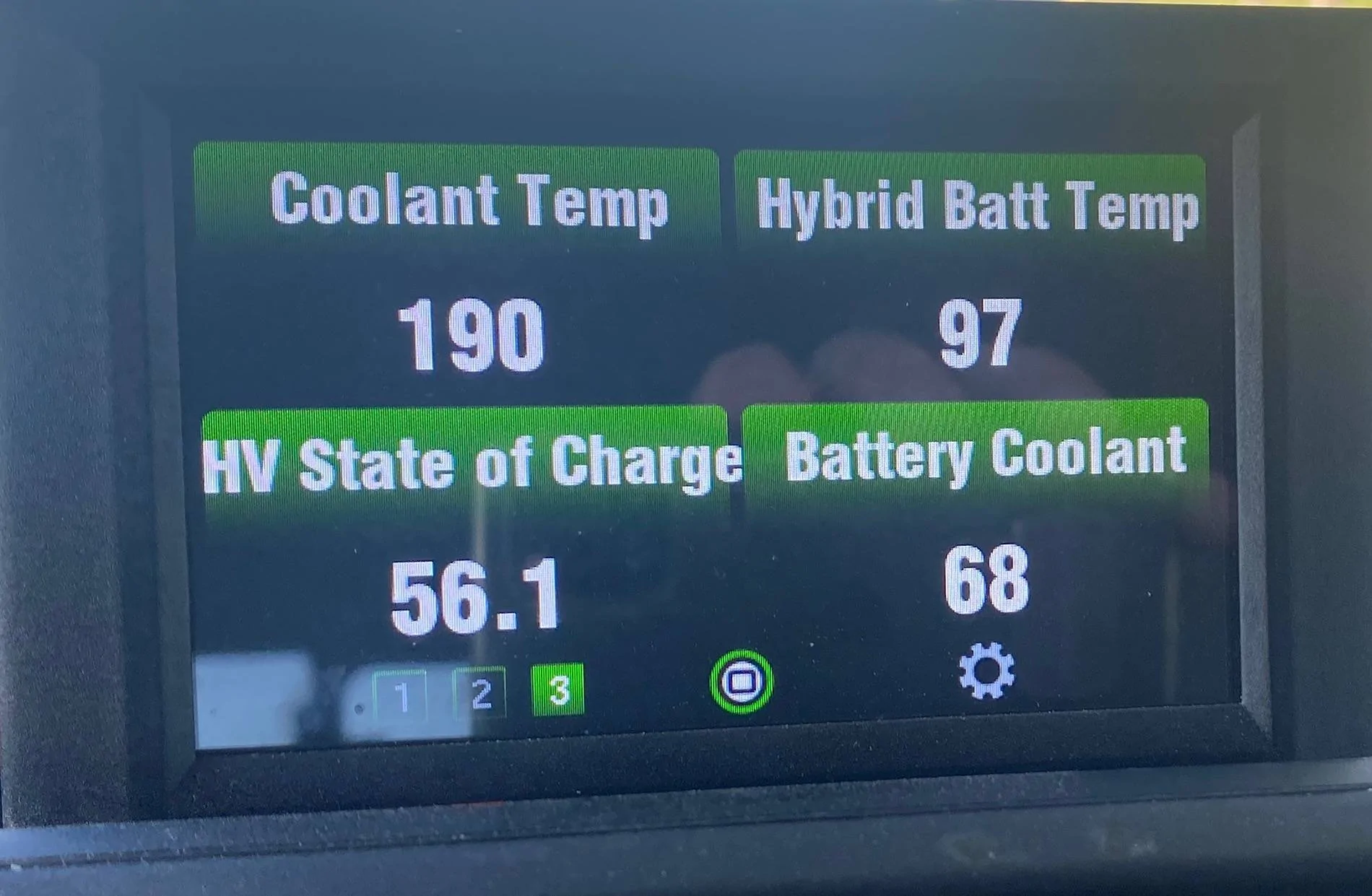

Here is today. 20 minutes into a morning commute after a cold soak all night at under 65 degrees. 65°F at time of the photos.
Ford Maverick Better hybrid performance in really hot weather- IMG_1395
Ford Maverick Better hybrid performance in really hot weather- IMG_1394
The internal HV battery temperature is already 97°F after 20 minutes & 10 miles on a mild 65 degree morning. Battery coolant is basically ambient.
