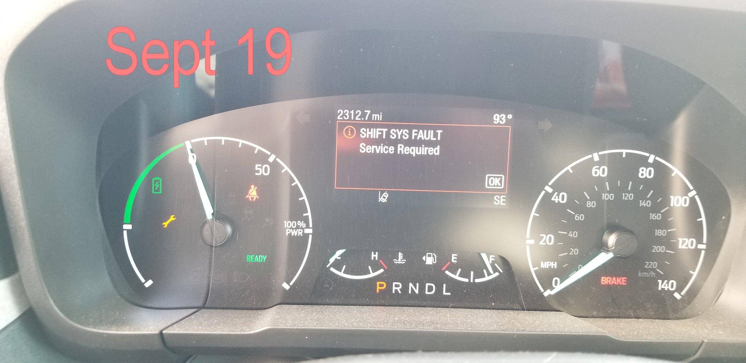

I feel my Hybrid has the same issue as OP. Mind you I'm 67 now and my Regen braking is anywhere from 85 to 100. My last gas tank was 28.9 MPG (mileage divided by gallons) and I've been getting 20 MPG in town. Seems to do better with the a/c off and that might be a clue. Of course my Cyber Orange Hybrid is in the shop for the 3rd time for a "Shift SYS Fault" that immobilizes the truck which has happened at least 10 times now. It is looking more like a Lemon than Cyber Orange with only 2,313 miles.

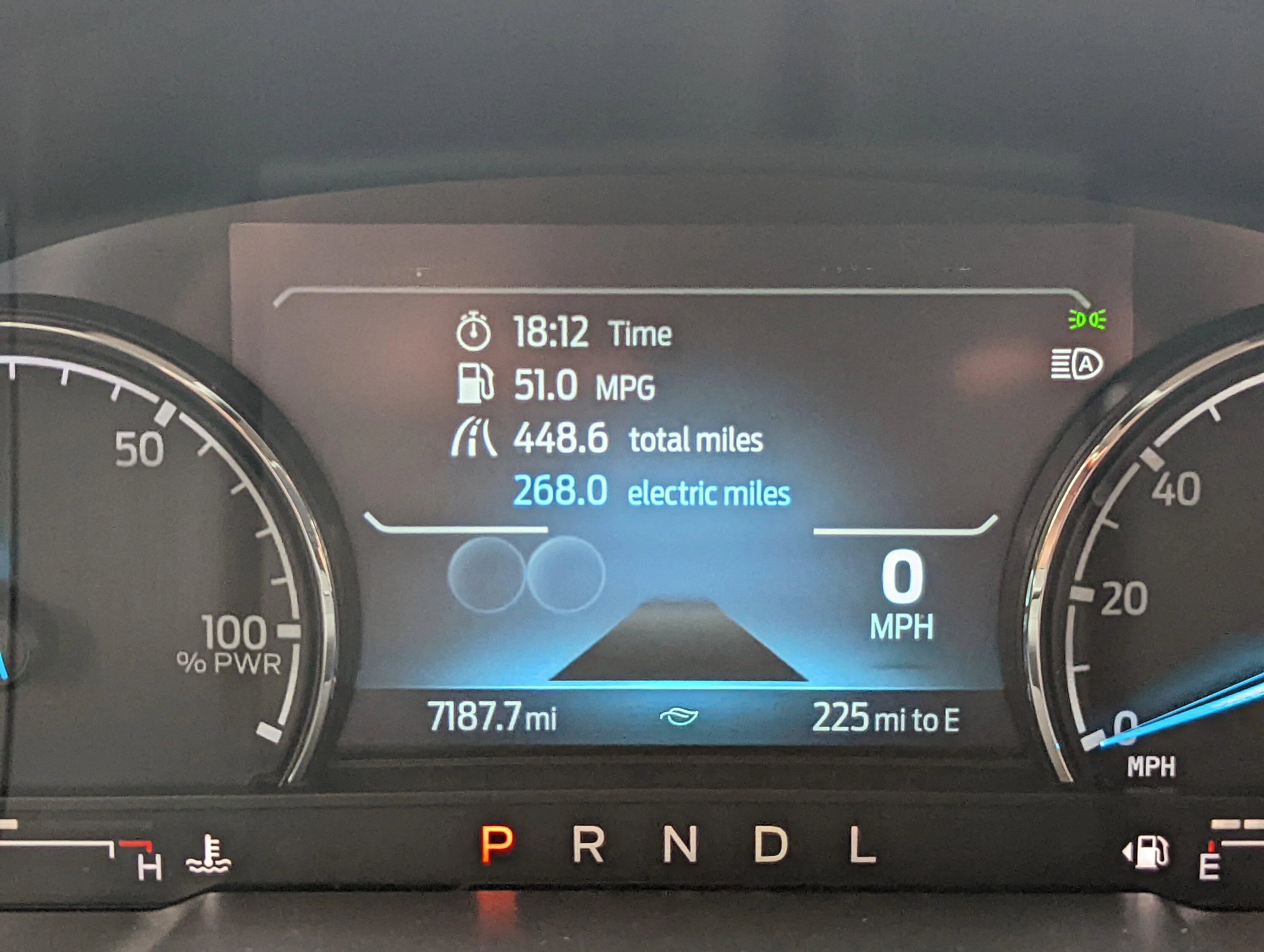

Something's not right though, I'm on my best tank so far with mostly city.

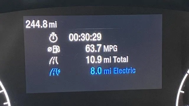

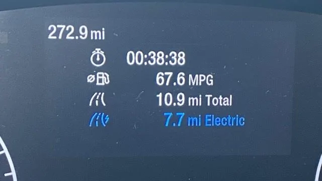

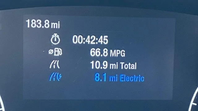

I'm babying mine and gonna get 800 miles per tank. What am I doing that is counter productive?
Ford Maverick Really bad in-city mileage. FB08C750-B8FB-46D2-8007-B0D426BB988D
Ford Maverick Really bad in-city mileage. 0A0DCBA7-9D09-4AB4-A8D5-23B9C078602E
Ford Maverick Really bad in-city mileage. A2FA2D7E-B9A7-4342-BACB-FB5F40C18339
These are not flukes. These are every day commutes in flat, sea-level city driving.
