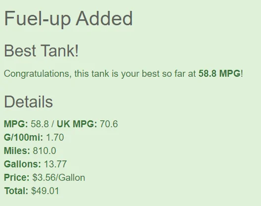

I'm thinking it's driver error, There are plenty of YouTube videos on how to drive the Maverick Hybrid and get good MPG.
This is my last fill-up.
