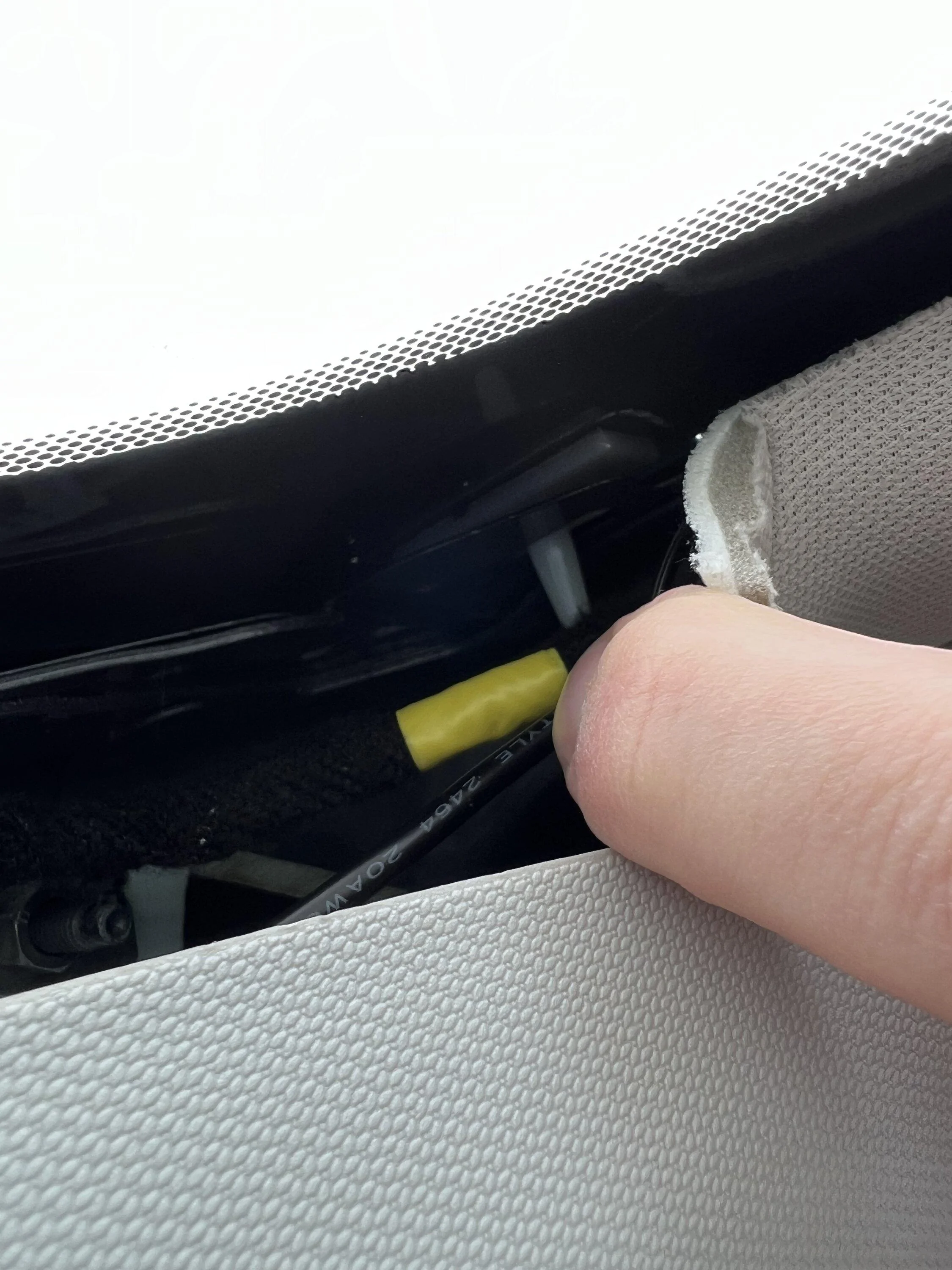

Alright, after going half crazy from the squeak and all the helpful info in this thread, I decided to give it a go to remove one of these pegs. My creak seemed like it was coming from the right side. I removed the A Pillar. It’s really easy by squeezing the pillar itself at the top and bottom and pulling up. It’ll still be connected at the bottom by the tweeter grill most likely. That’s fine, just leave it hanging there. Next, pull the corner of the headliner down and you’ll see this:

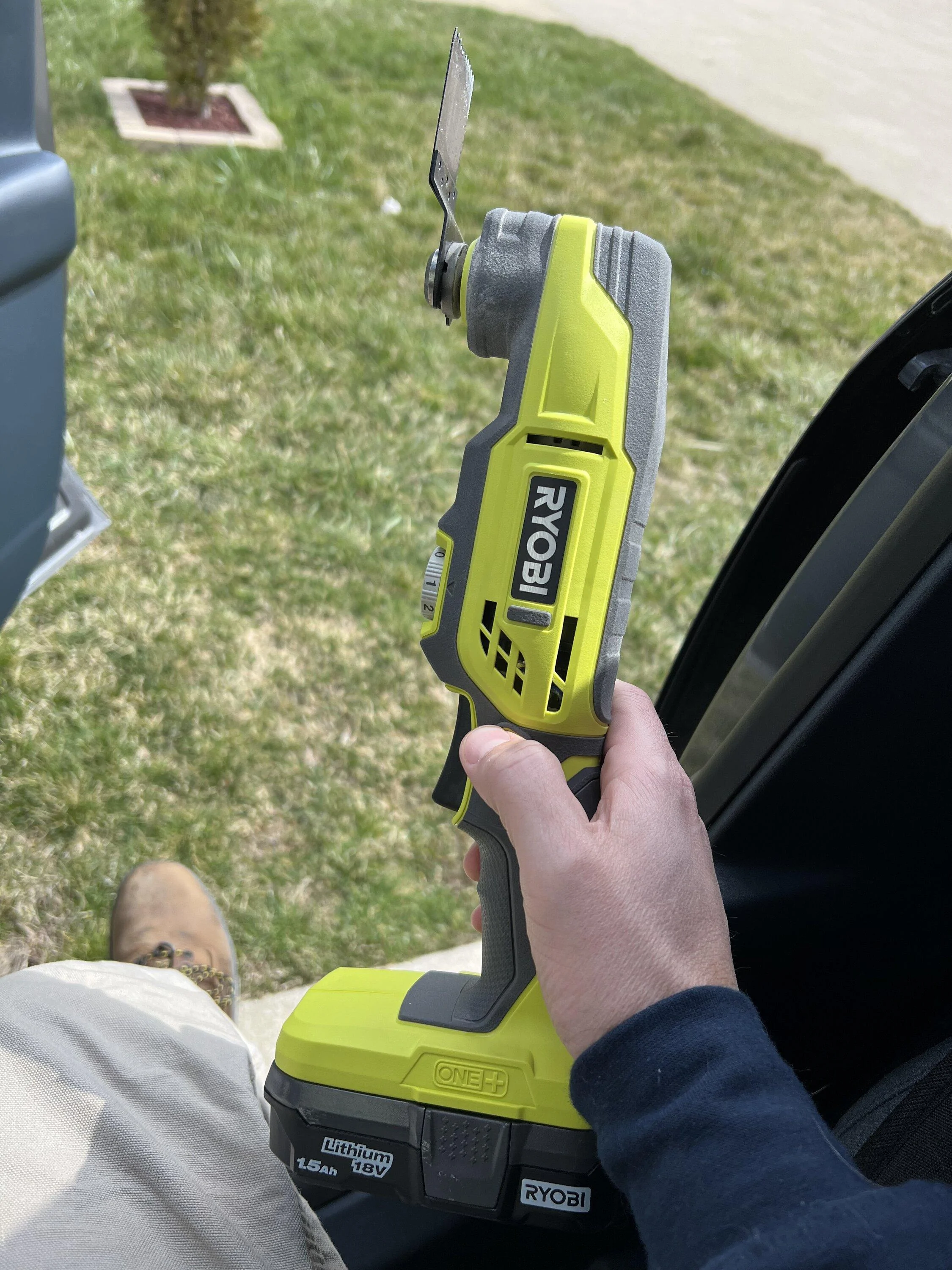

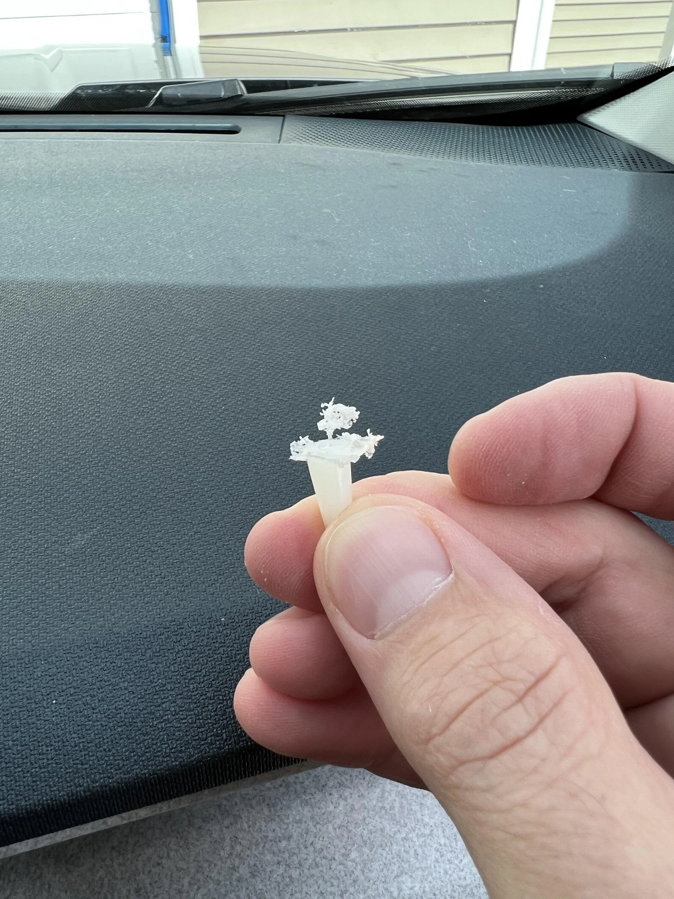

That white post is the squeaky wheel. It goes through a very thin piece of sheet metal. I actually pried the sheet metal down rather easily with a flathead screwdriver. I don’t believe it’s for anything other than aligning the windshield. I used an oscillating saw to cut it off between the sheet metal tab and the flat plastic base of this peg. There’s not much room but just take your time.

This appears to have stopped by rattle and creak. I should say that if you’re not comfortable doing this, have your dealer check it out.
