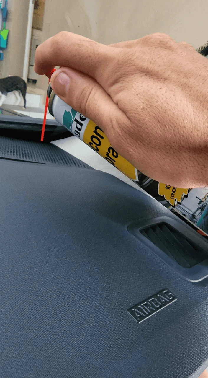

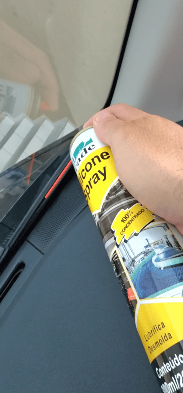

Finnaly got it fixed. Tried everything before including disassembling the dash, colums and other parts... Just put some silicone spray between the dash ans windshield, from one colum to the other. The clicking is gone! Hope you can fix with this tip too! Cheers!
